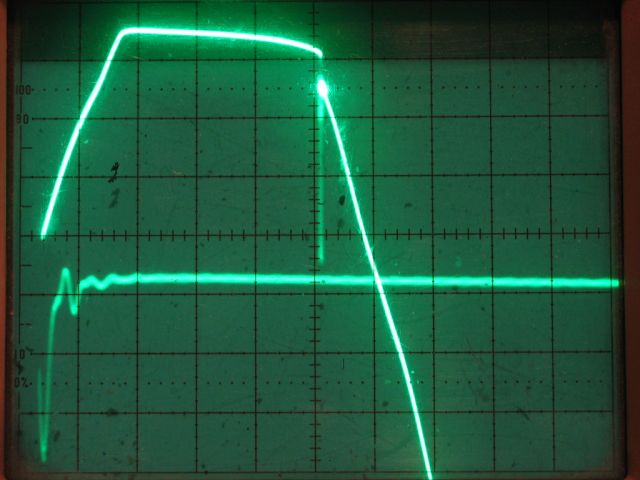

Hi all!

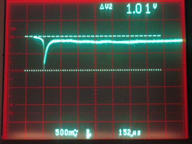

Excuse me, if I talk too much, but I have felt the need to complete the previous tests.
Here it is the same [~] setup with MUR860. The transformer, capacitor, load is the same. The reverse recovery "snap" with this rectifier is much less, but not inexistent.
Konnichiwa,
Am I interpreting the display right and is the MUR860 recovery snap a single well damped spike of shorter duration and around 20db less amplitude as that with conventional rectifiers?
If so this has at least the potential to make an audible difference, IMHO.
Also, again me badgering you to do my own work, sorry for that, could you try out some standard rectifiers vs schottky diodes tests?
Thanks to your excellent work this thread has already been hugely illuminating and educating, more please....
Sayonara

here it is the same thing again, with a larger time scale. Here I resolved the problem of the "sniffer", it is sniffing really now [a HP filter]. It permits to see better the things going on. What you see is that at the "plateau" phase there is no noise, because the low impedance of the cap is attached, but in between, there is no damping of the input tank circuit, it is free to pick up noise, resonate, etc..

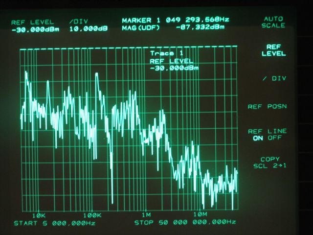

I would like to make it clear, in these test we were not looking at the charge current pulses. We were looking at the ~ 35 V p-p AC sec. voltage, and at the glitches, what the diodes reverse rec. current spike is causing on them.
These glitches are having a quite widespread noise spectrum. I would like to attach here a graph to have the impression. The reference level in this graph is a bit hazy - first, I am sniffing the sec. AC tension, it is shaping this noise in the low region. i did not calculate precisely, but the F3 of the 10nF // 50 ohm setup is in the range of ~ 200 kHz. I must do it, so as not to overload the analyser input. So, it all is only a relative test, to show the spectral distribution.
[of the 11.2 V spikes]

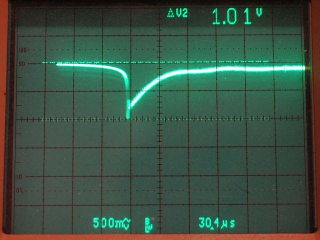

Hi, Thorsten!
Look out, the time scale is different. It seems to be that the MUR has a much smaller, BUT longer snap [~30 usec]
So, it is not a bad thing at all.

And here a pic, the same setup [with the 11.2 V spikes], but the snubber [220nF - 1ohm] across the cap.
It is different, but try too look at it in "averaging mode". That is, for me it is generally the same pic. At each new scan the spectrum is different, but it moves around the ~ same values. In case of real changes, the "mean" values are changing, greatly.

Okay, yes I was wondering. The pictures don't quite make the scales easy to infer.
And yes, I agree that less leve and a longer decay are both good things as it means much less energy higher up, lower Q and of course overall 20db lower peaks.
