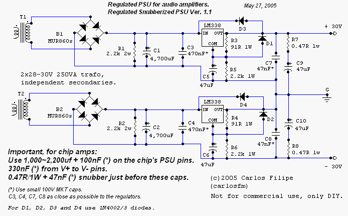

When i use Carlos' Snubber PSU, and i use different main capacitors, for example 22.000 instead of 10.000µF, are the other parts have to be recalculated?
And has anyone ever compared the sound of the regulated snubber PSU to the unregulated snubber PSU?
Wich one sounds better/more natural?

So if I parallel 3 LM338 I don't get 3 times less the output impedance and I don't have to take this in to account when calculating the resistor/cap value?
The values of the cap/resistor are different in the unregulated and regulated supplies. Shouldn't it be the same values?
The schematics I'm using is the one on the pic.
thanks.

I don't know that it's acting as a typical snubber, anyway. It looks more like a way to guarantee at least 0.47 Ohms of ESR for the 47 uF output cap, maybe since the cap's own ESR would drop quickly as frequency increased.
You could either use one snubber per regulator, or one snubber after their parallel outputs have been merged together, or, one per regulator and also one after the outputs have been merged.
If you want to know how snubber component values are calculated, there are several good papers on the web. Just google "snubber design".
If you have a scope and can put some fast-rising square waves into the amp that's being driven by the PSU, you might be able to use the practical method, at:
http://www.diyaudio.com/forums/powe...lm-caps-electrolytic-caps-30.html#post2828689
