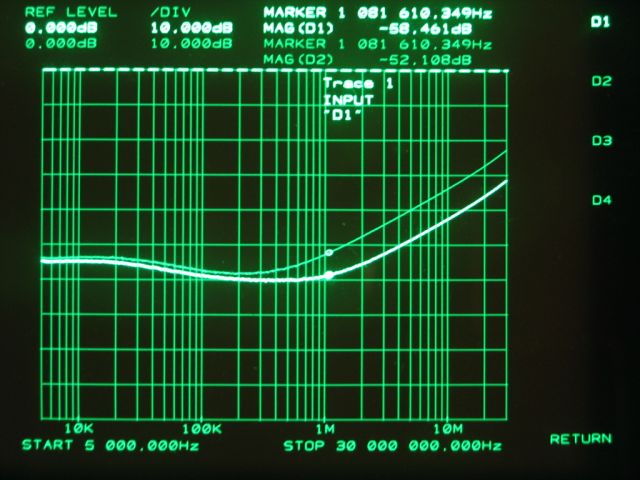

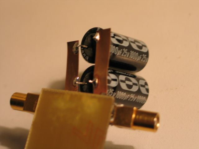

Thorsten, when I said "mirrored capacitors", I wanted to say, in your words, "capacitors end to end". I have been looking at your pic taken earlier, and tried to do the same. May I point you at the photo in
post 432?
There you see the blue caps put "end to end". The results are in post 439.
In that graph, the highlighted trace is the simple parallel config, shown in post 438.
the second trace, which shows actually higher inductance, is the "caps end to end"
Now, it was a strange result, and I felt like I should repeat it.
Here it is an another config:

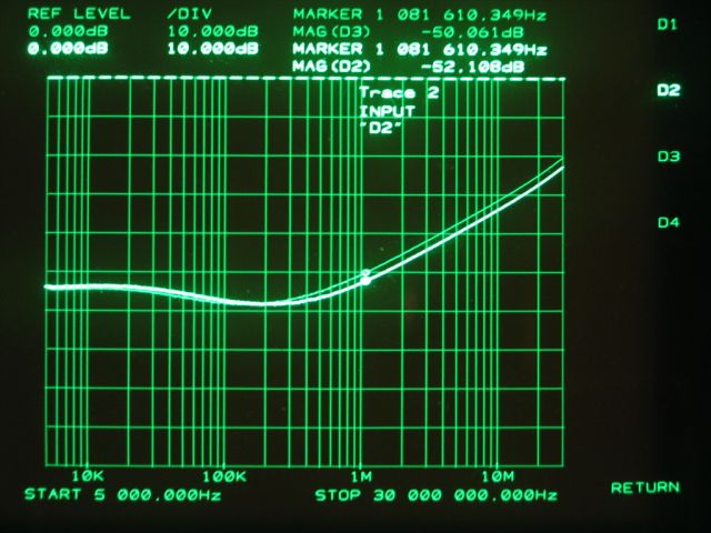

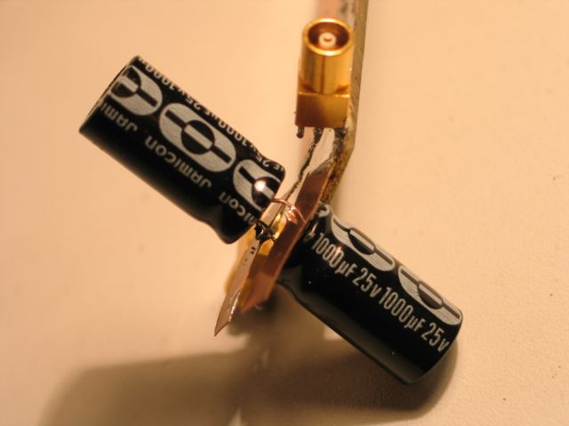

The highlighted trace here is the caps end to end, or "mirrored", the other one is the parallel config. What you see here is a bit better ESL for the "mirror" config, but! The mirror config also means, that now the "bulk" of the caps is closer to the measurement points, covering less loop area. In case of the parallel config, the second cap causes the loop to be more extended. So, I would say, that the only change seen here is because of the loop geometry changing. Though, as you can see, I tried my best to create something with low stray inductances.

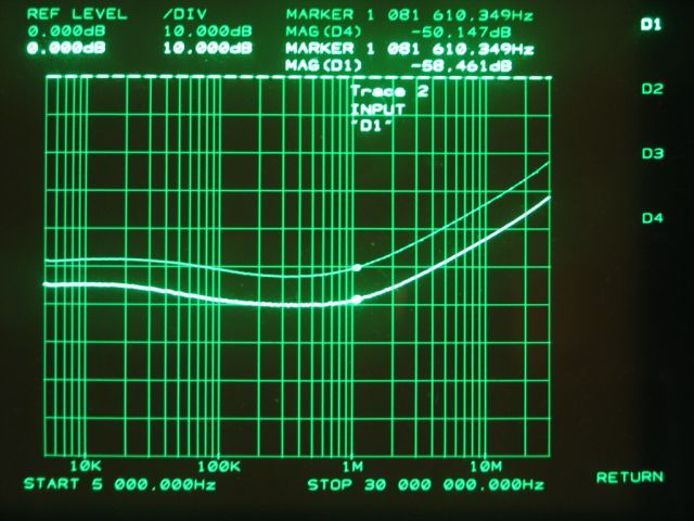

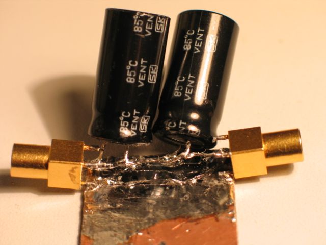

Now, how this all compares to a setup, with caps paralleled in the conventional way, but the shortest leads possible?
Here is the result of comparing the previus test setup with "mirrored" capacitors to the classic paralleled in an optimal way:
The selected trace is the parallel, classic, the upper trace is the parallel, mirrored.
What I see here is that some mm of a good, low inductance foil & increased loop area is far more detrimental then the orientation of the caps!

One thing anyway came clear from these tests: The capacitor ESL in itself is nothing compared to the stray inductances in the wiring of an average DIY setup, or even in an "industrial" realization. While, on your last pic, Thorsten, your friend lost some serious money, gained some extra ESL while connecting that combo to the pins 😉
