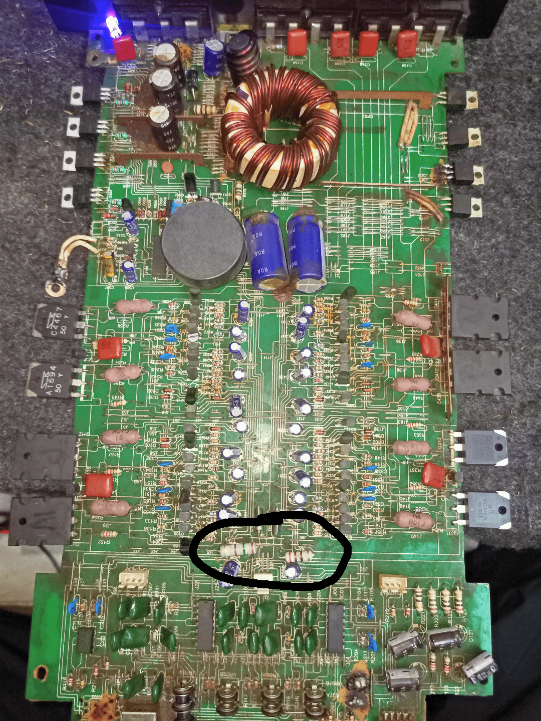

Car Amplifier have power but no sound. Please help me
There are 4 output pins per each 14 pin op-amp. You need to post the pin number and the voltage.
In the Right one :
PINS Voltage
1. 0
2. 0
3. 0
4. +16
5. 0
6. 0
7. 0
8. -13.94
9. -3.40
10. 0
11. -15.75
12. 0
13. -3.37
14. -13.95
MIDDLE ONE:
Pins Voltage
1. -14
2. -6.80
3. -13.88
4. -13.88
5. -13.35
6. -10.94
7. -14
8. -13.32
9. -13.32
10. 0
11. -15.75
12. 0
13. -13.33
14. -13.32
LEFT SMALL ONE:
Pins Voltage
1. -13.12
2. -2.48
3. -11.84
4. -15.78
5. -13.88
6. -13.15
7. -11.95
8. 0

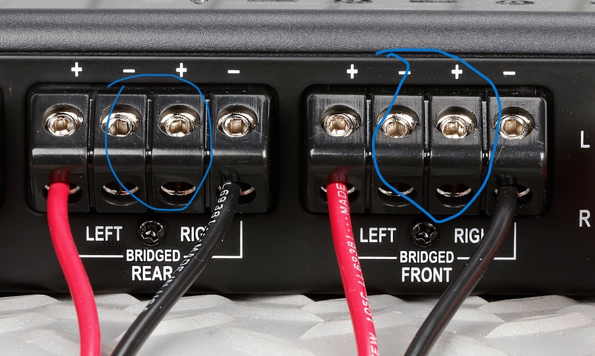

If you got that wrong, all the rest are unreliable. Place the black meter probe on one of the non-bridging speaker terminals and repost the voltages. Do it on the 14 pin op-amp on the right of the photo first. Copy and paste:
Pin 1:
Pin 2:
Pin 3:
Pin 4:
Pin 5:
Pin 6:
Pin 7:
Pin 8:
Pin 9:
Pin 10:
Pin 11:
Pin 12:
Pin 13:
Pin 14:
Please can you clarify what do you mean by non-bridging speaker terminals by using or marking in this photo.

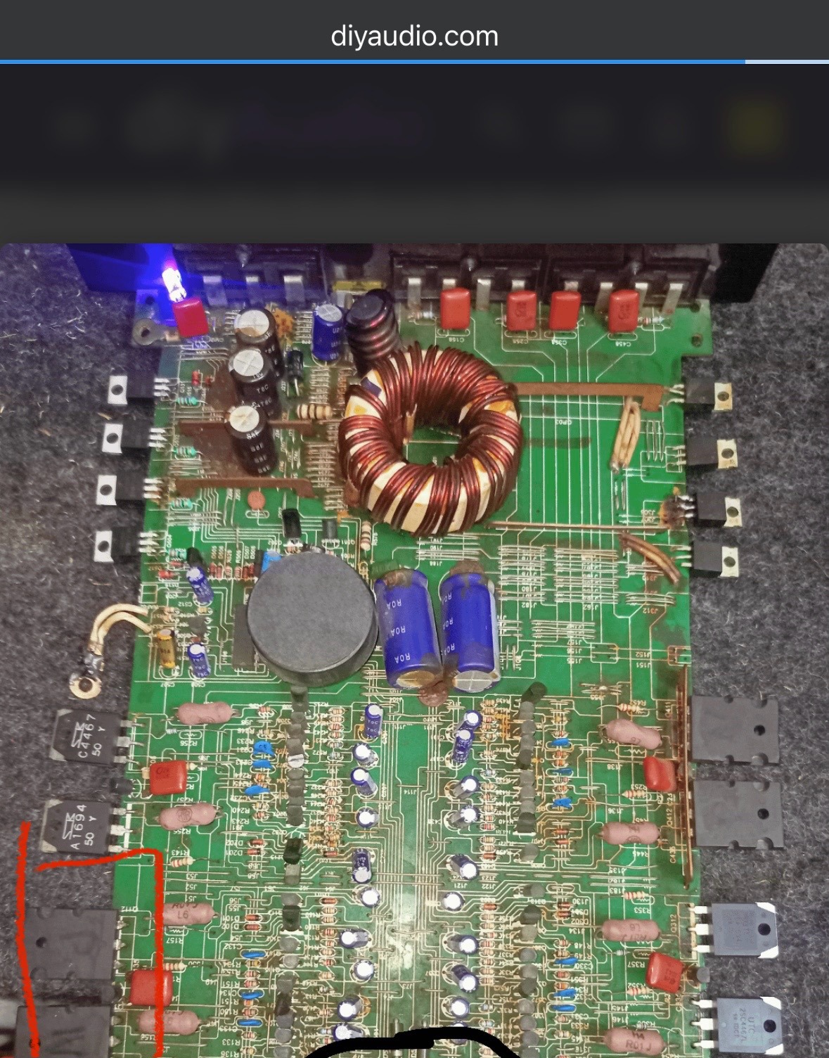

Hello Bro
I am Really Sorry for Leaving this thread in half.
Actually i sent this amp to local repairing shop but unfortunately they also can’t fix it.
Please help me
Problem : left side channel IC mosfet is overheating after just giving the power.
