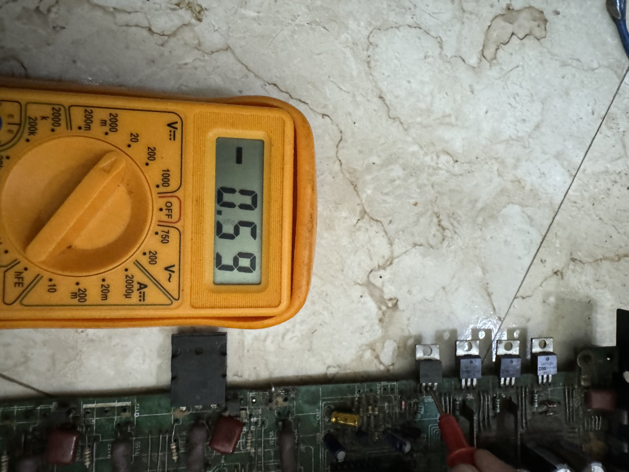

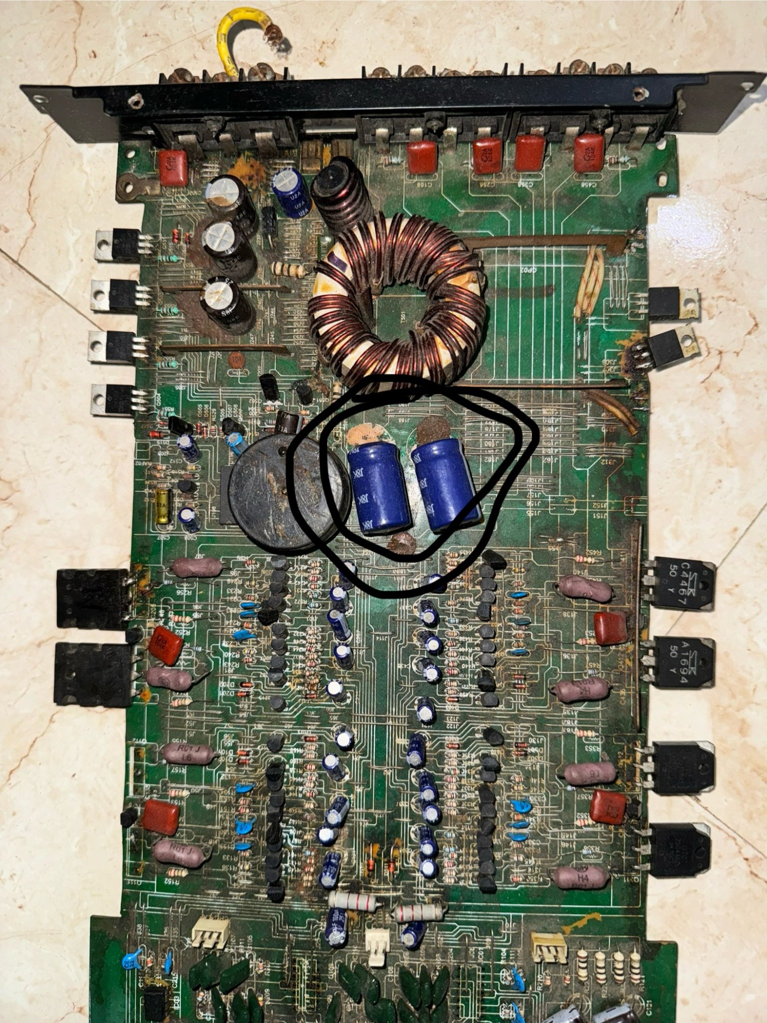

Car Amplifier have power but no sound. Please help me
Brother, new problem came.
There is no Voltage in big Capacitors and i checked everything twice all IC and Mosfet are good.

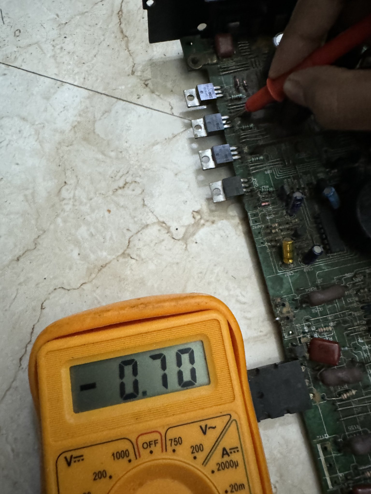

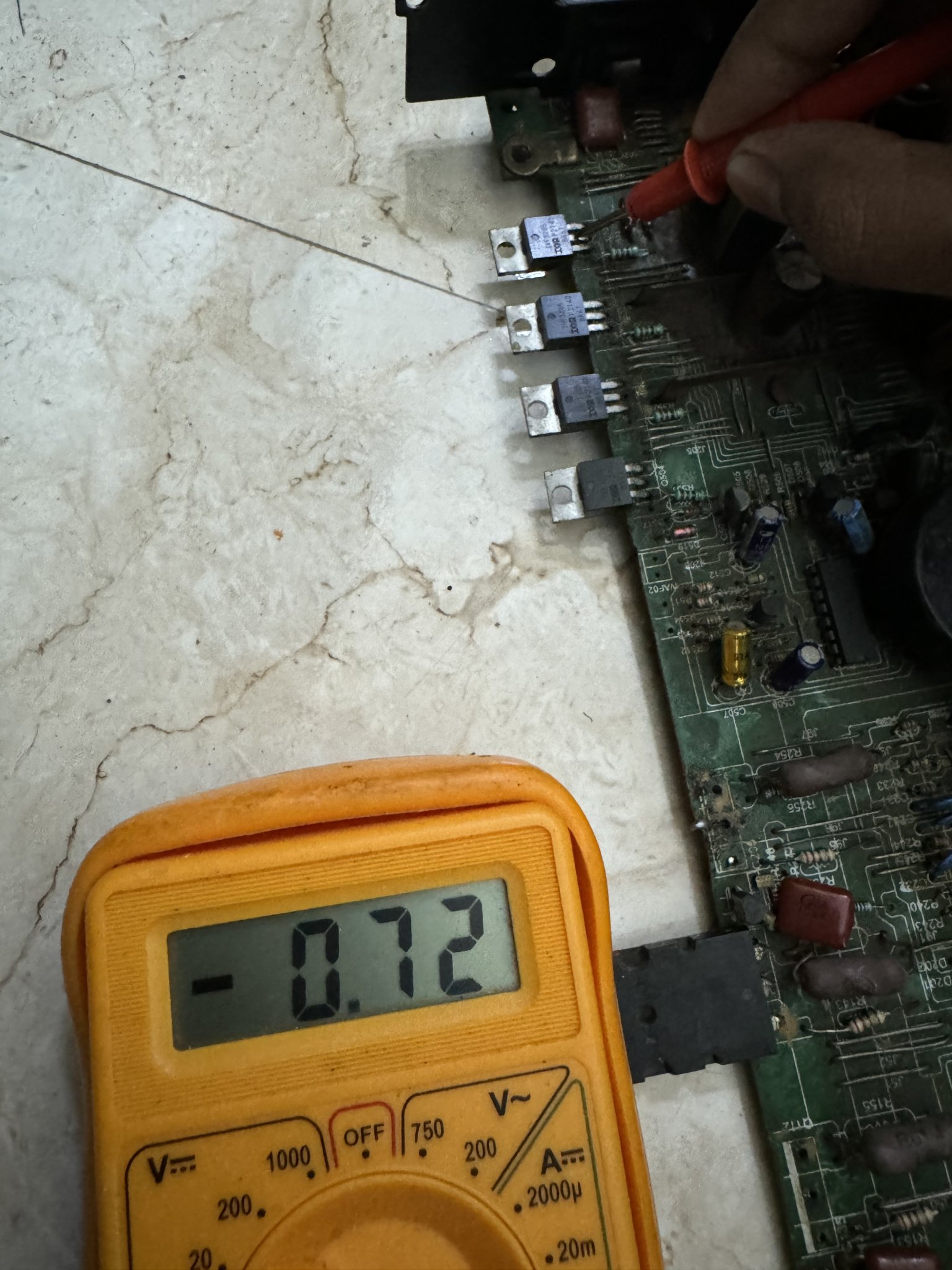

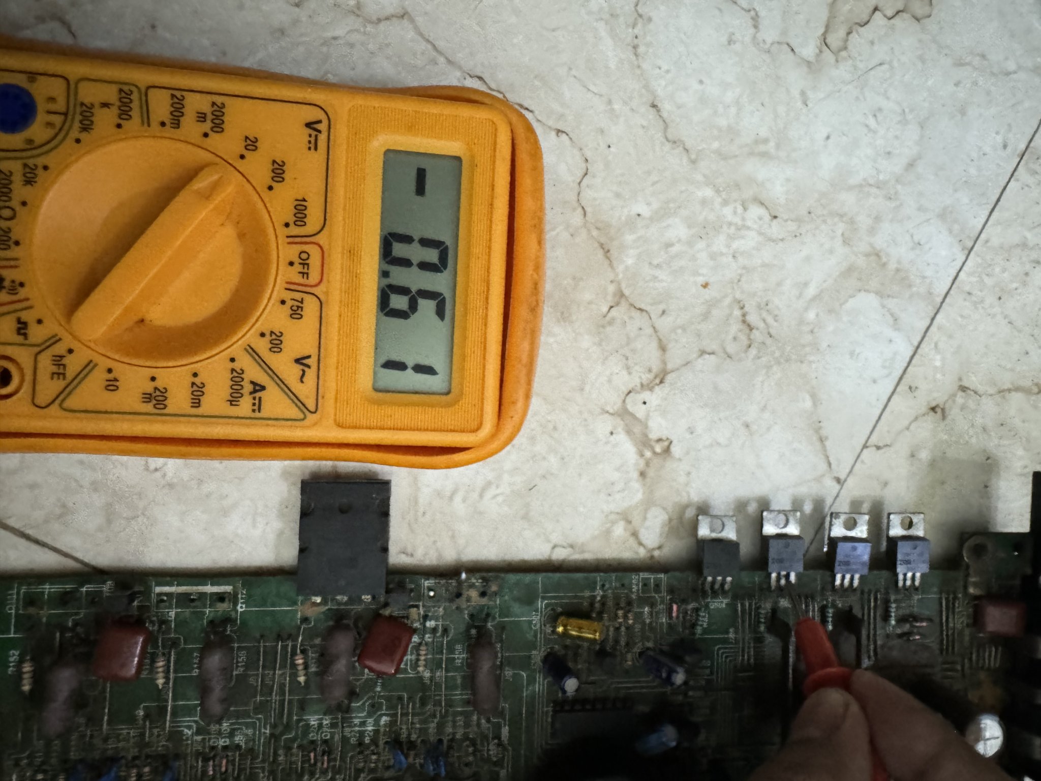

there is no -12 there. Ground is 0v.
The third terminal of the PS FETs is directly connected to the amplifier's ground terminal. How can you have 0,6v?
The center terminal of the PS FETs is connected to the B+ terminal of the amp. Why don't you have 12v on the center terminal?
Are you sure the meter is in good working order?
