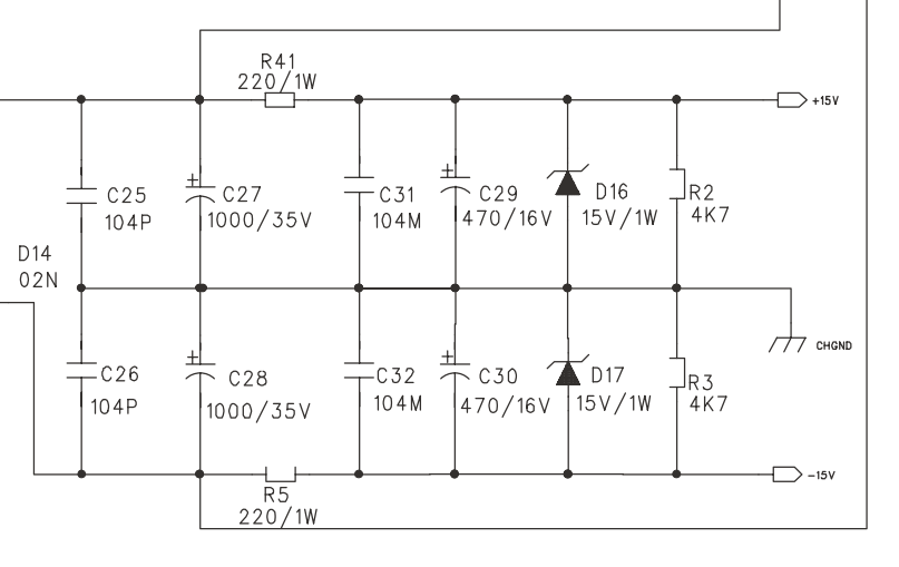

The TVS diodes should not be in there. They are for absorbing transients to protect devices in other types of circuits. 1W zeners are VERY commonly used in this type of circuit.

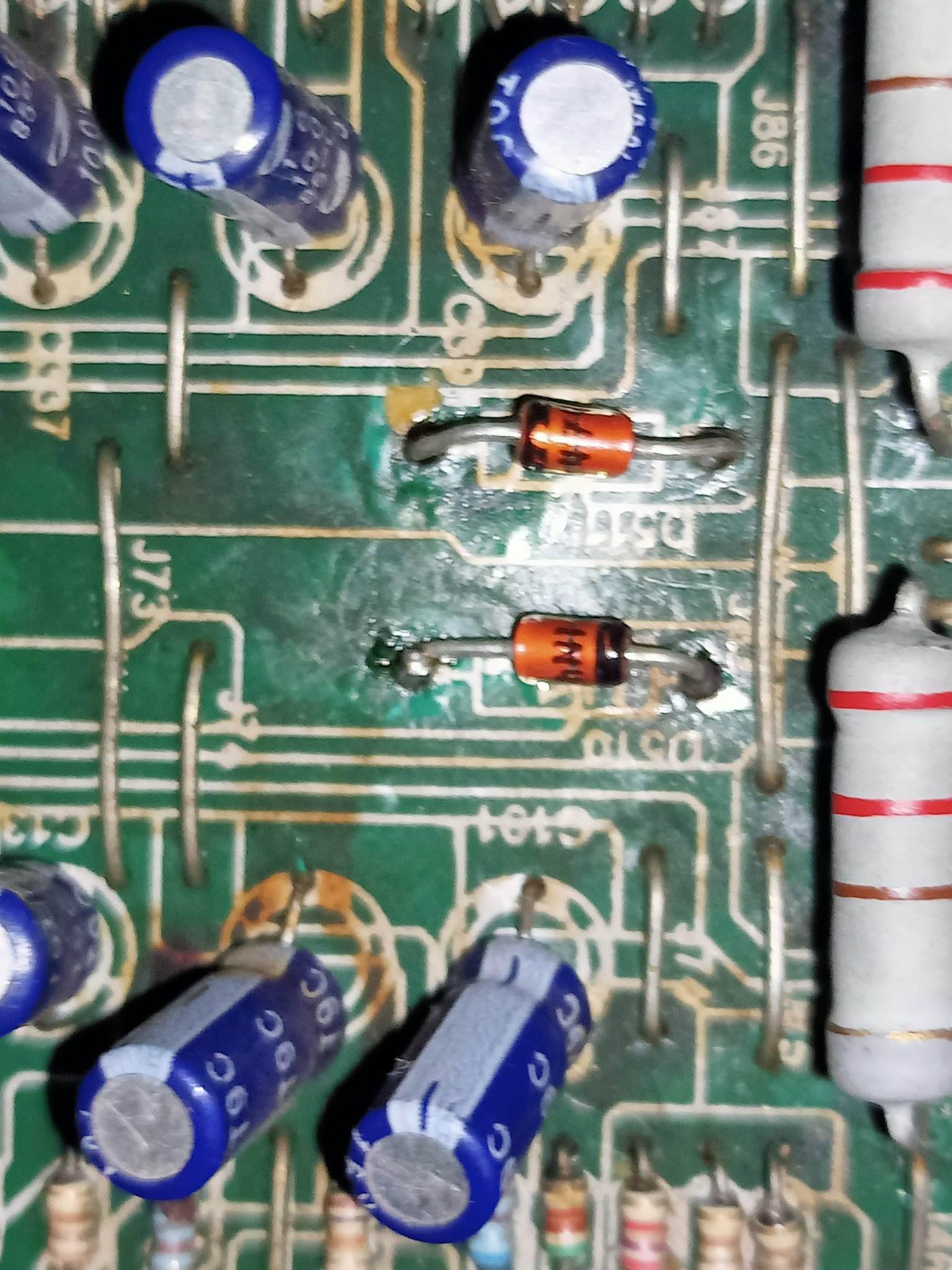

when i measure the voltage of diodes so there is 3.30V in D510 and 0.60V in D511.
and i also measure the voltage of those big resistors so there is 15V in left side Resistor and 19V in right side resistor.
And when it short circuited, spark came out from the left side.
That was already shown (essentially) in the previous answers. The TVS diodes should not be in there.
bro i think that this is not the problem of diode.It is simply telling that the fault is in left side of the amp.That was already shown (essentially) in the previous answers. The TVS diodes should not be in there.
Maybe Yes.Do you believe that one diode is for the left channel and the other is for the right channel?

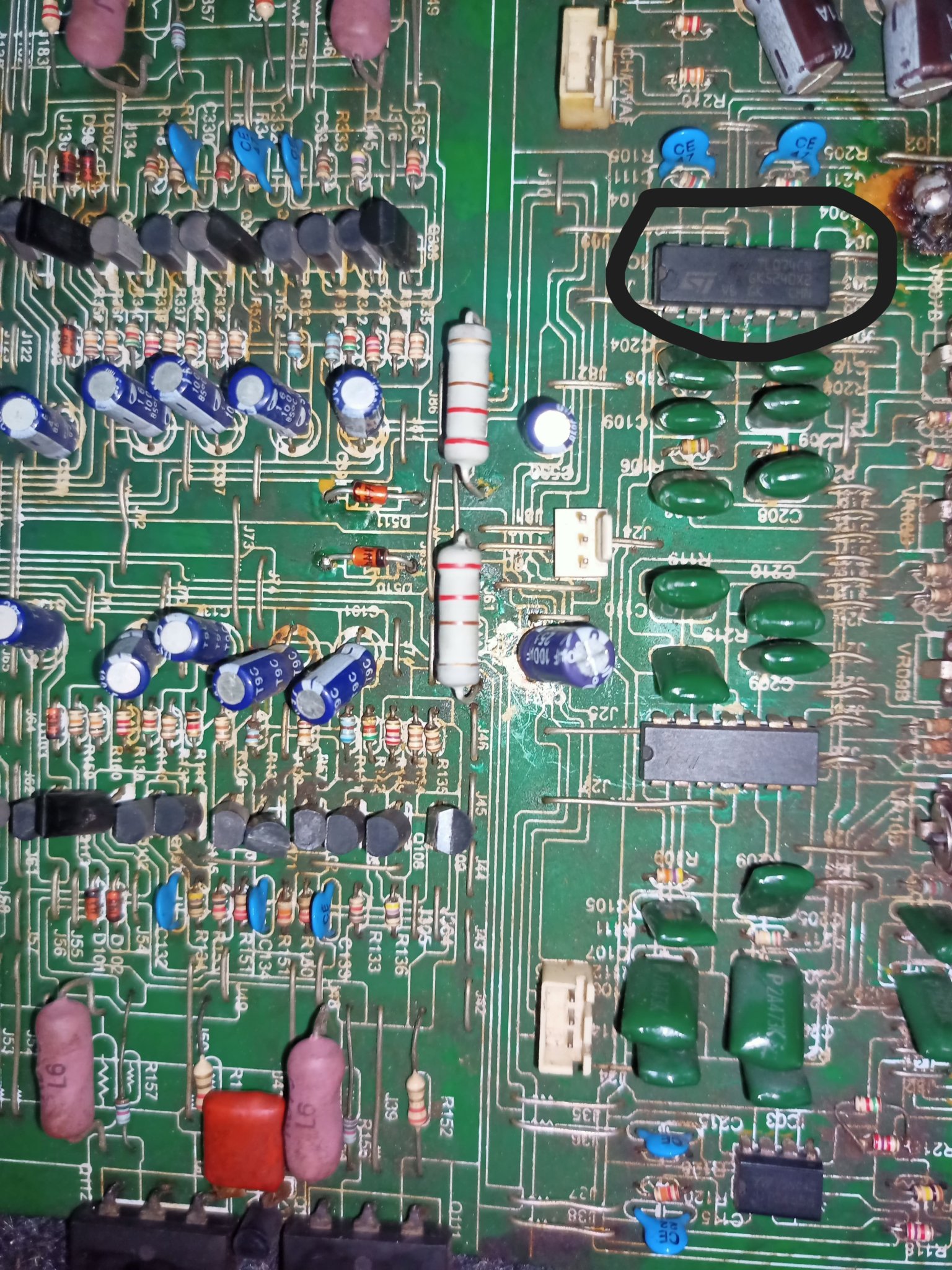

As a side note, if you get the amp working, you need to remove all of that brown fixative. It becomes both conductive and corrosive.
bro as you said i did this but now the 3rd ic at bottom right is heating so much and smoke is also coming15v Zener diodes. 1W preferred
Trying to fix this without a schematic and proper test equipment is quite difficult, even for an experienced professional.
And that board looks like it's been under water and is likely to have multiple problems.

The op-amp could be defective.
What's the voltage across the power supply terminals?
Is it possible that it's shorted to that jumper?

but when old diodes were attached then this op-amp heating little bit means as usual.The op-amp could be defective.
And now i also check the voltage of evey op-amp and the voltage is 18-19V.
Bro, a new problem has come. The zener diode has failed.Is the jumper shorting to pin 1 of the op-amp?
With 18v of rail voltage and a 150 ohm resistor, there is absolutely no reason for the Zener to fail.
When installed, did the two zeners read their rated voltage when measuring the voltage directly across them?
Does the Zener now read shorted?
What was the part number of the Zener you installed?

i watched the video on youtube and this same happen to that person but he use 12v zener diode and then everything works fine.
I think this ICs support only 12v

Look up the datasheet. The TL074 is rated for ±18v.

their voltage was 18V but only in D510.When installed, did the two zeners read their rated voltage when measuring the voltage directly across them?
