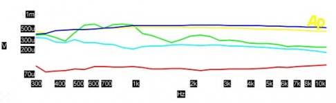

I thought it was clear that with 9 volts of DC you got worst case 500uV of microphonic effect. That is 85 db down.Take it for what you will.
This popped up while I was searching my files for something totally unrelated!
I test lots of different types of capacitors, this shows one of the worst. I never got to try SY's favorite loosely wound audophile specials.
A DC voltage was applied to the D.U.T. through a resistor. 9V/10K if I recall correctly. They were then placed on a woofer turned into a shaker table.
While grabbing the image the legend seems to have gotten lost. So what is here is a Mylar cap and an aluminum elctrolytic, two samples mounted vertically and horizontally. Base line is a shorted test lead.
Well, I was brought up on the "hypothesis, test, results, conclusion" school of science. If you don't mind me saying so, D.U.T. was a term that initially lost me, and I didn't understand the reference to SY at all. 😕
And if you ask a question, I will answer it. SY is a special case.
Now THAT I understand. The microphonic effect is small. That's what you call a conclusion. 🙂
The original graph still leaves me, and doubtless everyone else, confused though. I understand you had problems uploading it, but still, it was not clear. It probably works best as a piece of abstract art. 😀
