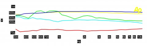

This popped up while I was searching my files for something totally unrelated!
I test lots of different types of capacitors, this shows one of the worst. I never got to try SY's favorite loosely wound audophile specials.
A DC voltage was applied to the D.U.T. through a resistor. 9V/10K if I recall correctly. They were then placed on a woofer turned into a shaker table.
While grabbing the image the legend seems to have gotten lost. So what is here is a Mylar cap and an aluminum elctrolytic, two samples mounted vertically and horizontally. Base line is a shorted test lead.
I really can't interpret your data there, Simon7000.

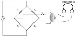

To make further progress, I think we need some sort of Bridge technique to test for microphonic effects with a DC offset, and look at some AC effects too.
It's simple enough, and quite old fashioned, but I don't have the gear to do this.
