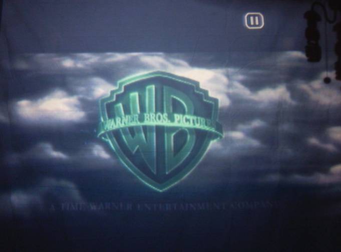

Well guys, the projector upgrade is in progress. I recently picked up a Viewsonic VE500, 400:1 contrast and 16ms response. Nice monitor. It has one ffc in the way that needs to be extended, doesn't look too bad. Preliminary results with this panel are very impressive! I will be using NVKeystone on my FX5200 to resize slightly to get all the image through the OHP, and an ATI TV Wonder Pro for tv and capture.
I got my QA-1650 today!
WOW WOW WOW THE PRETTY COLORS!
This is the best panel I have ever owned.
The colors are vibrant, speed is excellant with no lag on DVD or on my Counter Strike game.
I will take some pics later when it is dark and post them tomorrow!
