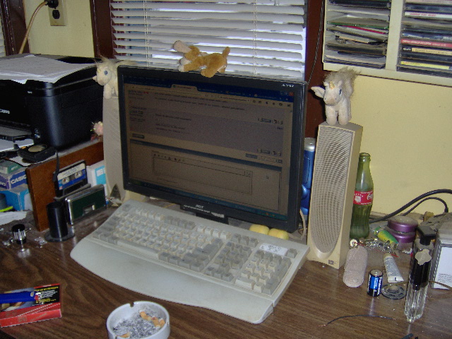

any other details i should supply like what i used to listen with...etc?
i'm canadian nicely floating is easier now...back to my scotch...altered perceptions...
yep it's used equipment alright, nothing but run of the mill JBL Pro computer speakers direct from whatever the soundcard is in my computer...(shh.... that's why studio engineers have their favorite crap speakers you know those auratone thingy's ...oops scotch talking...) after 30 years of doing live sound and recording i should be deaf...and oh i have a notch centered around 2.2k in my left ear...notch i mean scotch...
