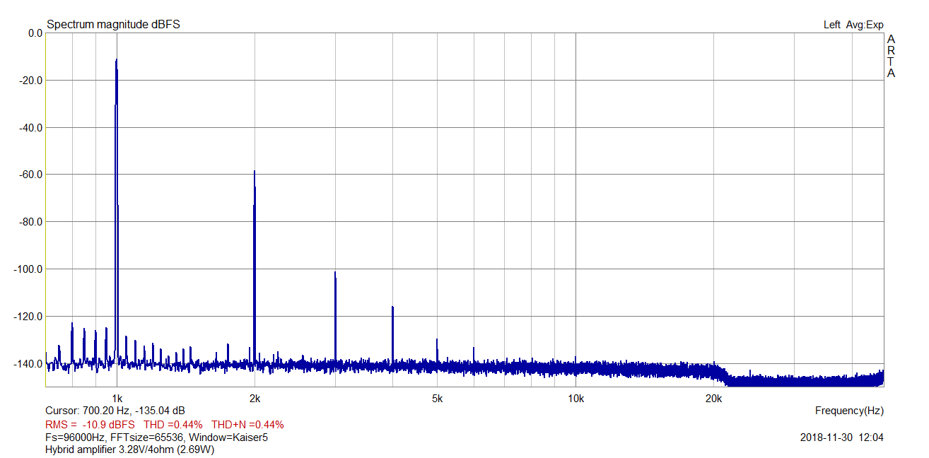

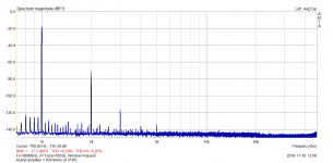

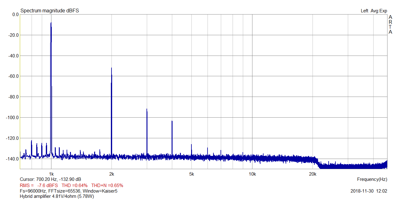

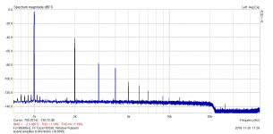

I have decided to make "better" measurements (= using more clean sound card) of distortion profile of the amplifier under test. Attached are measurements at 0.5W, 3W, 6W and 18W / 4ohm power. As a source there was a 0dBFS sine wave in 44.1kHz/16bit format, supplied by a CD player and DAC, which is pretty clean itself. There is a stepper attenuator at the amp input. We can see, that the dynamic range of the hybrid amplifer under test is better than that of the 16-bit file, as can be seen from the noise floor decay above 22kHz. One can also see decaying distortion of the amplifier as a function of decreasing level.

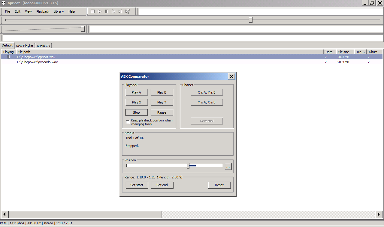

This Foobar configuration in conjunction with hotkeys Before and Next and mouse click anywhere in the progress bar allows me to flip between tracks seamlessly, instant (repetative) AB sighted testing.

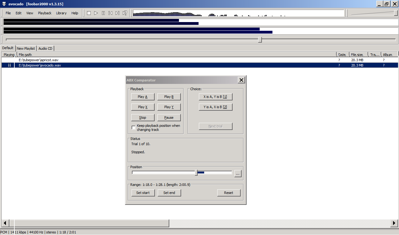

Take a closer look at the screenshot and you will see my method.
By pressing Before or Next hotkeys (need to be custom configured in settings) and in this case keeping the mouse pointer at 1:18 (or any particular point in any track) I can instantly compare playlist items repeatedly in any sequence...ABABAABBAAABBBABBA etc.
With practice and suitable program material discerning fine differences by this method is reliable I find, and correlates with longer term listening findings.
I can then pause the playlist (spacebar) and mouse click on the ABX applet Play A or Play B buttons perfectly easily and quickly.
I can then Stop ABX operation and return to the playlist perfectly easily and quickly.
This method allows near instantaneous playback comparison of all four playback conditions.

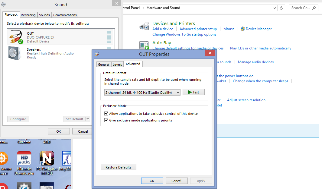

Dan, I will check it. The 24-bit loop should tell if there is an issue.
I am sure that you know it, but for the others, when playing sound under Win7 and higher and you want to utilize 24-bit resolution, please do not forget to set 24-bit resolution for the soundcard used in the Control Panel, otherwise 16-bit is default and hirez files are converted to 16-bit resolution.
After I read Maty's comment on Direct sound, it is necessary to make this setting!

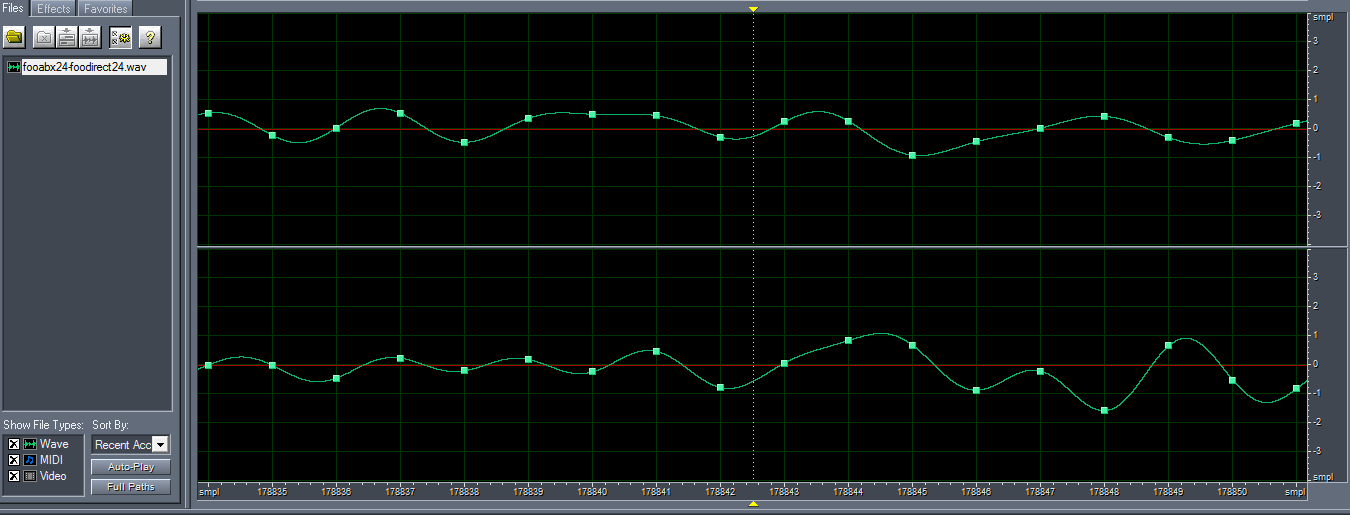

Dan,
I am sorry but I cannot support your hypothesis, at least not on my system. I have recorded 24-bit test files first played by Foobar2000 directly, second by Foobar ABX plug-in as A, B, X and Y. Always recorded by SpectraLab SW. In all cases, the recorded files are true 24-bit and they are same in max rms, min rms, avg rms, differing only in an analog instantaneous noise value, which is of course the random variable. They do not differ in rms noise level, but in instantaneous values, which corresponds to DAC - ADC inherent noise and in a 24-bit mode this is far below CD 16-bit noise bottom. So nothing, the difference is same as two DAC-ADC runs without signal or two DAC runs when you make your sighted test.
P.S.: I made a Diffmaker difference as well and all I got was a pure noise, same level as residual channel noise.
