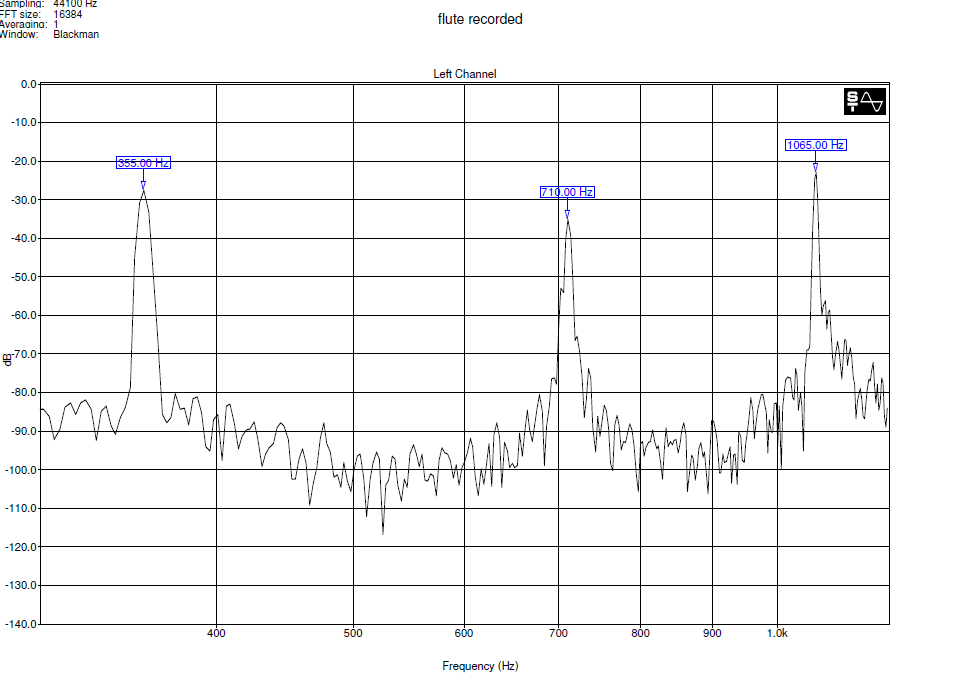

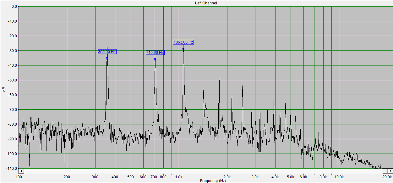

Gentlemen, if you do not mind, I have just recorded a fipple flute (played myself 😀) tones and made some analysis. Maybe not "exact", but really very close. The H3 travels between 1062 and 1067 Hz.

"Exact tones" and harmonics of them may be true only for a synthesized or computer generated music, and that's why it sounds horrible 🙂. Natural instruments will always have some slight fluctuation of tone frequency and this sounds more natural to our ears, because it is natural. I would bet that instantaneous overtones are exact multiples of the instantaneous tone frequency. Applies to intermodulations as well, they are also instantaneous. We do not use crystal clocked sine generators in music, usually, speaking about acoustic instruments.

Having thought about it a bit more, I now suspect that overtones will be harmonics on instruments with continuous excitation (e.g. flute) but not necessarily on those with momentary excitation (e.g. piano, guitar). Violin falls somewhere between the two, so I am not sure about that one.
