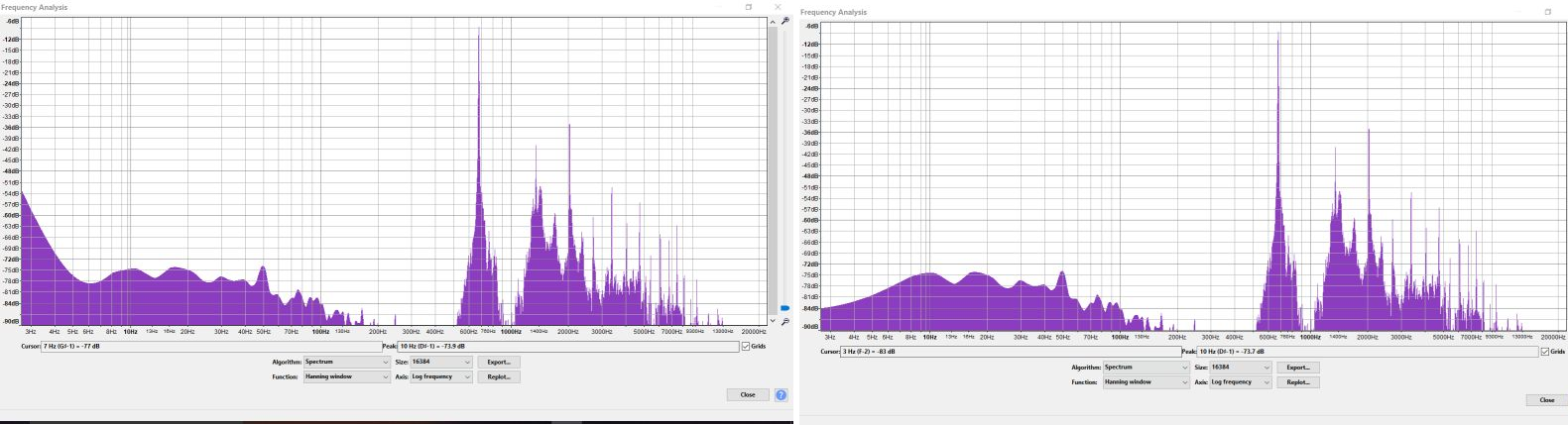

Yes, I think looking at the spectra over a couple of seconds is definitely masking what happens in real time. These were the two side by side.

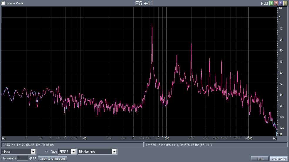

Yes, there is some difference in infrasound area :D (H2 makes DC...). The best way is to put both files into CoolEdit and to switch between spectra with cursor position at the same sample. When I make a stereo track from both files, the spectra are almost indistinguishable.
I made this small test to show that though it is quite easy to tell the sound difference on the pure sine tone, it is not so even on a single tone of a relatively spectrally simple instrument like the recorder flute is.

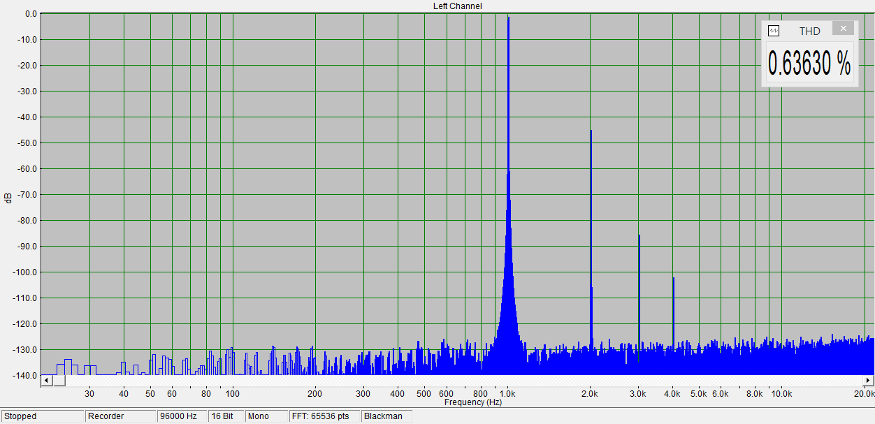

Regarding flute, it is no surprise, but sine should be quite easy. There is a necessary condition, or two conditions.
1) the speaker or headphone used must have lower distortion than the distorted wave (I assume soundcard is not a total cr.p)
2) the listening level must be low, otherwise intrinsic human ear distortion masks the signal distortion
The distorted sine has 0.64% THD spectrum attached.
Regarding flute, the amp added distortion is masked by the flute spectrum and IMO it cannot be audible be ear, in a DBT.

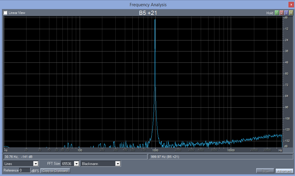

Sine original file has no distortion at all. It is your system or ears that make a distortion. I would suggest more humbleness in your judgement. Your system or your ears are fooling you, do not trust them blindly.
Mooly had 8/8 in the sine test, as an independent listener.
