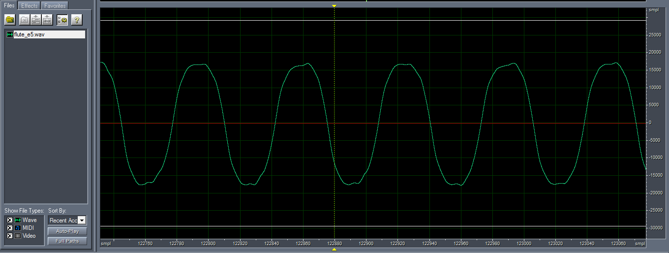

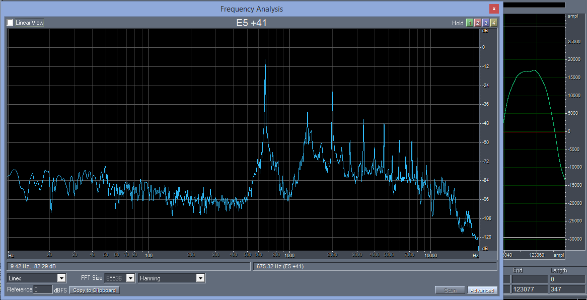

A test "byproduct" - recorder flute playing E5 note. I have processed it by the tested amp distortion profile - there is no chance to hear the difference. In analysis, there is a slight change in amplitude of the 2nd harmonic and even slighter of higher even harmonics. The difference file avg level is -47dB below avg level of the original tone. No chance to hear a difference.
if you feel there's no chance, why not make it a test? or is the thought that someone may actually have the ability to reliably hear a difference too frightening?
admittedly it would take a large number of participants to show that the previously accepted limits of thresholds of audibility of distortion are to be questioned.
Oh no, no frightening 🙂. I can post it without any problem. However, it would be just only another sample so no speaking about known thresholds. And the known thresholds are valid for pure sine tones, that are without any doubt most sensitive to distortion perception. I do not think there are any defined thresholds of audible distortion levels or profiles for music. That's why we are testing it, and we have only indications yet and not a single indisputably positive test result, in this current test.

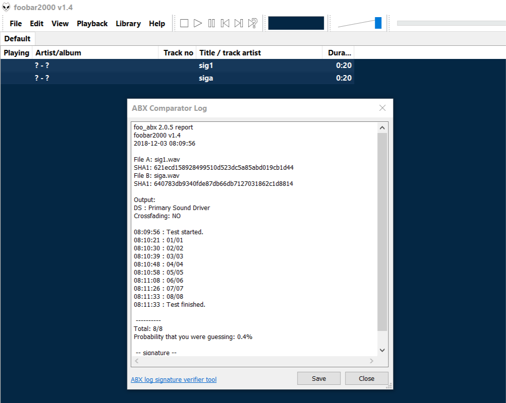

I tried it on the laptop over 8 runs, low volume but easily distinguishable.
Glad to hear/read it 😉
