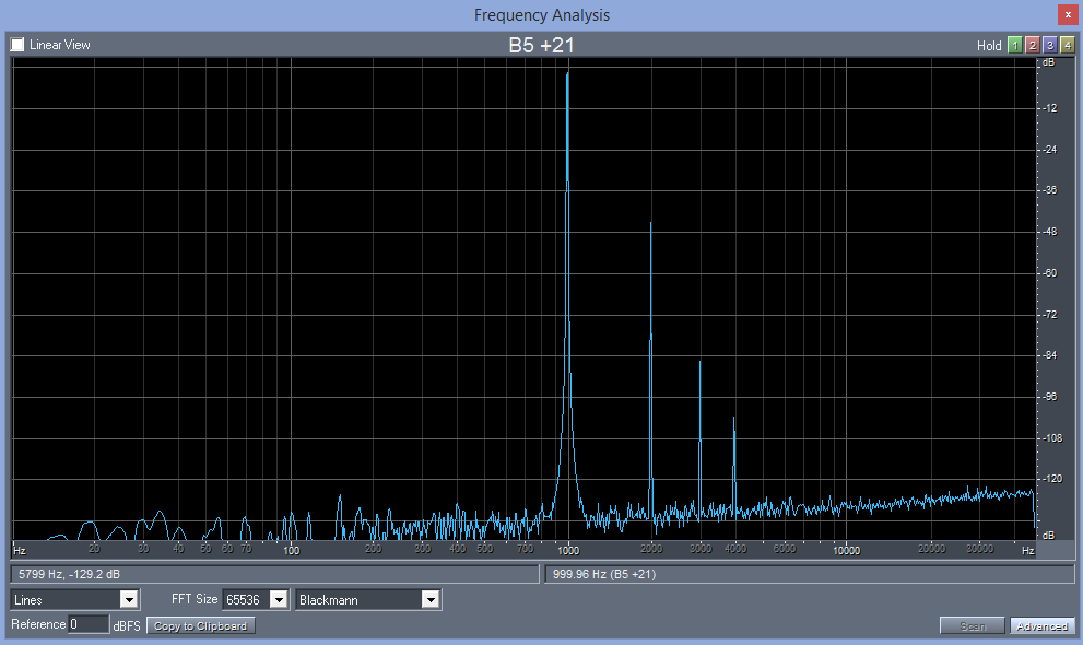

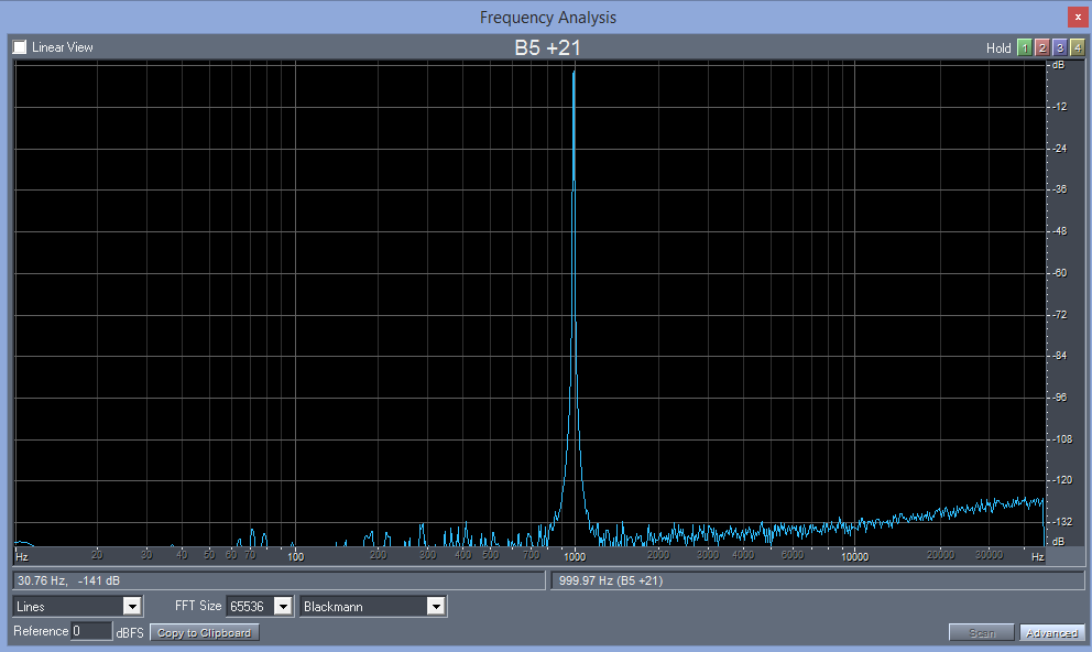

sig1 is a pure sine and siga is a distorted sine. Spectra attached. When listening to sig1 (at low volume level!!!!), the tone is clean and a bit painful. It is one uncolored frequency. When listening to siga at the same volume, you can clearly hear added coloration, H2, octave above base tone. If you use too high volume, your ear makes the same distortion effect on a pure tone, because of ear distortion. Please take into account that ear is nonlinear and creates its own distortion. Play sig1, decrease level until the tone is clean and then make the test.
Once again, you must have low distortion headphones/speakers and use low volume.
This test may disclose distortion of your system and your ear - thresholds of audibility of one or another.
Speaking about flute test, I think it is impossible to tell the difference.

I looked at spectrum analysis of the sine files. Sig1.wave is a pure sine, Siga.wav has H2, H3, H4 distortion. I can't hear them on speakers or headphones.
As far as I can tell, the harmonics are H2 -48dB,H3 -82dB, H4 -102dB below the fundamental. The fundamental is 1dB below full scale. That puts H4 right at the limit of the 16 bit file, but RMAA still pulls it out. Audacity plot does not see either H3 or H4 but I can pull them out with a wave editor. That puts H3 and H4 waaaay down.

Your analysis is quite correct. Audacity is very poor as a spectrum analyzer. You need to decrease FFT size to some 8192 (from 65536), spectrum becomes broader and visible. They have very poor visualization algorithm.

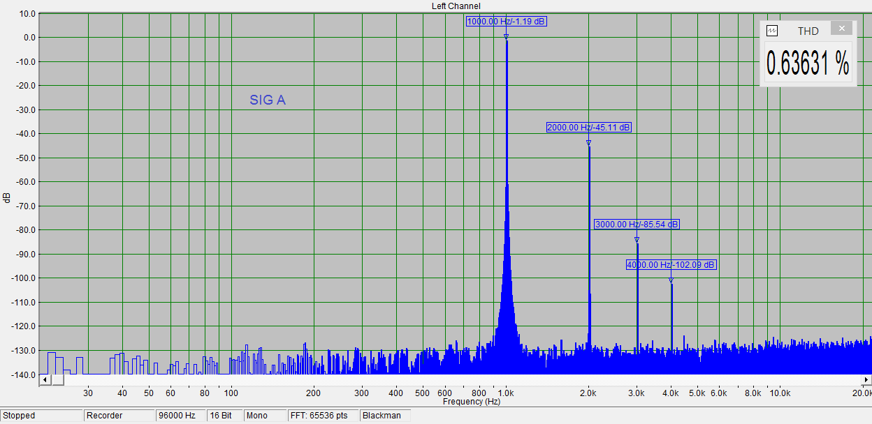

This is the siga analysis, quite precise. This should/must/is be audible at proper level with low distortion headphones and also low distortion speakers. Not with toys.

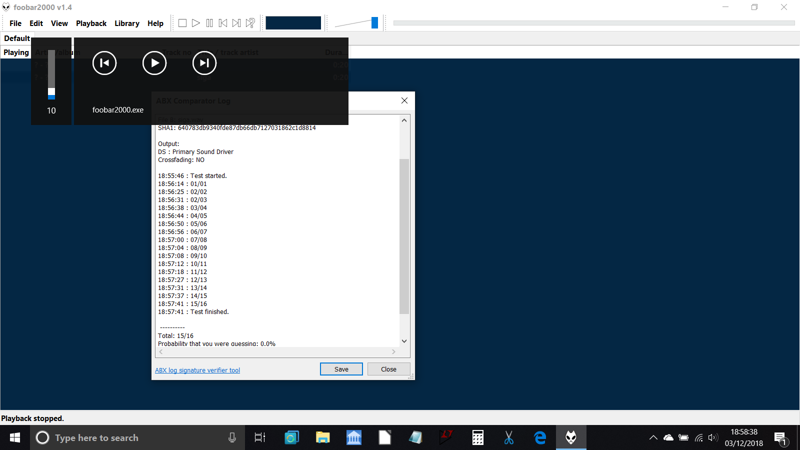

I just ran the sine test again, this time for 16 attempts. Just one little error crept in at the beginning, which is probably entirely an error by me in hitting the incorrect button.
Using inbuilt laptop speakers at very low volume as shown. So the audio chain is as poor as it gets.
