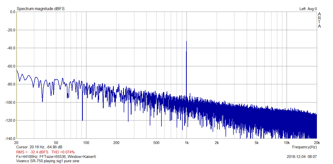

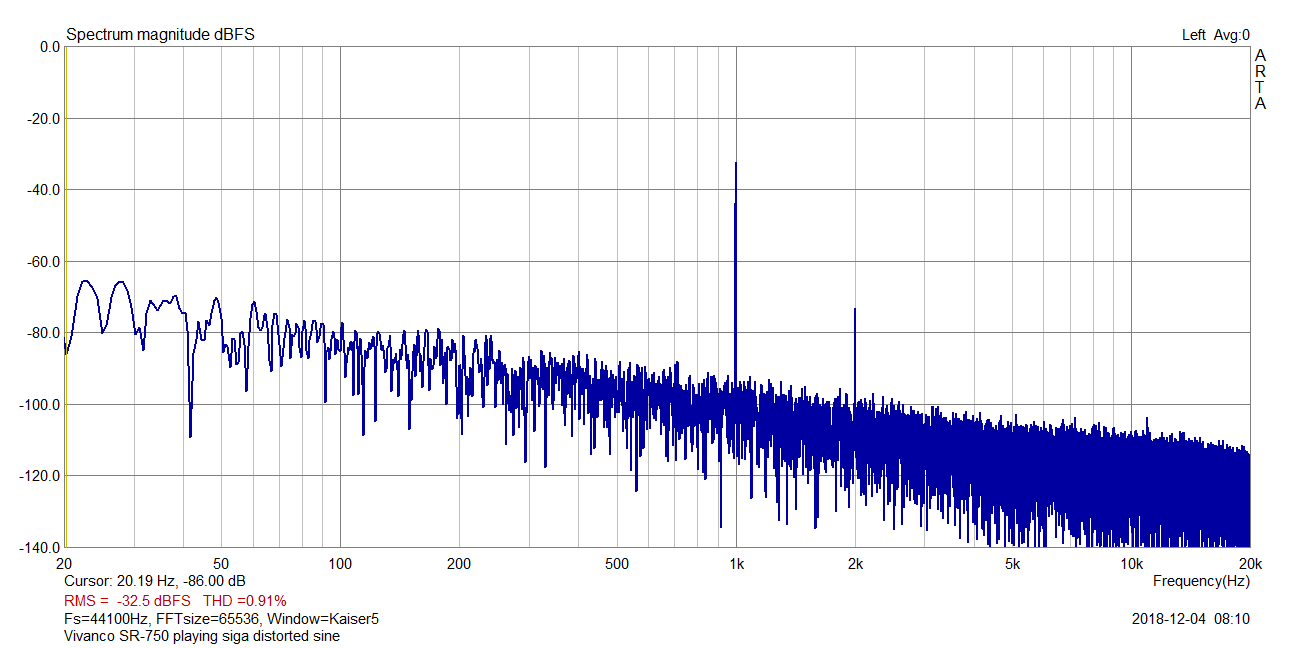

It may change it a bit by its own distortion, because every electroacoustic transducer has some (and not very low) distortion. That's why I assume the system should be verified by measurement. However, using higher distortion transducers adds distortion to the pure sine and makes sig1 indistinguishable from siga. I tried the test with laptop speakers ant there is no chance - even a pure sine sounds distorted.
My point when speaking about reported "big differences" on a very poor equipment was that it does nothing correct, and a small change in a complex signal reflects in unpredictable output on acoustical side.
It's 0.64% THD, whilst I can easily hear it with the sine

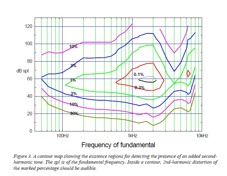

Again to sine tone distortion audibility, one of the best plots on the subject is IMO in
J. ROBERT STUART: Coding High Quality Digital Audio
The plot addresses frequency, SPL and H2 audibility threshold. According to that plot, our distorted sine should be distinguishable between about 50 - 80 dB SPL.

In fact, it is quite difficult to tell the distortion of the low frequency tone (see the audibility threshold graph posted few hours earlier). Maybe a slight change in harmonics leads to a subjective difference in bass perception.

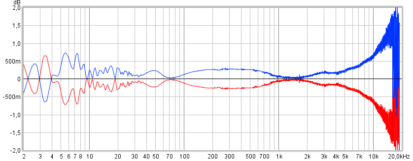

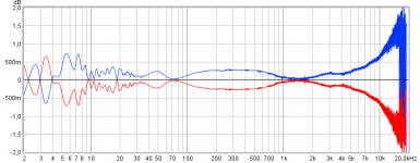

Think down the road i became aware my preference was the tube amp, it was at the time where Max Headroom made some noice i decided lookup spectrum plot for those two fruit files into Audacity and import spectrum into REW for making overlays and in that frq response for tube amp was shared in post 20 being about -2dB down at 20kHz it looked clear which fruit was tube amp, below graphs was using REW to divide their spectrum with each other and the red one makes most sence so that avocado is the neutral reference file.
