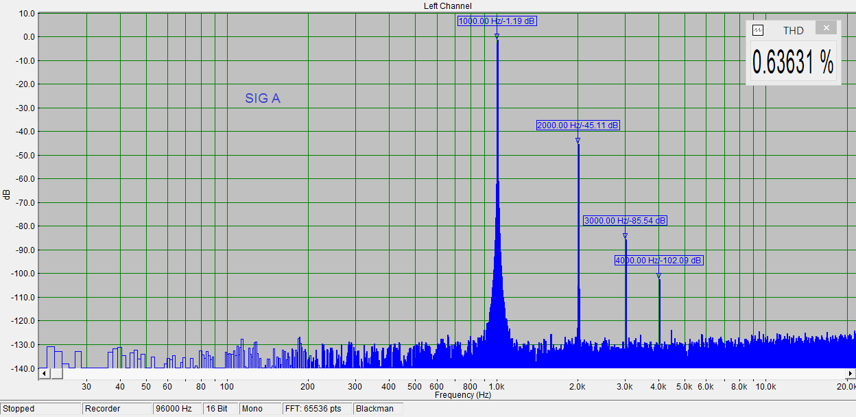

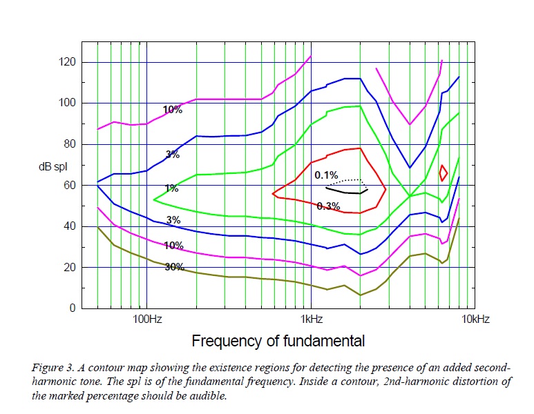

I don't think so. Those hearing it may have an advantage of playback gear with a peak at 2K. Certainly the case for Grado headphones. That could push H2 up by as much as 10dB. Remember, H2 is 48dB below the 1K fundamental. One would expect it to be masked. Or it could just be our playback equipment has too much distortion. I suspect that mine does. Time to measure it.
I do not agree. H2 is 43 - 44dB below fundamental. THD = 0.64%. This is audible, for 1kHz tone. I am attaching the spectrum again and the thresholds as well. For 60dB SPL, audibility threshold for 1kHz is 0.2%. Try again at proper level with reasonable headphones. I do not think that Grado elevates the H2. Remember if the headphones have H2 of some 0.5%, the test would not pass. If SPL is too high or too low the test would not pass as well. I know you mean rather freq. resp. peak.
