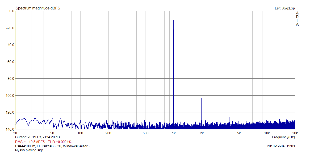

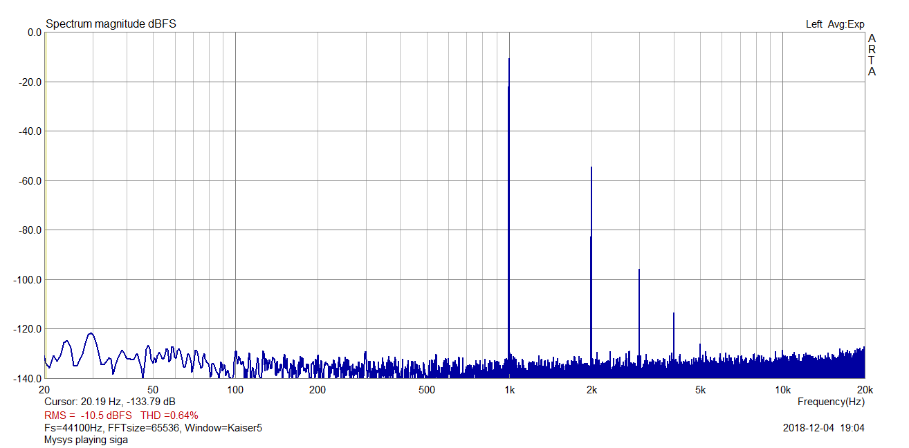

I tested my playback chain as used for the ABX. No surprise I can't hear a difference!
Played from Foobar both sig1 and siga show H2 near -46dB. Maybe 2dB higher on siga.wave but both are close. Curious. :scratch:
This makes sense and that's why I always recommend to make a loopback test of the system first. I may sound boring, but without measurements we are blind. I get this as attached when I play sig1 and siga, and couple of hours ago I showed headphone acoustic output.
Played from foobar and recorded/analyzed by Arta.
Now, it also determines our listening tests.

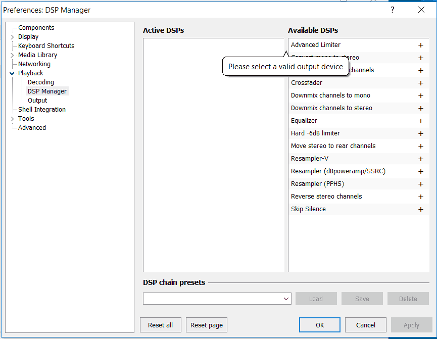

Pano, can you show your foobar setting (Preferences - output and DSP manager), control panel sound setting of the card, card type?
See screenshots below. No DSP is active. Output is via HDMI to a Yamaha RX-V2700. Yamaha on processing bypass "Pure Direct"
