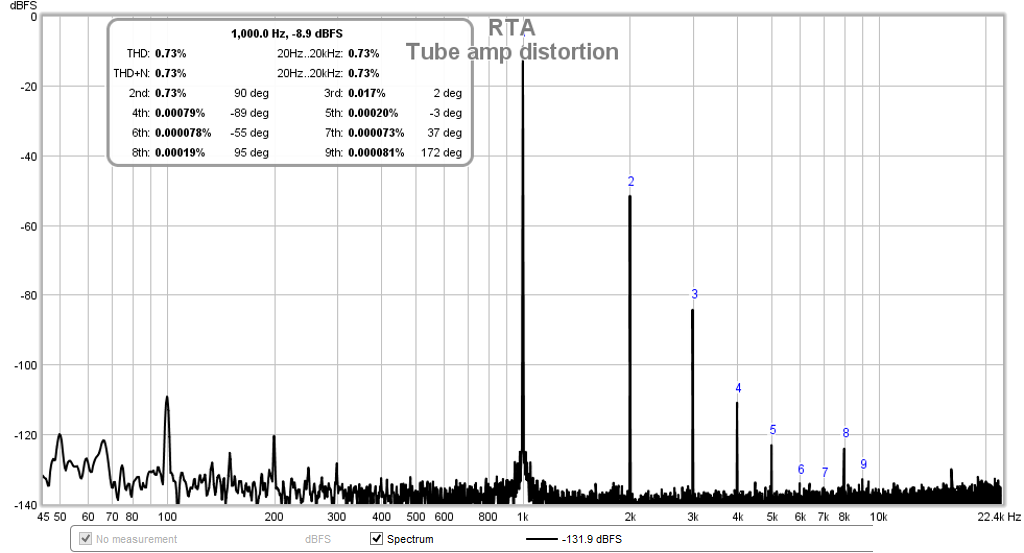

It will be interesting to find out what level of THD the tube voltage amp was adding to the original signal, and what the harmonic spectrum of that THD was (All 2nd harmonic with nothing higher? Descending levels of 2nd, 3rd, 4th?).
You can see some measurements in this post
Can you tell original file from tube amp record? - test
THD vs. amplitude plot is up to full amplitude in the test file. Distortion spectrum at full amplitude is now attached. You can see that H4 is below 0.001%, so in fact we have only H2 and H3 that might affect the sound. As the signal amplitude is lowered, higher order components completely disappear and there is only H2 then.
Thank you for the ABX report as well. I think that 10/16 is better than just guessing, if you were able to repeat the result, it would bring even more confidence, as now we have 22% probability of guessing. But I take your result and impressions serious.
You asked what we use for testing. I took a Roland external USB card and Vivanco SR-750 and Sennheiser HD598 headphones in this test.

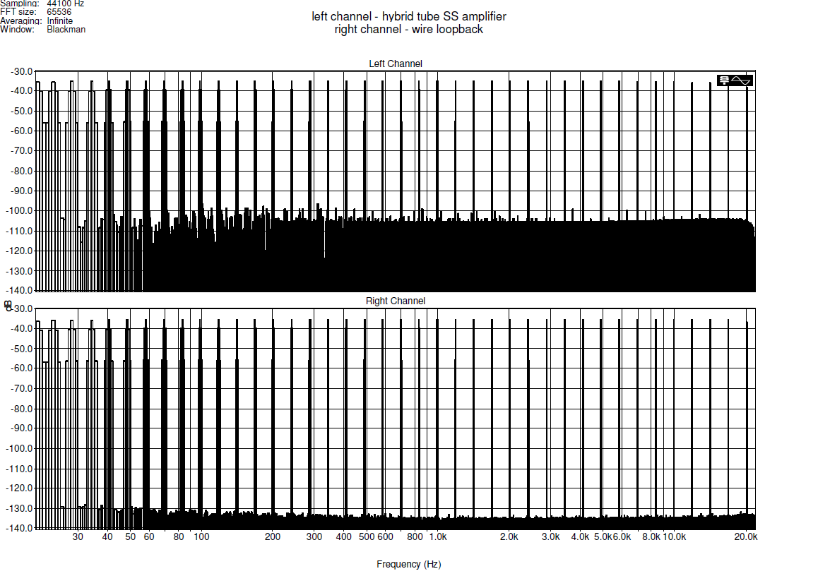

One of the most interesting measurements on the amplifier under test is a multitone measurement (with wideband multitone). I am attaching the plot where left channel is measured through the amplifier under test and right channel is a wire loopback (i.e. test setup limit). We can see that the distortion components in the amplifier channel produce apparent noise floor elevation of some 30dB. Still, the dynamic range probably remains high enough for this to be inaudible or just at audibility limit.
