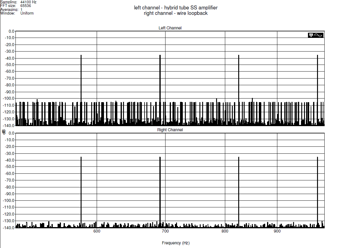

Can you tell original file from tube amp record? - test
Which file is the original and which do you prefer
  • Apricot is the original file

Yes Jan, you got it right.
I tried listening for differences sighted and per ABX (with Sennheiser HD700 driven by RME Adi-2 Pro FS) on two different days and the outcome is null, no stable difference I could reliably detect. Just guessing more or less so I didn't even bother to complete the ABX runs exect for one short try, with 3/8 result :-(
Need to test with speakers though I have little hope to fare much better...
