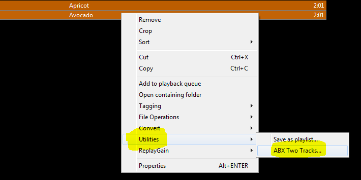

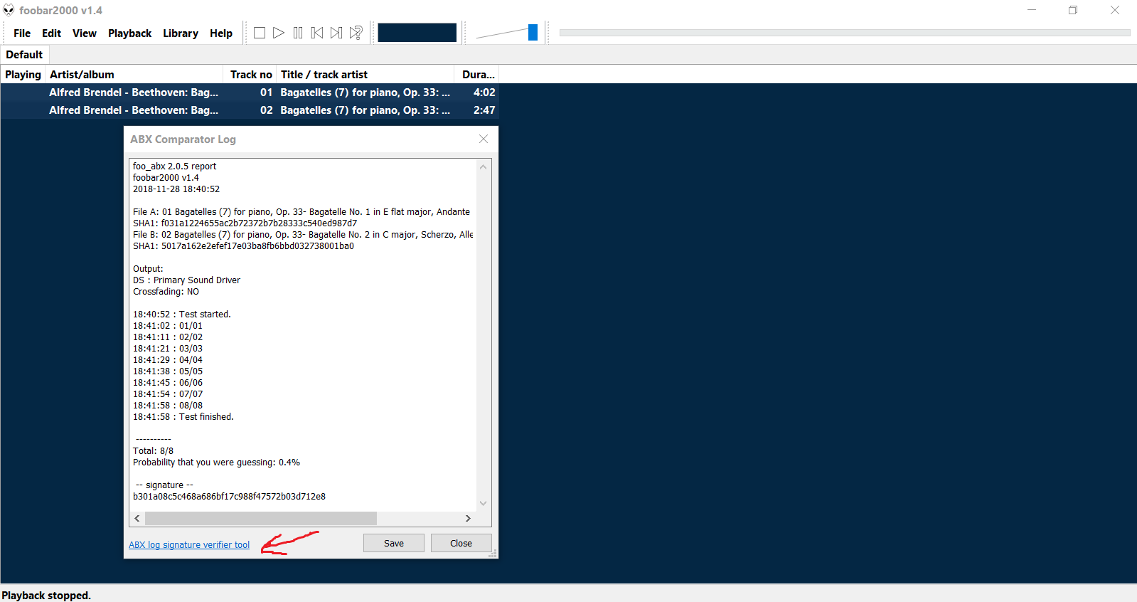

can somebody help me with the abx thing? i think i've got the abx component but not sure how to access or use it, any links to tutorials would be appreciated!

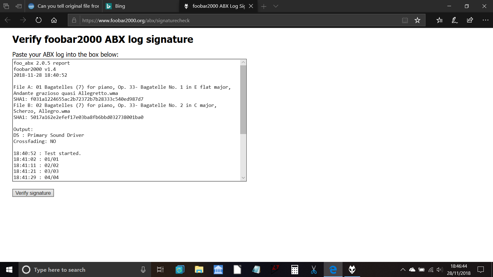

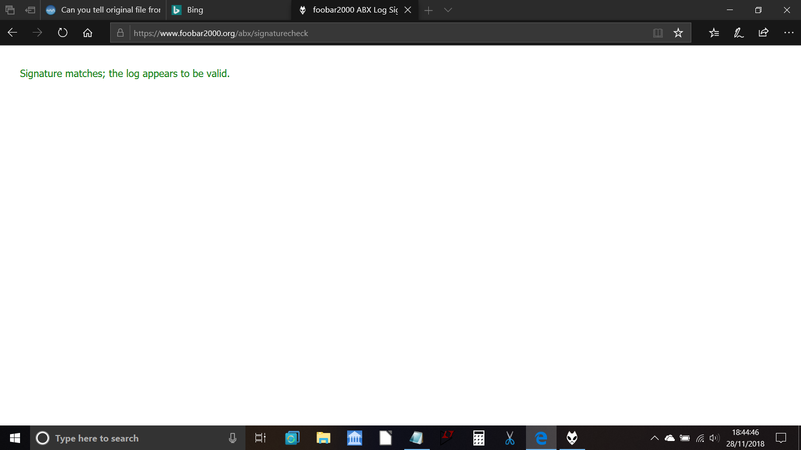

When you "Exit" the "ABX comparator" window you get a dialog where to save a txt-file log of your results, notice where the folder path is to that saved file and when you open that txt-file then copy and paste the result into a new post here.
EDIT Mooly was first here : ) and i see my used versions of Foobar and ABX plugin is older than what Mooly show.
