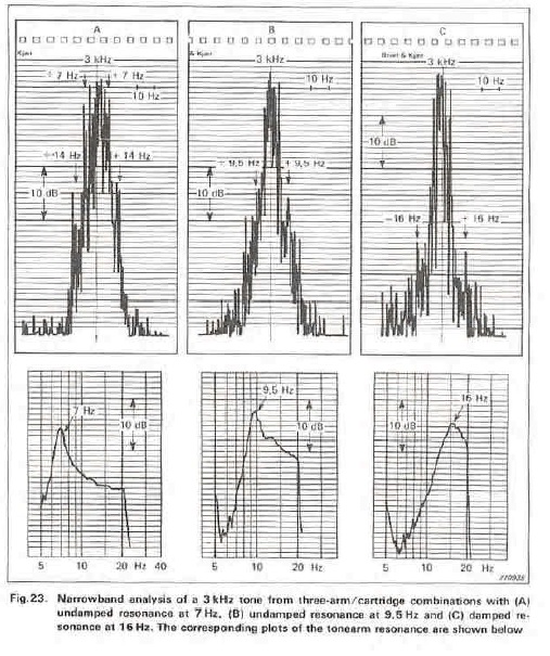

The real advantage of linear tracker arms in terms of the topic of this thread is that the zero offset angle of the LT results in less FM/flutter when the arm experiences horizontal resonances. LT arms produce less ‘scrubbing’ of the stylus. Less scrubbing produces less FM/flutter, which shows up as a pitch instability of the turntable.. . . . . . .
. . . . . . . B&K did a study in which they mounted 3 arms on the same turntable and measured wow & flutter for each case. They found that each of the 3 arm/cartridge combinations yielded different W&F values, with the LT arm being the lowest . . . . . . . .

Interested to know where the the speed variation is measured, the platter, the record, or the signal output of the cart?
In my own previously posted test about stylus drag effects due to modulation changes and the resulting effects on platter speed, the test was done while measuring various modulated test tones from the record (as received by the cartridge) and compared with the actual platter speed (as taken from the direct drive servo).
There was nothing worth even worrying about with this subject on stylus drag.
