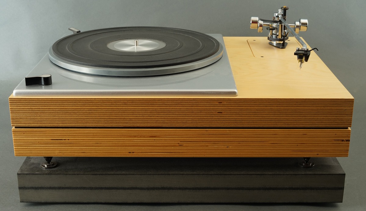

All very interesting, here my contribution ....
In my youth I had a Lenco L-75, which had its qualities and defects. Among the first, it had a heavy and well-balanced chainring, and a motor with great torque and stability. The transmission was a pulley, and continuously variable mechanically. Unique and extraordinary design in my opinion. It came equipped with a small stroboscopic disk (I still have it, to check if my current TT DD Micro Seiki controlled by a quartz crystal oscillator is still spinning at the correct speed, since it does not have regulation or built-in light/display as many others did) , Technics SL 1200 is the classic example) and with a lever that acted as a gear change by placing the pulley on a conical shaft at different points. You could also relocate the optimum speed with the use of the stroboscope and loosening the screws of a slider. Simple, straightforward and efficient.
L-75 is very sought after nowadays (it is very difficult to find in these parts, I sold mine a long time ago and then I regret doing it) to build TT Diy's, you can see in the photo the one that TG built. http://www.troelsgravesen.dk/My-Turntables.htm
On the defect side, the original Lenco L-75 arm was mounted on two V-shaped blades that were mounted in their respective rubber V-blocks, which were damaged but can still be obtained as spare parts and even manufactured. in homemade form. The other "negative" issue was a decoupling system between the weight link behind the pivot and the rest of the arm. This was achieved with an elastic central wire, which over time would wear out and look very bad, but still worked to balance and was still efficient in preventing acoustic feedback. https://www.lencoheaven.net/forum/index.php?topic=13.0

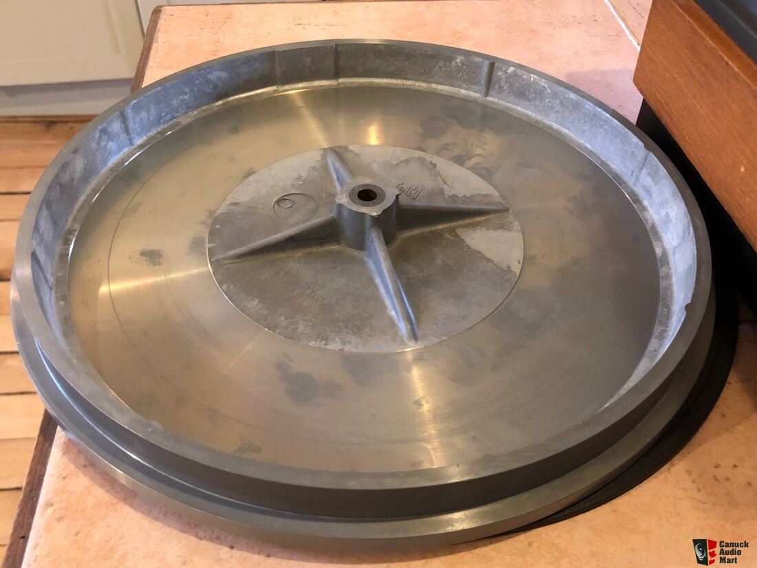

And as I've said before, there's no need for a bulldozer weight turntable platter for satisfaction.
A high-mass platter of turntable increases rotational stability, thus decreasing wow and flutter. No matter the transmission system, it is always better. The first Lenco chainrings were steel and light, then aluminum and heavy, don't be fooled by what you see on the surface, the rest is below. Here you can see a lot of Diyer's work, many use the platter and the engine of the L 75. There is a job that appears to be two stacked steel B-52/55 chainrings, there are even TTs with linear travel arms! To recreate the view, that's Diy's !
https://www.lencoheaven.net/forum/index.php?topic=2115.0
I can agree with heavier with rotational mass being a powerful way to render wow/flutter issues non-issues.A high-mass platter of turntable increases rotational stability, thus decreasing wow and flutter. No matter the transmission system, it is always better.

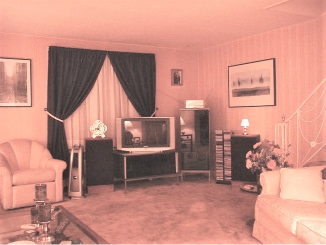

Perhaps I am setting the bar too high and I consider the phenomenon as if I would be experiencing it in normal listening conditions for me...(80 to 90 DB, I don't think it will go beyond that, I haven't measured it but it is high, and only I do for short periods. I try to take care of my ears.)
I think that my system, by having a very extended low frequency response, can help (negatively) the AR phenomenon that I described...
I've tried the volume at about 3/4 of the way up with a 60/60W receiver punching a pair of 10" air suspension woofers in the room."Even if I turn up the volume" is a very vague phrase. How many Db/Spl do you apply at a foot distance? What low frequency response do the cabinets have? What is the location of the turntable in the environment? What are the dimensions of it? Are there null points as in 99% of the environments without acoustic treatment? , etc etc. Too many variables to consider.
Db levels that vibrate the ashtrays across the room.
No feedback issues at all.
None.

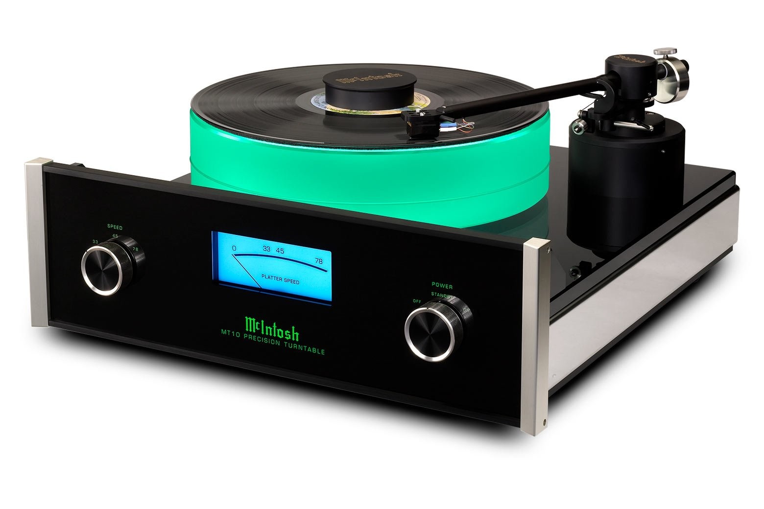

Planet 10, I see that you are a very experienced person and you have been "at the dance" so I am glad for that, you are a source of knowledge that not all of us here have.
Questions:
The current Mc Intosh turntables have plates made with unconventional materials, I don't know if they are heavy or not, maybe there are steel balls scattered around inside, I really haven't bothered to find out on the website or ask the representative in my country, whom I know.

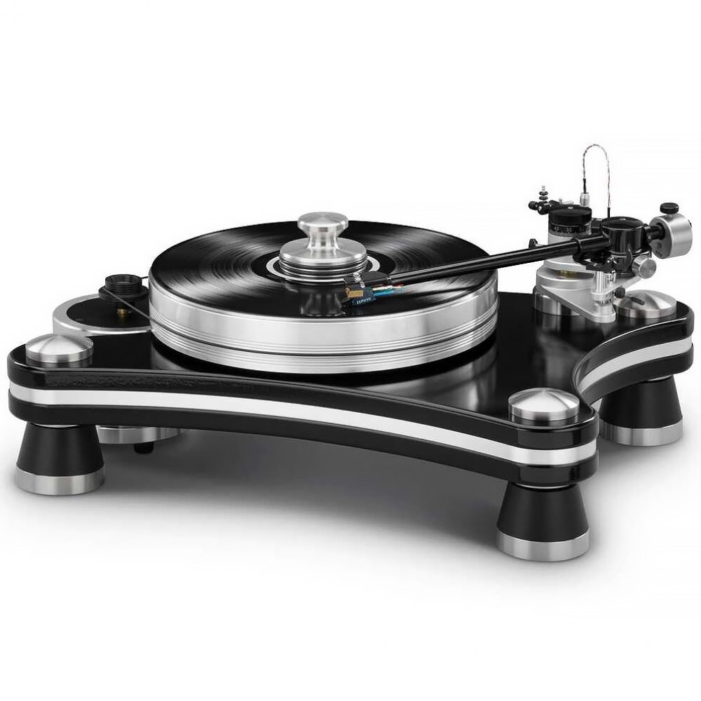

I have also heard VPI, they have very heavy "conventional" cymbals, and both deliver a wonderful sound. I would be very happy with any of them. So which one do you prefer and why? Can you explain it to me with " hairs and signs " ? Thank you !

IIRC some kind of delron-type material. Some use brass weights around the perimeter (cylinders) to increace rotational momentum.The current Mc Intosh turntables have plates made with unconventional materials
