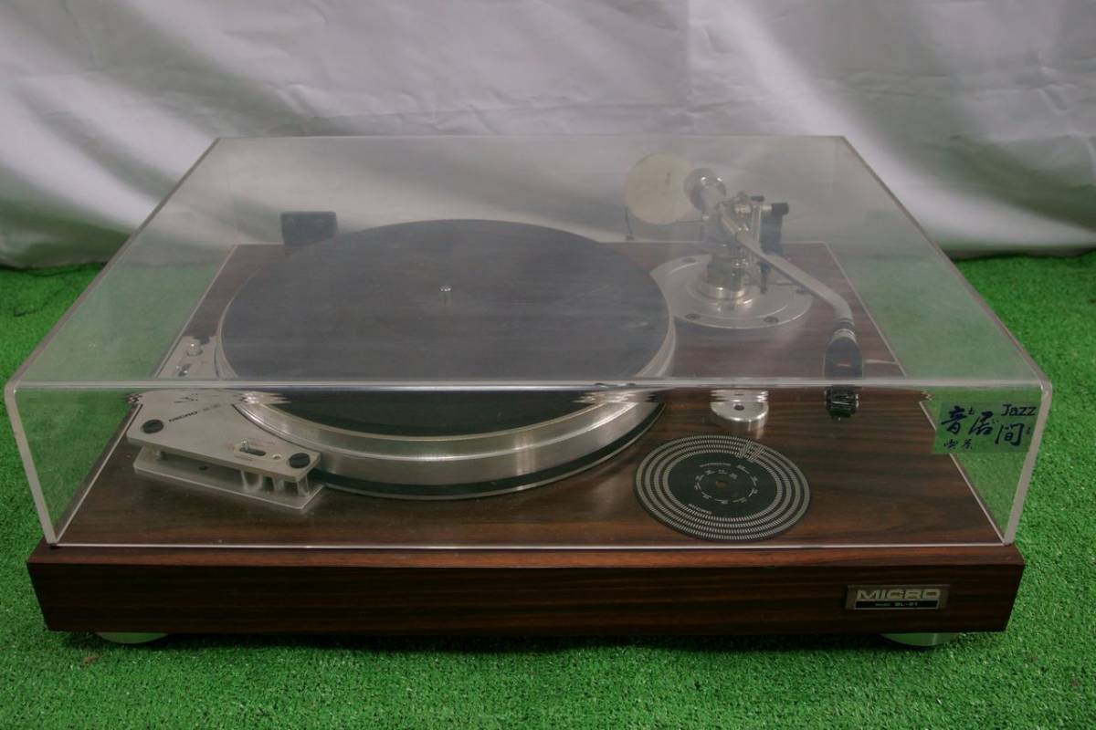

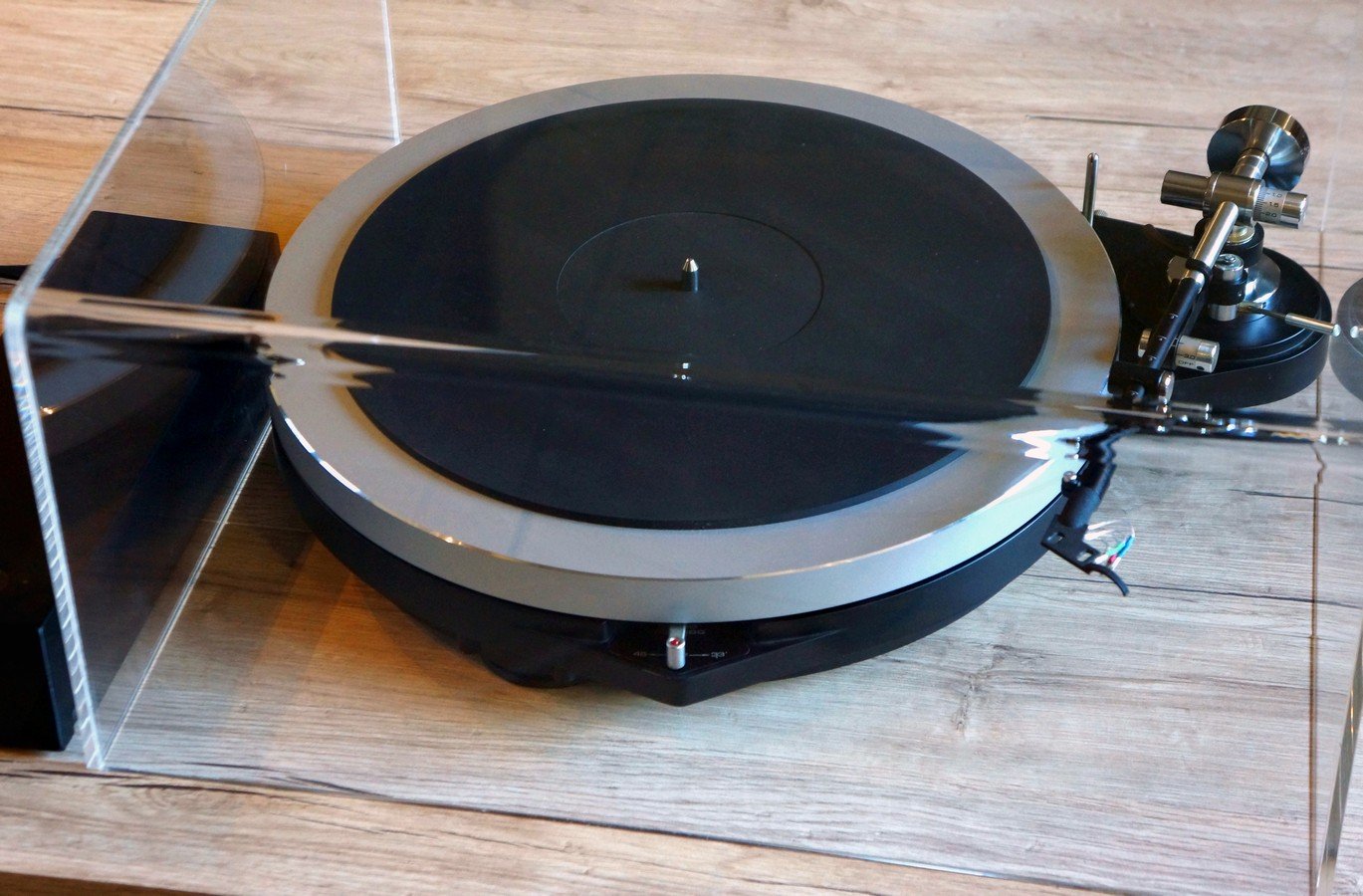

Those designs started with the Micro Seiki DQX 500. I used it.
I also used MS BL-51. A large, solid plinth, quite heavy chainring without going to the extremes of some current designs, belt drive and MA-505 tonearm. If I could have bought one of those I would never have abandoned it. What beauty and great performance ! My preference.
Probably these modern designs without cabinets (horrible for my taste, sorry) aim, in addition to being something "different" aesthetically, that this plinthless configuration is less likely to capture acoustic feedback. There are times when at high volumes, the difference between listening to music with the cover open or closed makes the difference whether or not the AR appears. Everything sounds great, loud and clear, so you decide to lower the lid to protect your precious vinyl from dust, and the phenomenon appears.
What would seem to show that it occurs when sound waves make the entire structure vibrate, through the largest surface of the acrylic lid. The same "up" or "down" makes a big difference. Serious - and wealthy - audiophiles don't use TT with furniture. What makes it more inexplicable for me that the AR is not present under any circumstances in the classic TT of the man of the repeated sepia photos....
I have noticed that there are practically no more manufacturers that use "classic" cabinets in their products. (Project, Rega, etc.) And the very high-end TTs, they all come "naked", without clothes, which shows that audio is a Totally pornographic question!
And to close my participation here I conclude that AR is a problem of physical laws, and has no solution in certain closed environments. As I said before, in the garden, you can give it all the volume you want that even the cheapest and most shabby TT will not find out about the AR, you will only have to deal with your neighbor. Which is no small thing.

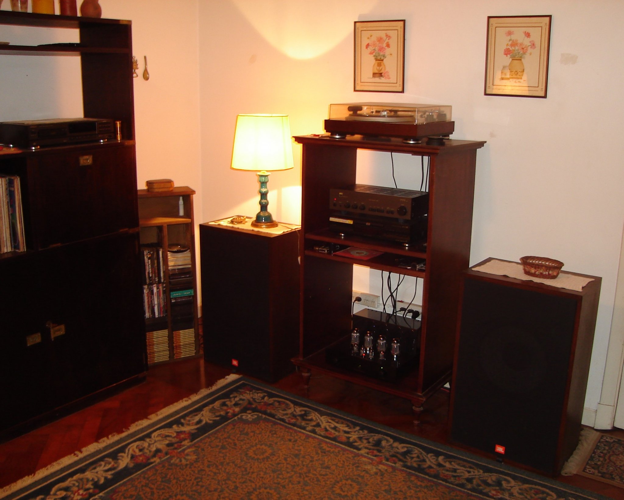

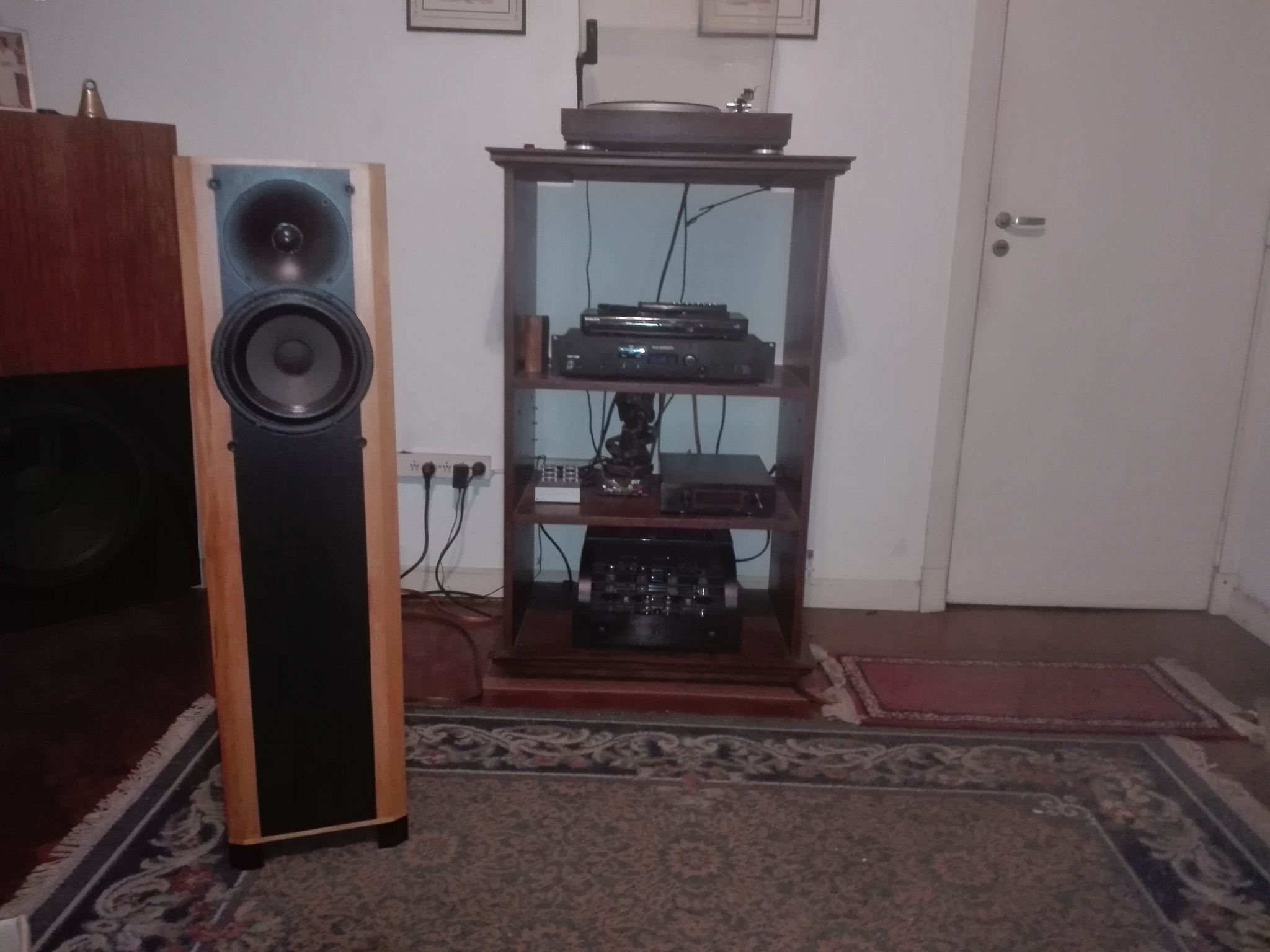

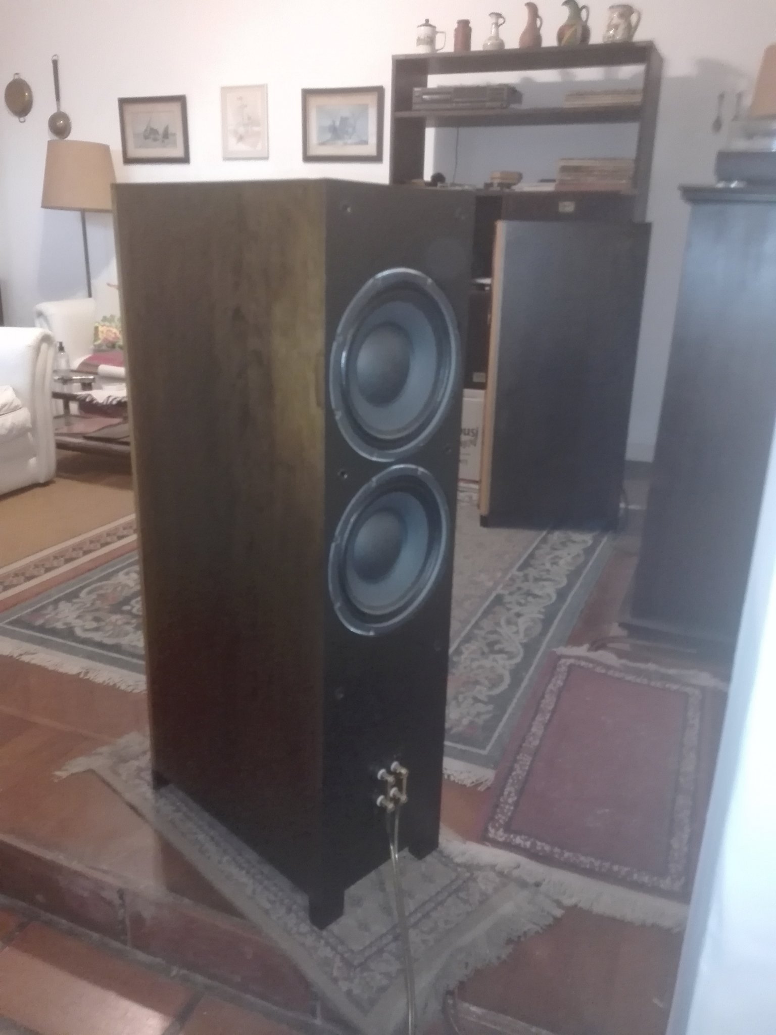

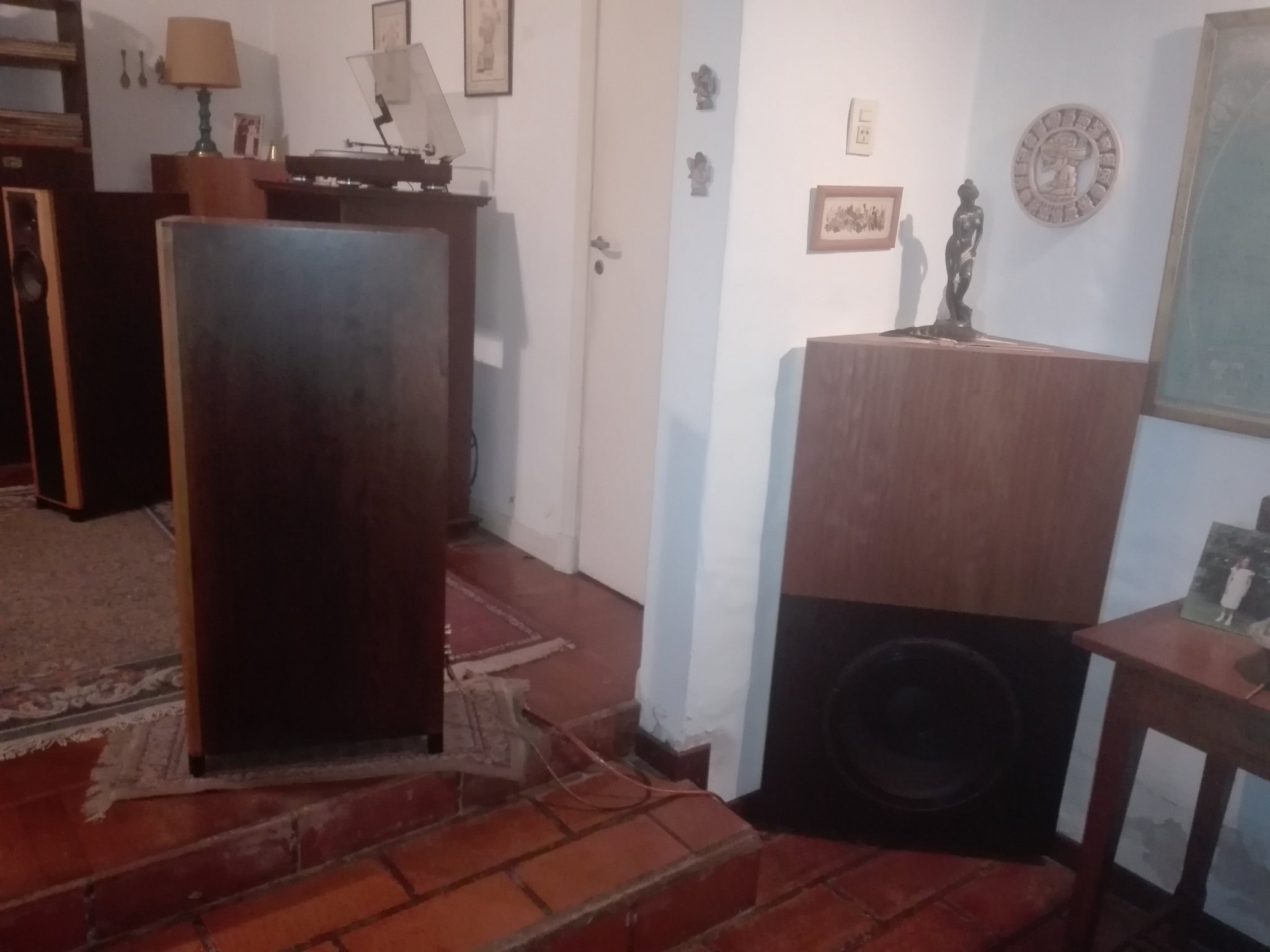

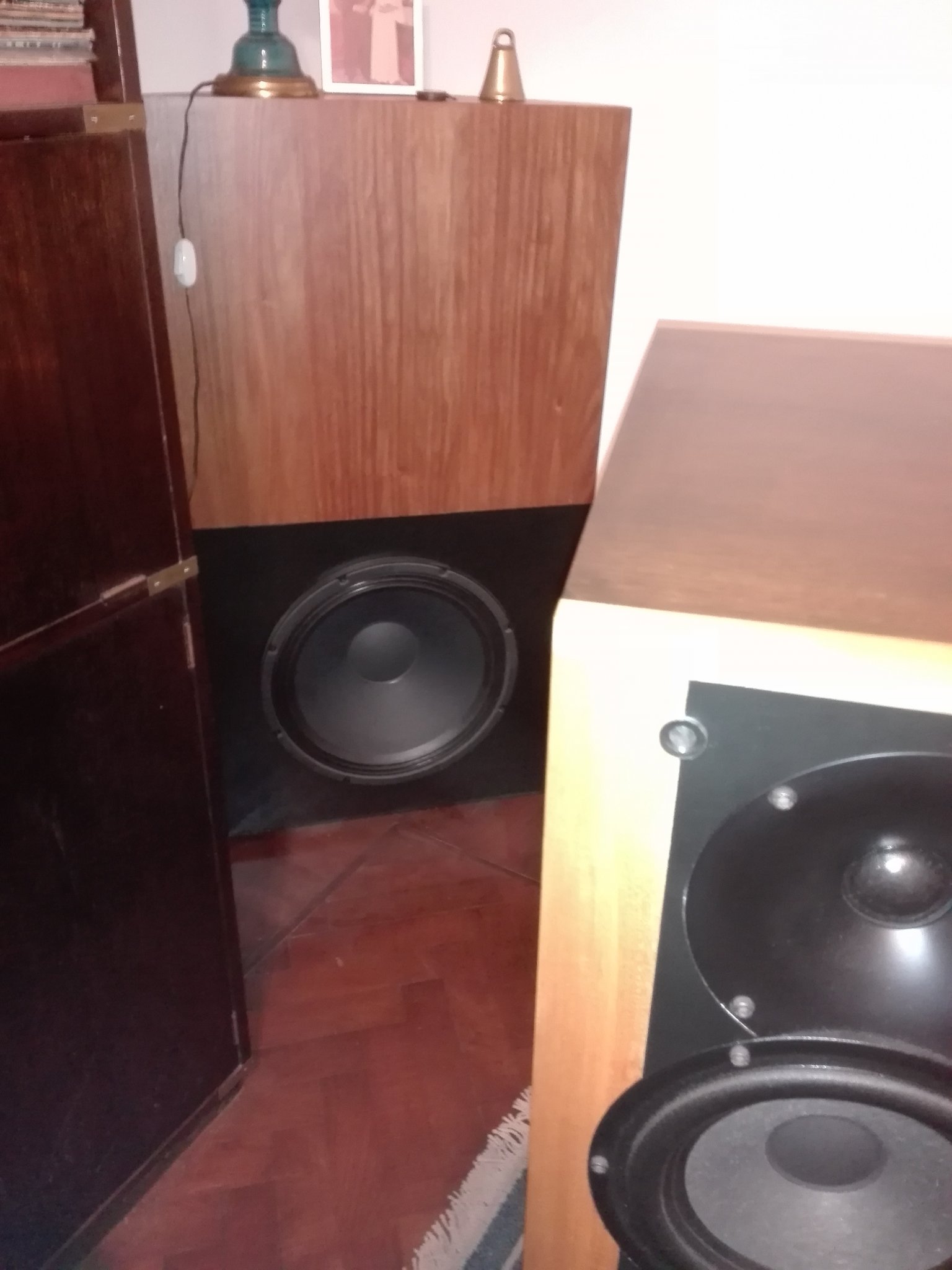

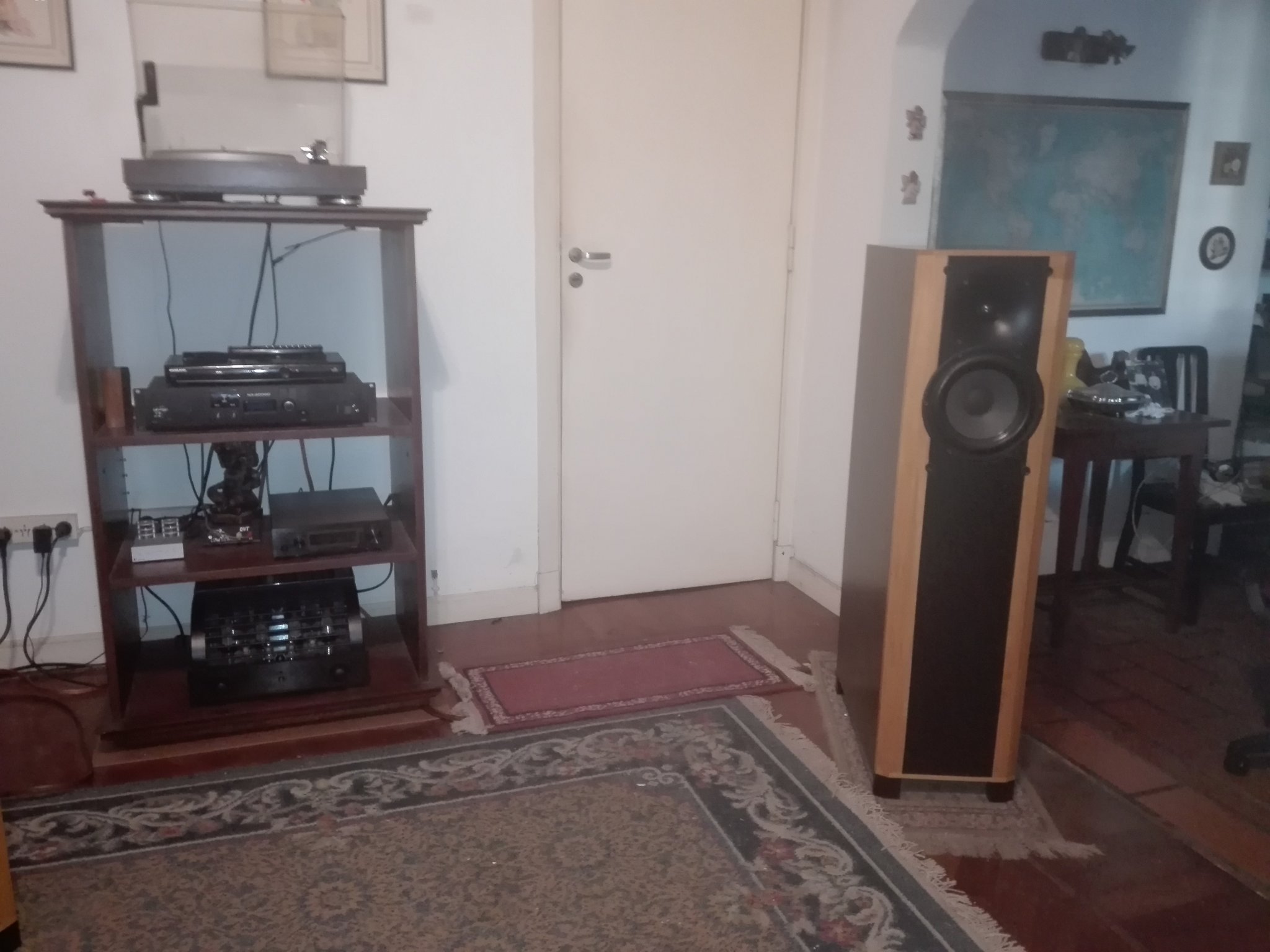

What kind of stands are your TT's on?
Ops, forgot to reply, sorry. I found a picture of my system before the update and took pictures today (terrible quality, forgot to turn off the flash) so you can see how it is now. I didn't like the cabinet with those flimsy feet, (inherited from my dear father-in-law) the amplifier alone weighs 30 Kg., so I modified it, made a base with wheels and mounted the cabinet on a sandwich of " hardboard " and " Eva rubber" plate. The "parquet" floor was spoiling for the whells, but although WAF is already resigned, it was a mischief. I think the acoustic coupling issue has something to do with the large amount of SD radiating from all the speakers in the room, 2x18 " subwoofers, 2x8 " midrange, and the DTQWTII have 2x10 each that point towards the TT and interfere with sub´s . I tried inverting the phase of the subwoofers but nothing changed.
So when a visitor (an audiophile fanatic like me, haha) tells me, "turn it louder", I put cotton in my ears and then ask him to choose a CD from my collection or search my smartphone / Tidal for his favorite topic. They are usually speechless.

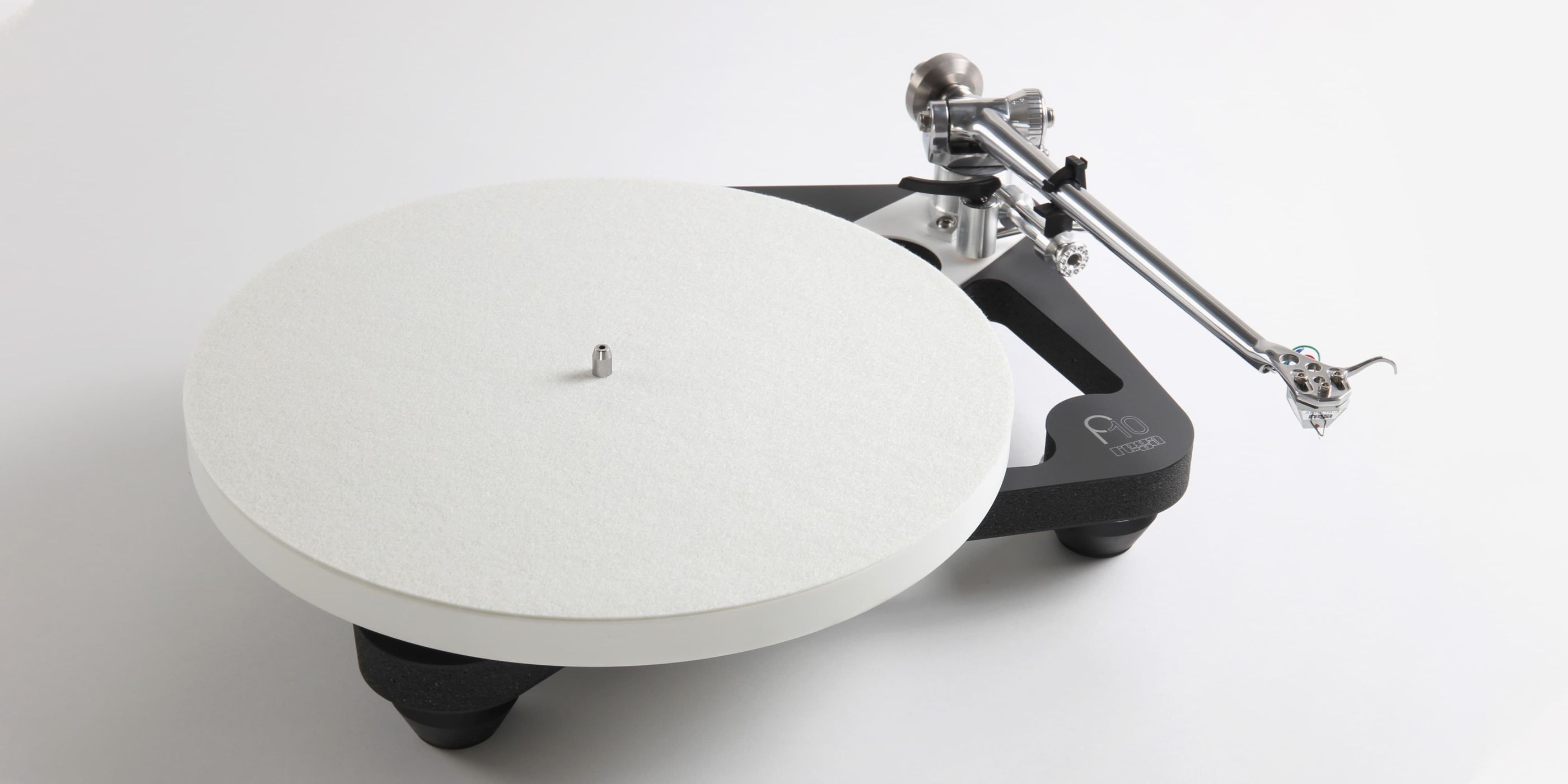

I've owned a Rega RP8 with Aphetta 2 and was never happy with it so I bought a Technics SP10mk2 / EPA100 / ECP205 and plonked it on the floor near the Rega, the next day the Rega was on the market. I would never buy another Rega product.
My now highly modified SP10mk2 sits on a Minus K in another room away from my lounge room.
Reactions: Charles Darwin
The rega brand is overhyped, and consumer reviews are opposite reviews by so-called online magazine critics.
I'd never want one.
Besides, rega never publishes wow/flutter/rumble specs.
Why the secret?

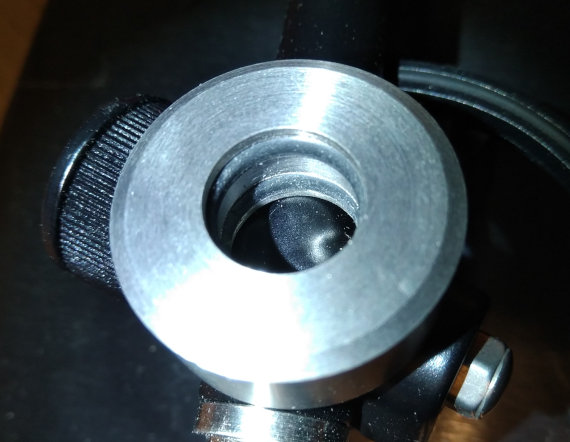

So as I have an ol' P3 with RB300 had to look up his website and found this..
https://www.originlive.com/hi-fi/rega-tonearm-upgrade-modification/
where he says...
"The Rega counterweight is excited into resonance by the motion of the arm. This means it should be decoupled and yet also remain rigid to the tonearm. The beauty of the Origin Live Rega tonearm modification is that it acts as a shock absorber for waves traveling down the arm from the cartridge, and also acts to de-couple the Rega counterweight whilst maintaining rigidity."
And further on suggests to replace the original counterweight for one that gets rigidly clamped onto the stub at the end of the tonearm via an Allen bolt, whereas the original counterweight uses two rubber O-rings sitting inside the counterweight in two grooves (see attached pic) to isolate it from the arm and therefore is already de-coupled so to speak, that metal-rubber-metal acts as a CLD which dampens any resonances, but his tweak removes this very action, ie. just another piece of audiophoolery tweaking advice. The piece mentioning change of stub doesn't make sense either, it's already rigidly fixed to the tonearm.
where he says...
.... but his tweak removes this very action, ie. just another piece of audiophoolery tweaking advice. The piece mentioning change of stub doesn't make sense either, it's already rigidly fixed to the tonearm.
