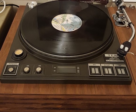

Has anyone had a chance to use the DD Teac TN400 platter here? Magnetic levitation...yes, just like Japanese trains! butoooooo the detractors say that it is not perfect because when it is levitating it can oscillate and rub against the walls of the shaft ..... and the friction of the belt does not rub at two points, the motor pulley and the platter?
Everything is debatable, but I don't like arguments without technical foundations.....the legs of a hippopotamus in the mud....., why not an elephant? , they would be better basses !
