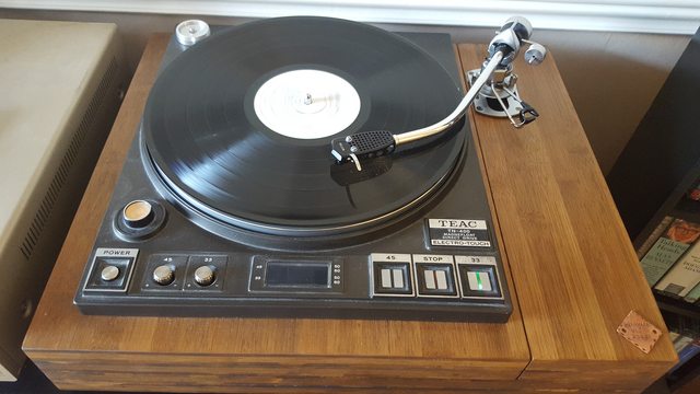

The plate of the Teac TN400 rotated suspended by magnetic levitation .... It was not well known, but I think I am not wrong if I say that it exceeded the SP 10 .....
Giant Killer Turntable - Page 2- Vinyl Engine
Teac TN-400 turntable cool rare vintage ToTL direct drive table (custom base available) - Audio Asylum Trader
