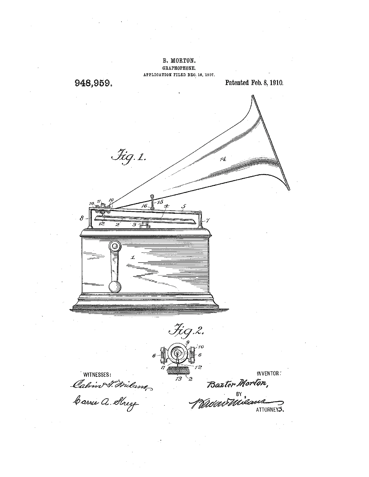

So the reason why was for control from the production side. From the playback side, one needs to recall the "state of electronics" for the period. The pivoted tonearm was the compromise from cost, simplicity etc. A good radial tonearm would have been very expensive.
By “radial” did you mean to say “linear tracker”? Linear tracking pre-dates any “state of electronics” time period. Here’s a 1910 patent (before the transistor was even invented) for an acoustic passive linear tracker phonograph that plays disks, not screw driven cylinders - same basic principle as passive mechanical linears that are built today:
