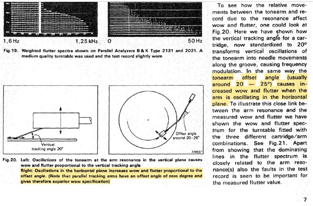

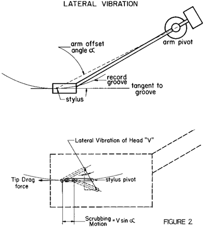

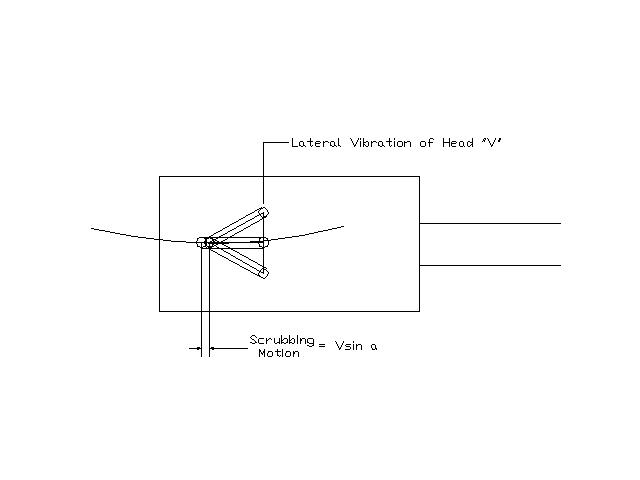

It’s the scrubbing, not the alignment…
The real advantage of linear tracker arms in terms of the topic of this thread is that the zero offset angle of the LT results in less FM/flutter when the arm experiences horizontal resonances. LT arms produce less ‘scrubbing’ of the stylus. Less scrubbing produces less FM/flutter, which shows up as a pitch instability of the turntable.
Offset arm (radial):
Zero Offset Arm (Linear Tracker):
B&K did a study in which they mounted 3 arms on the same turntable and measured wow & flutter for each case. They found that each of the 3 arm/cartridge combinations yielded different W&F values, with the LT arm being the lowest – all on the same turntable (see pages 6-9).
This was discussed in the pitch stability thread. I started a separate thread on the topic here:
Don't listen to records on FM!
but I think I only managed to put everyone to sleep with the gory details. Misalignment doesn’t affect the measured W&F but offset angle does.
