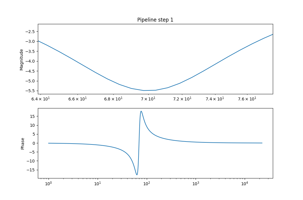

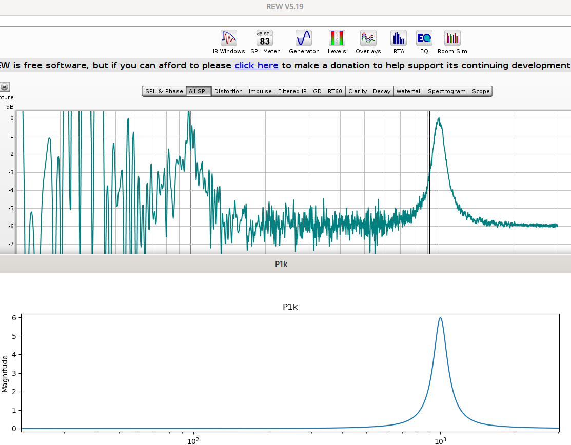

So the issue is simply this: the measured effect of the IIR filters isn't what theory says it should be.
TNT has a point, there are too many unknowns in this to figure out at which stage things go wrong.
I would start by applying a simple config with a single Peaking filter. Then I would try to measure that with REW directly on the analog output, without involving amplifiers or speakers. If that works and produces the expected result, then it's time to add something, like the amplifier. The once that works I would add the speaker and put the mic very close to it (few cm). Finally after that works, it's time to do the real measurement.
You wrote that you had measured on the analog out. Could you show something of those measurements?

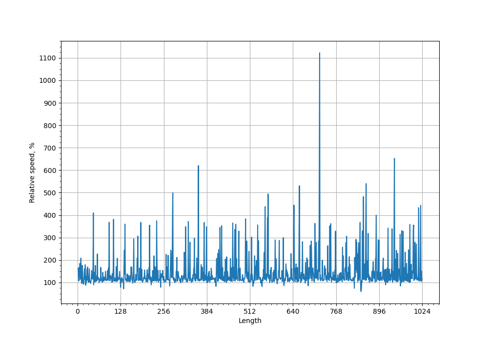

... I have been working on trying to optimize the RustFFT library, and have managed to get some quite nice improvements.
This shows the speed of my new version compared to the current release, for all lengths 1-1024:
The really large improvements are for prime lengths, which aren't really used by CamillaDSP. The power-of-two lengths were already very good so I have not managed to improve them. The benefit for CamillaDSP is when using the synchronous resampler, where conversions between the 44.1 and 48kHz groups should become about 40% faster.

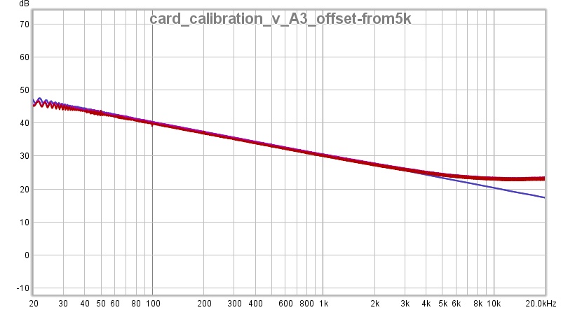

I did that with the loopback test.
Output XLR is connected to Input XLR. Simple.
Did you understand, that's what connecting the output to the input of the sound card does??
That gives you ONE reference channel (say the LH).
In the event I detected a slight 1dB-1.5dB roll off at 19-20khz...
At the same time the amp is fed with the output of the SPDIF, which gives it the stereo output via an (external) DAC.
(so you don't lose your LH channel output, you duplicate it).
That LH channel output is fed to the AMP, then back from the output of the amplifier via a voltage divider network (say 10:1), and now hey presto you can visualise any part of the audio spectra in real time via "scope" or record it as a 24bit audio .wav file LH (original) versus RH (amp playback) for posterity.
This gives you an exact comparison of input versus output of any stage of the process you care to mention,
no unknowns,
what you see is what you get.

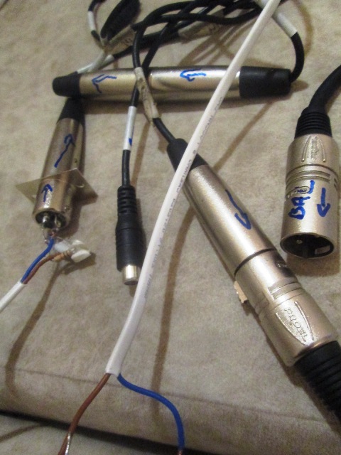

maybe this little photo "simple comme bonjour" will make it clear?
attachment.php
calibrating a sound card + v the amplifier output simply cannot be easier using this arrangement.
Once you have got the Amplifier response sorted and recorded on the sound file (detected a -5dB roll off from 17-20khz), you add the filter via Camilla, perform another scan test, and hey presto you edit the output of that (copy paste) in your favourite stereo audio editor putting that in the RH channel compared with the flat output from the LH channel (which you just got back from the harness above.
You can't get it wrong.
You can do any comparison you want.
Output of amp before and after camilla filter, output of DAC before and after filter, sine wave, square wave anything you like.
You can then compare it with the mic returns.

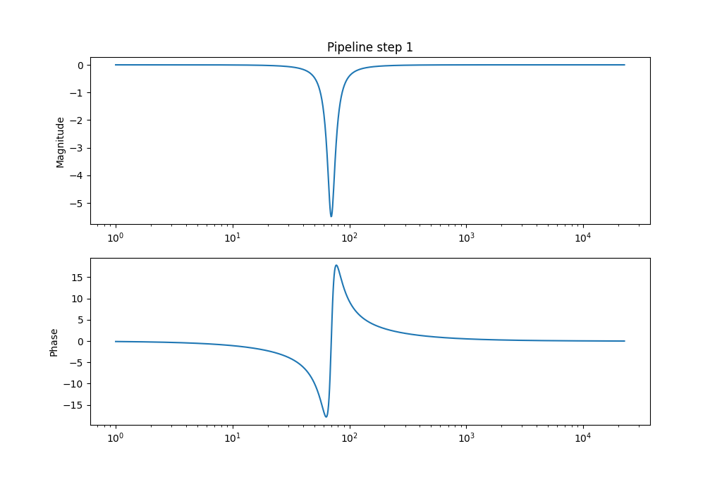

It's still not clear to me what you have actually measured. Can you please show some results from the measurements on the different points in the chain?
I just did a test measurement with REW. The chain was:
REW -> camilladsp -> analog out -> headphones -> mic tucked inside headphones -> analog in -> REW.
This gives "nice" noisy curves that are far from flat, not unlike what one would get when measuring very near a speaker driver.
I did the measurement twice, once without any filters and once with -6dB of gain, and a Peaking filter of +6dB and Q=5.0 at 1 khz. Then I divided the two quite noisy measurements in REW to get the effect of the filter. The result is that I get a full agreement between theory and measurement: rew_cdsp.png
In both curves, the peak is +6dB high and 160 Hz wide.
I would say whatever problem causes the discrepancy in your measurements have nothing to do with CamillaDSP.
About REW. My experience is that it's very solid. It's certainly easy to make nonsense measurements with it, but when used properly the results are reliable.

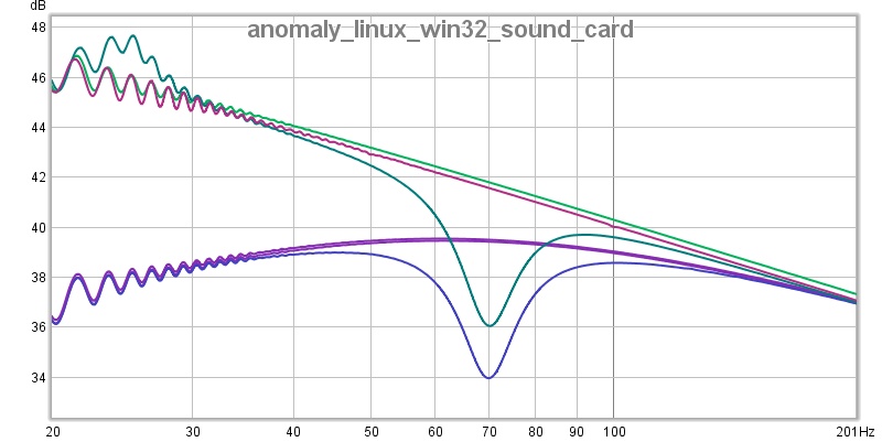

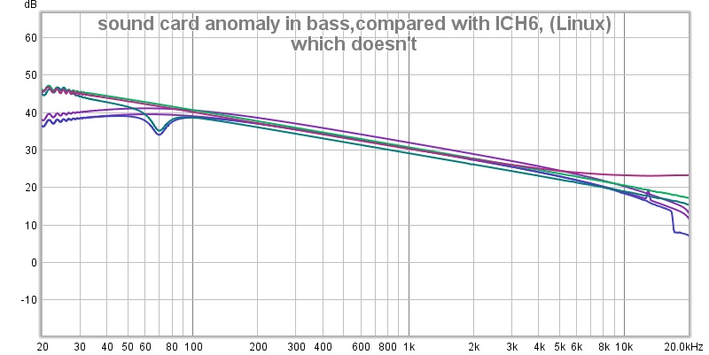

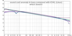

Here is the "give away" graph which was the EUREKA moment, so here we go:-
attachment.php
First we play the scan sys file through ICH6 and record it with VX, (it turns out to be fine), - NO DSP, - just direct and record with audacity. Table flat.
The we reverse it and play the same scan sys file thru VX and record with ICH6. NOT OK.
So here we have a sound card that records perfectly OK, but plays back with a huge roll off below 200hz, but ONLY on Linux.
The ICH6 is flat both recording and playback (but obviously noiser).
I tested with 2 different systems, BUSTER (Jan2021) and Ubuntu 18.04 (quite old).
Same result.
So here was my original question.
How come there is such a big difference between what we program into the .yml file on camilla, and what actually comes out of the speakers?
Here is the answer - about a -5dB anomaly only on Linux, and only in one frequency domain, with a variable response across the whole domain, because of the roll off.
It's one down to the "never assume anything" school!
I don't know why that is.
I can only assume it has something to do with a kernel latency issue or a driver bug, which doesn't exist on win32.
Luckily for me, ALL measurements I did on all speakers were done with win32 (cos I don't use camilla on that), so it turns out they were valid data.
The times we used Camilla, I could sense something was wrong, but couldn't put my finger on it.
How to do a work around for such a crazy situation..?
..well, no worries, really I am simply waiting for my dual sabre dac for the Raspberry pi, which will be here next week.
Hopefully the new HAT, will put us back in "precision" territory at last.
This looks much better, but that downwards slope of the curve looks odd. In this frequency range any semi-decent card should be completely flat, with no tilt.
But that brings a question mark. What is the "scan sys file"? Is it the REW test sweep recorded to wav, or something else? This info was maybe in one of the earlier posts, but didn't find it now
I have just had to accept it's what REW kicks out as a flat response graph for 0dB scan from 20hz-20khz, when you "import an audio file".
Steinberg produces this in a matter of seconds & when you look at it on their program it's perfectly flat.
If you look at this one,where I superimposed the response of the amp on it, there can be seen a clear divergence I measured at +4.5dB max starting at 5-6khz (measured on the DAW).
That I happen to know is specific to the amp and is highly unusual.
On REW it shows as the same amount, but the axis is literally tilted over (not that it really bothers me, at least you have a good idea where things are not flat, or diverge from flat).
TBQH I think REW is totally screwy, because on their last version there were explosions all over the frequency axis too, which made no sense whatsoever.
