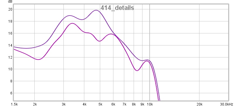

Running the same ancient SENNs for a number of hours, and getting used to the delightful 21st century sound, makes it possible to make a number of important observations.
Remember these were standard issue for BBC engineers for nr 2 decades, so that "sound" formed their "education" and broadcast world.
1/ when you switch back to the "OEM" version it's obvious how harsh it is.
2/ when you compare the 2, (a .yml file "flat" and another one "treated") it's obvious without DSP the headphones have clear evidence of resonant ringing**. It's this constant ringing that introduces heavy distortion in the LF region.
3/ the OEM headphones (BBC HD414) clearly have dynamic range limitations because of the ringing causing the distortion.
When running the DSP driven version the distortion level then drops thru the floor, giving up to 20dB larger dynamic range - that's simply an incredible result.
We have to thank linkwitz** for having tested these headphones decades ago, so that we could get a genuine test.
following his graphs enabled me to make an extremely accurate correction, which is more difficult with other headphones using the "neumann method" - specialised dummy head etc..

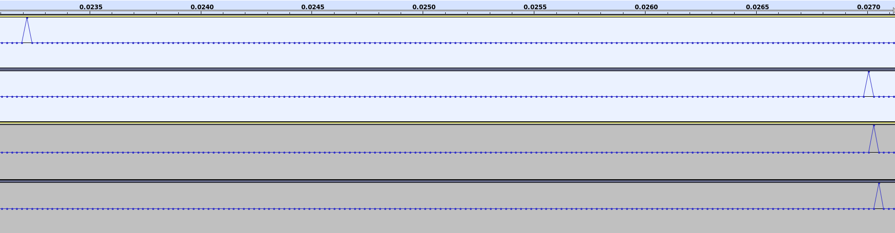

I think I've stumbled upon an unintended limitation. The step size on delay settings appears to be 0.1 ms, which unfortunately is too course. I discovered this because whenever I made small increments from 3.80 ms to 3.84 ms nothing would change in the REW impulse measurements, but when I changed it to 3.85 ms, REW suddenly showed a change from 3.80 ms to 3.90 ms. This limitation sadly means that I cannot time align my speaker drivers to the degree that I need.
Since 0.1 ms corresponds to a rather large offset distance of 3.4 cm, a step size of 0.01 ms is needed to allow for proper time alignment. I noticed that MiniDSP also allows for this granularity.
I tried the delay now and don't see any problem.
I used a mono signal with a single spike, and used a mixer to get 4 channels. Then I left one channel untouched, and delayed the others with 3.80, 3.82 and 3.84 ms.
All three delayed channels end up where they should:

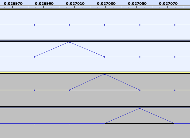

Zooming in:
This was done at 44.1kHz, so the steps of 0.02 ms corresponds to a about one sample. The spike is delayed as expected.

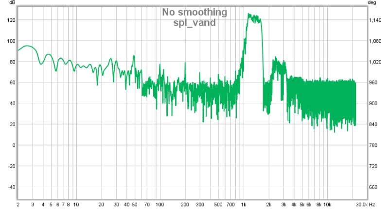

Next marathon is arriving this weekend.
Vandersteen, nice crossover mess.
I checked and YES this is where the crossover is.
We will have a play with camilla again for this one.

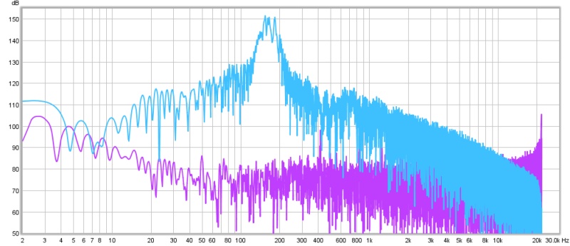

Well OK, thanks for the bit about attaching images.
I don't do things quite the classic (amateur) way, so my DAW records the system scan 20-20khz via studio mics such as DPA, or in my case Neumann KM series, (not an "impulse" response at all).
Some people like doing "old school" which works equally well and doesn't need a computer at all.
[In pro hall acoustic scenarii, my Prof friend used to use bursting balloons on concert hall stages for impulse, use a pro HP calibrated SPL microphone - which costs a lot, then put it through his old HP pocket device, which spat out .csv files dead easy, - all a real smart idea).
Many people may not be aware because of night club and pub venues having noise limits, we have been doing this sort of work for some decades now.
DPA mics have much higher output, so setting 0dB level can be a tad complex editing the final complete .wav files.
However, of course REW is quite capable of displaying the entire FR scan,- which I just realised only this week.
This shows up peaks and troughs like a dream, inc the same when recording a trace of a load resistor on the end of the amp, -
then a voltage trace off the speaker terminals using program "scope" works very well with a voltage divider network (ie. a couple of 10k + 90k/100k resistors works perfectly for that to spit the attnuated signal direct back into the pro sound card....),
And then finally you can measure the last one - what you get back off the DPA mics compared with the signal output from the DAW to get comparisons from A-Z.
Once you put the corrected signal from camilla back through the DAC, that peak on the vandersteen (1.3-2khz) can be erased, -
but the peak out of the amp on the RHS (150-190hz) I would prefer to knock out with a plain ordinary band stop RC filter and a little switch on the rear panel.
Horses for course and all that...
I'm not sure you follow quite all my methodology but it works rather well.

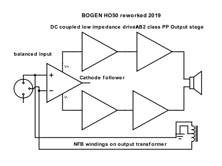

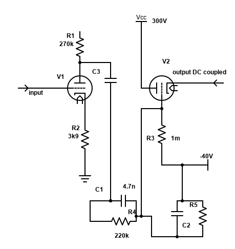

In effect the amp peak problem should be doable as follows..
will take a bit of fiddling around with values no doubt. :D

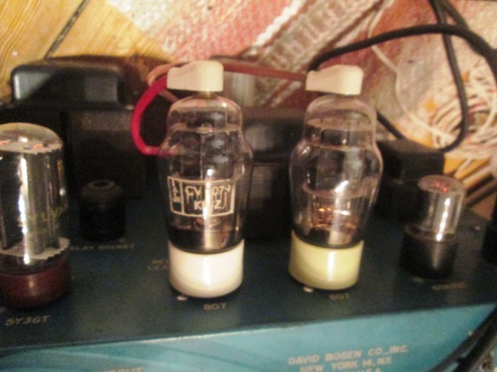

One of the fascinating dealing with valve amps, especially vintage ones, is the interesting way they interact with both bi wiring and variable speaker driver impedances.
I have signal traces which really do show such things happening. The load presented (inductive v capacitive) really does have an effect on the sound.
Directly coupled devices running in the A2/AB2 condition have a very different behaviour from what most people are used to, and they certainly don't sound anything like solid state ones. (we tried).
The transformers are 70yrs old, and I am reluctant to change them, as it's highly possible they are only to blame for the HF roll off.
After extensive audition recently, we became aware of a certain "harshness" I could not explain neither from extensive measurements which included THD & IMD tests, and tests at certain power levels with certain speakers & certain codecs such as mp4 (H264) & particularly the horns in JBL. (which we will soon see analyse and verify tomorrow).
Before going mad with Camilla which brings its own crop of massive phase shifts...I wanted to "do it my own way".
Sherlock Holmes situation, "elementary my dear Watson" merely a process of elimination.
Excuse the circuit details which some may not be familiar here. it's quite "old school".

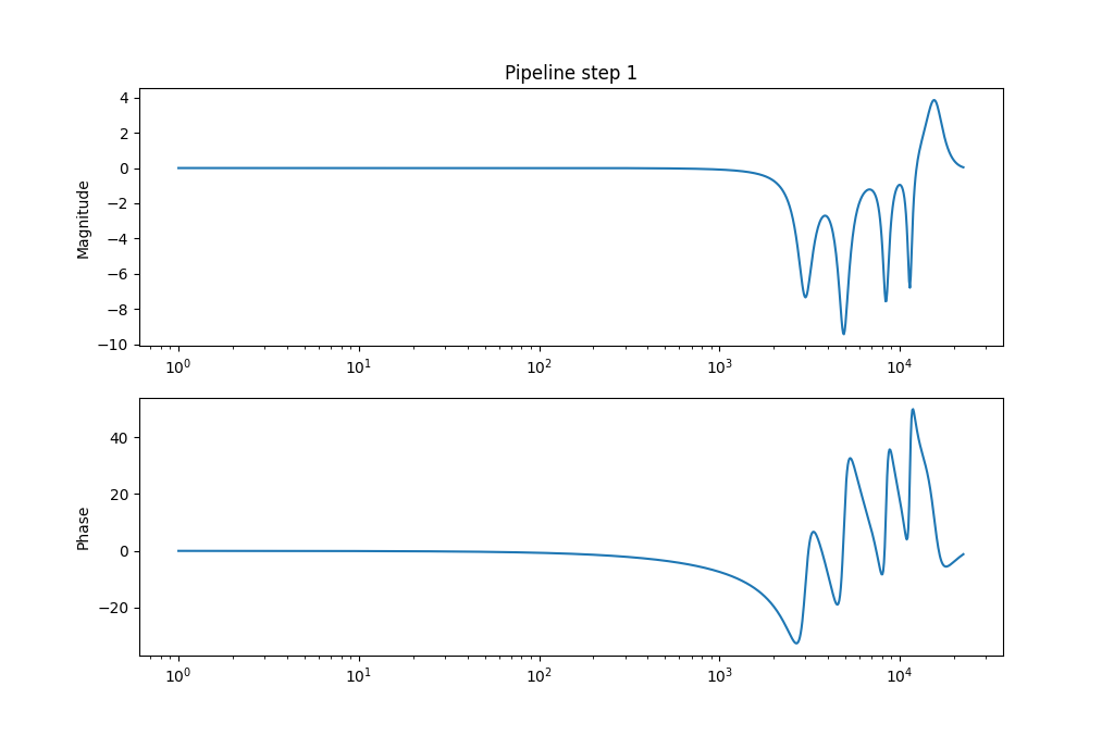

Right, the marathon is over.... This should be a lot of interest to those using the DSP.
I did 2 tests all over again, using Neumann microphones as my basis, on both speakers and headphones.
It seems my old version of REW spat out garbage instead of correctly analysing scan traces and making them into clear graphs. I had to get a newer version, then work from there...(as the stuff I posted here before turned out to be largely invalid huh!) :rolleyes:
Now, as Camilla is now spitting out lots of nice graphs thanks to python, I thought it sensible to give some feedback from the results.
Unfortunatlely it's more complicated than that, which involves a lot of inspired guess work and listening carefully to the results...
Basically what you see, and what you program into the .yml file is not what comes out of your transducers.

To help me in this I continued to play with my old Sennheiser HD units to see what I could do to improve on what Linkwitz had done. (It's a lot easier than fooling with large rooms and reflections!)
From what I see linkwitz idea was successful supressing resonances up at 8 & 12khz, which were causing the capsules to produce nasty artefacts lower down.
I did what you are never supposed to do, and put the mics direct into the headphones to measure what was actually coming out.
It turns out there was an extra really nasty peak at 5khz.

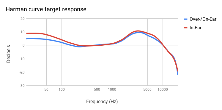

Ignoring Harman seems to be the best method here!
922812d1613416134-camilladsp-cross-platform-iir-fir-engine-crossovers-correction-etc-ex_z4f1u8aa8v6_-png
So what I get from Camilla trace looks like this:-
922816d1613416134-camilladsp-cross-platform-iir-fir-engine-crossovers-correction-etc-latest_pipeline_step_15feb-png
While what I get back from my measurements direct from the SENNS with 10s, 20hz-20khz scans from mic recording direct then stuffed into REW looks like this..
The top trace is with NO DSP, the bottom using the DSP trace above.
Not the notch at 8400...that helps get a handle on the (rather cryptic) relationship between the 2.
The 7dB stab we get at with camilla gives me only 2-3dB real..see?
922815d1613416134-camilladsp-cross-platform-iir-fir-engine-crossovers-correction-etc-414_correction_strategy-jpg
Obviously when it comes to doing speakers and comparing them it becomes a good deal more complex.
That at least enabled me to get a trace on 2 ostensibly identical Vandersteen speakers which were not identical at all.... :rolleyes:
