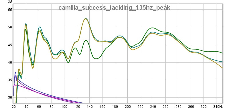

I used a "q" of 6.2 and a dip of -9.9 to tame a combined driver resonance at 135hz, because all attempts around -3 to -5dB had little effect.
(which as luck would have it was only on ONE channel).
That as you can see on the graph eliminated it..but about -8dB out compared to nr -10dB on camilla, followed by a sharp dip due to the phase reversal caused by the IR filter.
attachment.php
I am well aware the "Q" value is related to 2sq/rt so that 1.414 = 1 octave. In this respect 1 octave at LF is a very different affair from 1 octave at HF.
In effect it means a "Q" of 2.8 is 1/2 octave and so forth.

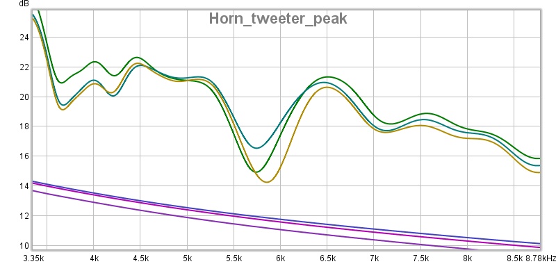

I can see Camilla works because I made a mistake trying to remove a horn tweeter resonance at what I thought was just below 5.9khz..as you can see.

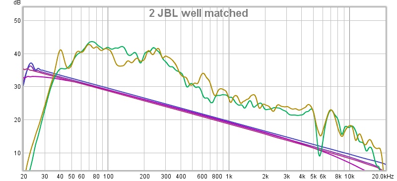

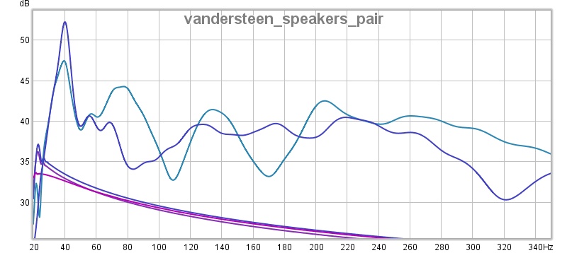

Something much more funny, the JBL pair are a close match, whereas the much vaunted Vandersteen 3 ("we set each one perfectly in an anechoic chamber") is all over the place to the extent I suspect defects in components...and terrible quality control.
My microphones showed me clearly from REW, the resonance wasn't there at all in my own horn tweeter. (-4db 5650hz "Q" 3.9), it was clearly some 900hz higher at 6.5khz...oops! You can see it on the graph.

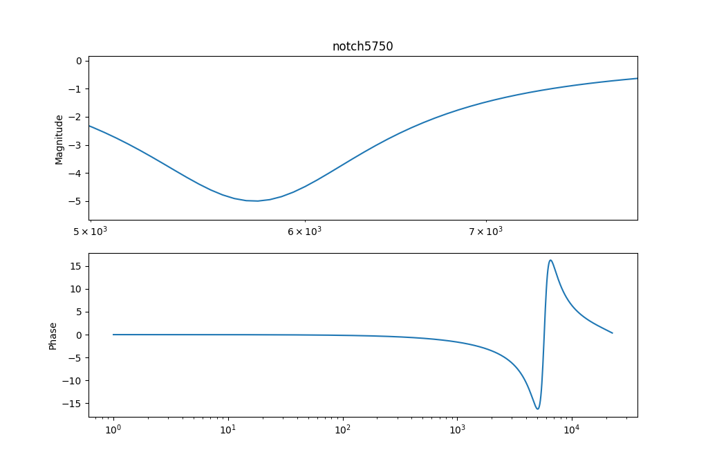

However at this HF range the camilla notch of -4dB results in an actual -7dB notch, plus an abrupt +/-30 deg phase reversal, which add to the interesting effects using a simple first order crossover.

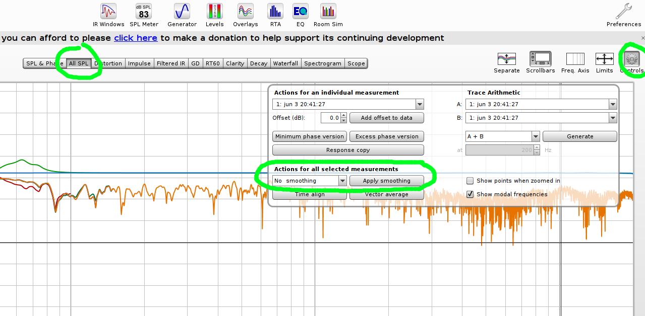

Trying to work this out through the mess of a speaker with it's peaks and dips plus another set of dips and peaks from the room will be very difficult. Can you try measuring directly on the analog output, without any speaker or power amplifier in the path?
Also the curves in REW look too smooth. I think there is still some smoothing applied. Can you turn that off? Click the "All SPL" button at the top, then select "Controls" and in there select no smoothing and apply. No need to remeasure for that.
well if you do that, you get so much gobbledeegook, you get lost in a mountain range.
Using a 1/12 smoothing, at least makes the graphs readable.

What was even more suprising was to see how BAD & inconsistent the Vandersteens were compared with the JBLs, (which were essentially the same speakers as a pair).
This to my mind with the strong dips in the 100-250hz range is why the Vandersteen is nigh on useless for certain types of music.
I tried to correct to for this with Camilla,and it immediately made them sound brighter and better...
In our back to back test of the JBL (basically a studio type monitor), against the pair of Vandersteen 3, we were trying to find out, why the VAND speakers sounded basically crap in rock music, but good for classical/Jazz, while the JBLs were completely the reverse.
