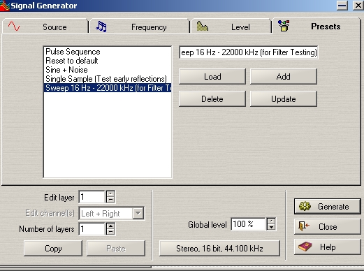

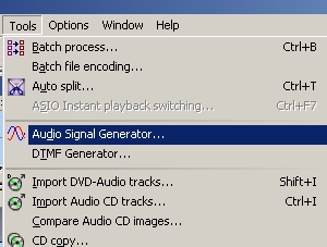

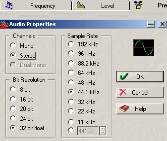

How did you create the wav?
Here it is- dead simple:-
I have been using this for years.
It works.

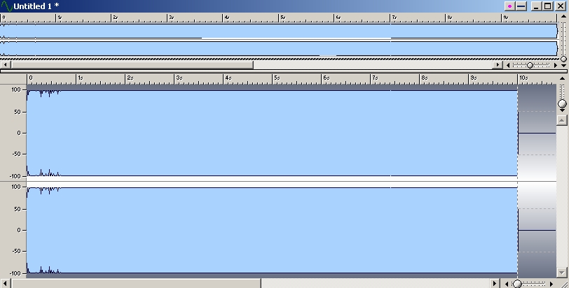

The little "glitches" you see above are in fact just display difficulties. There are no problems at all with the file.

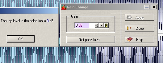

I analysed levels recorded with Steinberg on each occasion to be sure. You can use their FFT tool to confirm the results of any notch & check levels.
They are 100% valid.
I have no doubt whatsoever measuring mic levels & loop back tests from both external DACs and with input connected to the card's output with their program is 100% correct.
I do,who knows what happens if you add a delay or anything else>
Steinberg confirmed the recording levels. When you copy+paste the reference scan file in the left channel, and put the recorded audio file in the RH channel. You then have an exact comparison in one stereo file.
When you play back files, the levels are displayed in the "master" section playback read out in real time.
If there is any variation you will see it instantly.
This is what REW SPL says once you size it up to display 20-20khz and make some sense of it with the +/-- scale bar on the top LH corner:-
In practice any comparisons of levels I have made with it, I always align at identical levels (for what it's worth) at 1khz.
It is REW that is manifestly blatently incapable of dealing with importing a professional .wav file properly, and/or displaying it correctly.
It displays this ****-eyed graph, although the levels shown are in fact correct.
I stand by that.
What you see is what you get.

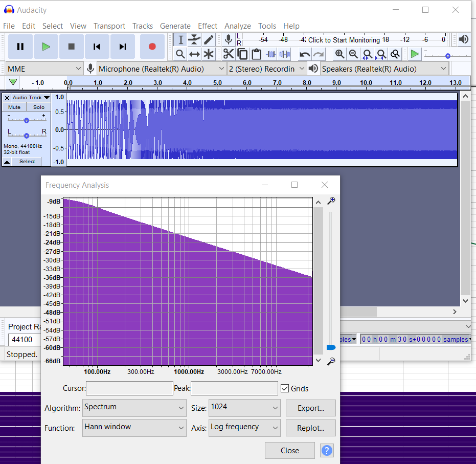

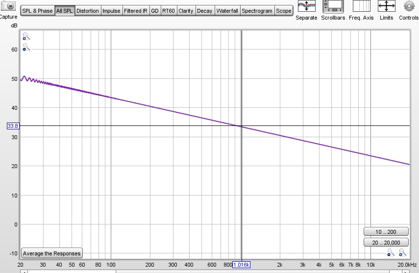

That can't be right, the fact that it produces such a tilt means it's not interpreting the imported wav correctly.

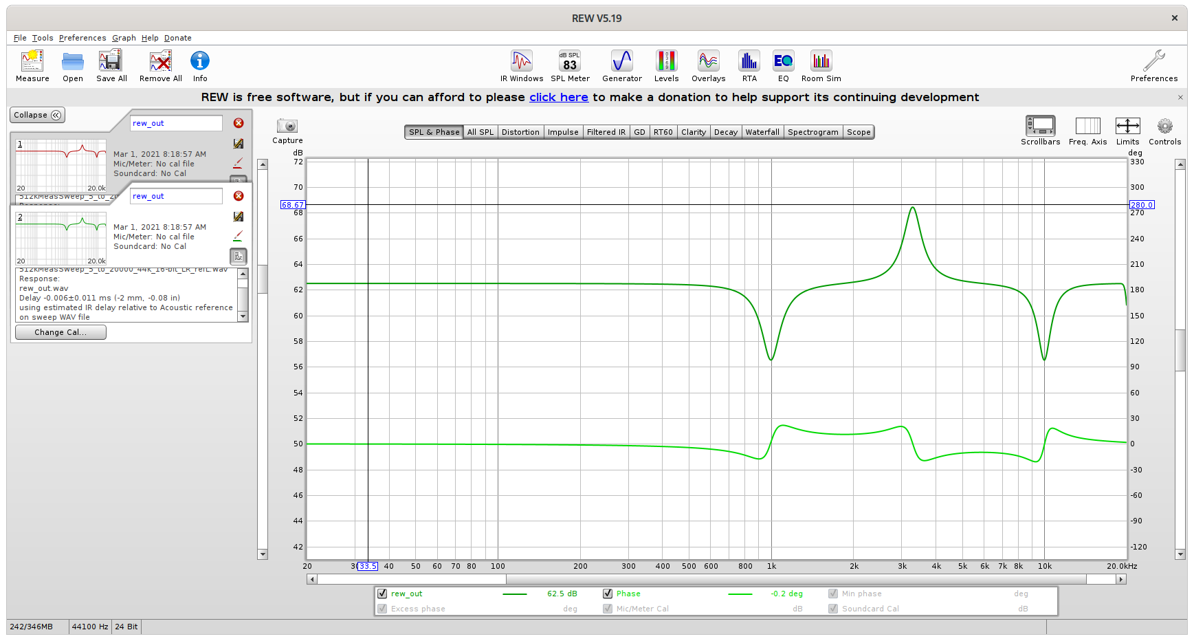

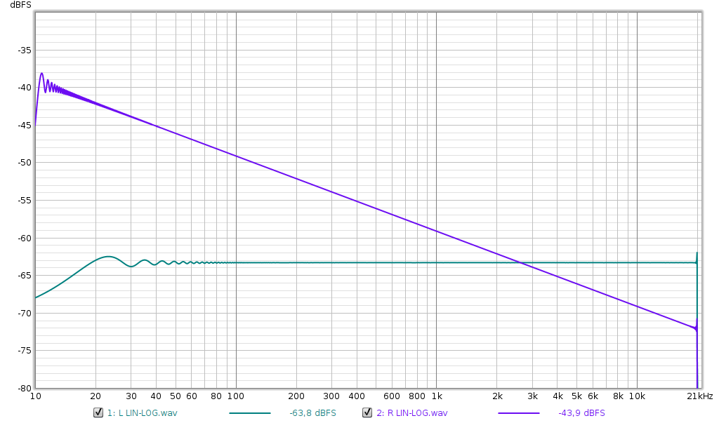

It is actually interpreting the file correctly, here is an example of a 16 Hz to 22K log sweep generated with Audacity and the Frequency analysis of it. REW gives exactly the same when imported as audio.
A sine sweep and recorded response can be loaded into REW from the import sweep recordings option but it only works with sweeps made by REW's own generator.

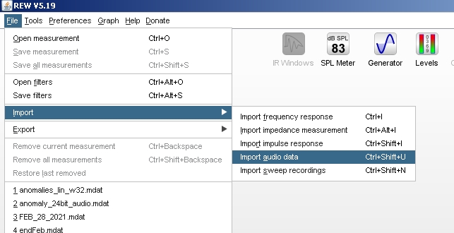

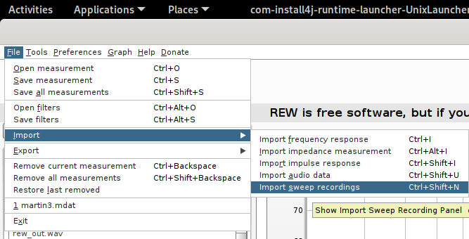

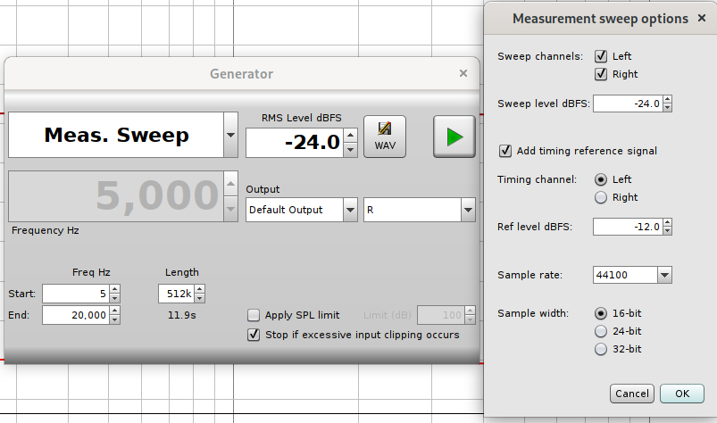

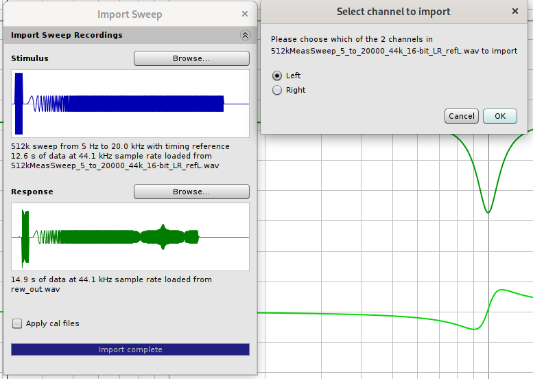

REW is a tool, and like any tool you have to use it properly. I think perhaps also the professionals need to read the documentation 😉
To get the proper timing info etc it needs to use it's own sweeps, which have timing marks needed to get the absolute delay right.

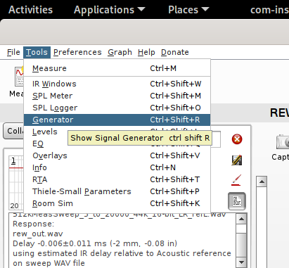

Here is the procedure to make proper measurements:
Step 1: Generate the sweep with REW itself.
- Go to Tools/Generator
- Set it to Meas. Sweep, and enter suitable datails below. Click the WAV button, make sure the "Add timing reference signal" is checked. Ok to save as a wav.
Step2: Make your measurements.
Step3: Import measurements into REW.
- Go to File/Import/Import sweep recording
- Click "Browse to select the previously exported wav in the upper box, select the Left channel (this is where we put the timing reference)
- In the lower box, do the same but select the recorded measurement instead. Also pick left channel.
Then REW will import and show exactly what it should.

Linear vs. logarithmic sweeps 4M samples long (generated in audacity), analyzed by 4M FFT in REW (in linux of course).
Logically a log sweep will have less energy in the higher bins of the linearly-spaced FFT (which REW and most other packages do). FFT can be computed with log-spaced bins e.g. in matlab/octave.
