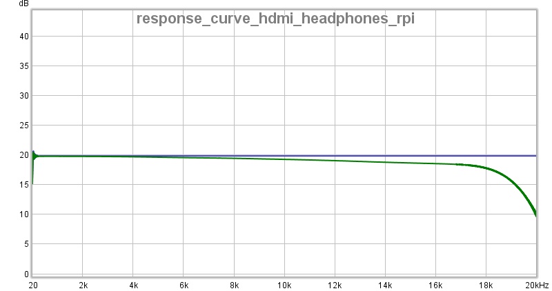

OK, we fixed it.
Rew displays the DSP corrections exactly as it should.
The return measurements are edited elsewhere, and a quick run was done.
The whole running "REW on linux" Java8 problems esp with the latest distro "Buster", all turns out to be a waste of time.
Running Camilladsp on ARM64-Linux* works reliably 24/7 without any glitches.
I don't need AMD64 at all.
Arm64 + camilla all start auto as a services, as does VLC, plus the whole test sequence can now be fired up via the web interface of VLC, and uses about 4-5W of power.
Which means it can be left for a day on a car battery without making it impossible to start the engine 24hrs later.
(this makes it possible to run the whole box & make measurements in a car - a sine qua non of the whole op.)
attachment.php
Measurements run fine on win32, and the results now display fine in REW.
QED. 😉
Here are the headphone correction graphs which started all this off.
The corrections on the yml file are visible enough to be able to know what to do with the "Q" factor and resonance Frequency nulling to be able to refine the graphs properly. 🙂
NB:- *Arm64 Linux (debian) on Raspberry pi, was considered quite "bleeding edge" until last autumn.

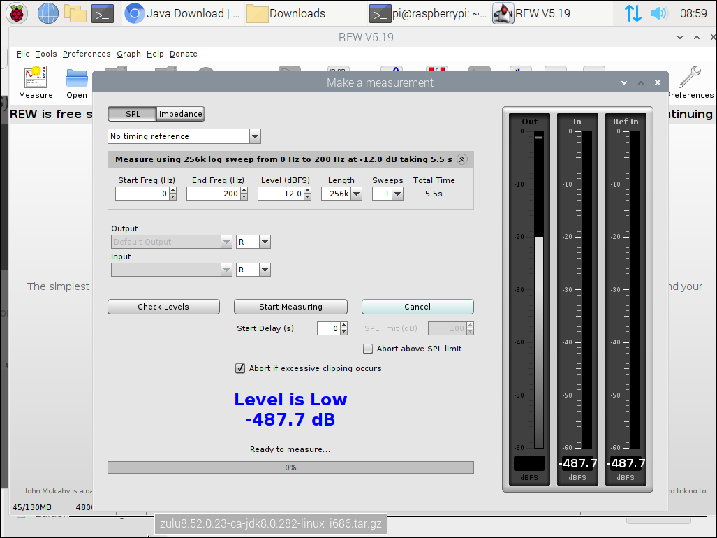

Final note on REW on linux, then let's drop this topic.
Here is a picture of REW running on Raspberry Pi Desktop (i386) in a virtual machine on my laptop:
I got JRE8 from the link xorcz posted, followed the 2-line instruction for installing it, and then downloaded and installed REW. Done.

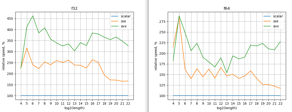

If someone is wondering about the lack of updates to camilladsp lately, the reason is this:
I'm working on implementing SSE support in RustFFT. The graph shows the speed for power-of-two lengths compared to the standard non-simd implementation (blue curve at 100%) as well as the existing AVX implementation (green curve). The new SSE code is the orange curve.
RustFFT can already use AVX for a major boost, but obviously only on cpus that have AVX. Atoms, Pentiums etc don't. Once this is merged into RustFFT, then systems with these cpus will get a nice boost in convolving and resampling speed.
Later, this will be quite simple to port to Neon. But before that the Neon support in Rust must be improved. At the moment there are too many important instructions missing.
