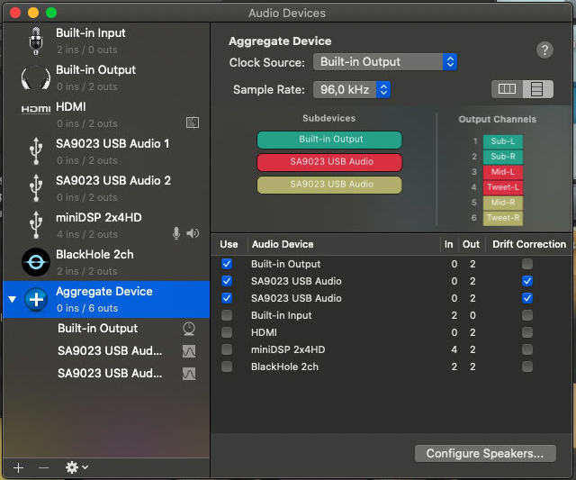

Attached screenshot shows the "Audio MIDI Setup" application with the "Aggregate Device" and as you can see the "Built-in Output" is defined as "Clock Source" and the two USB DAC's will be drift corrected.
Alright! As I understand it, the aggregate device sends the signal straight to the clock master device, and uses asynchronous resampling to sync the others to the master. In this case the two USB dacs lock to the USB clock, so they will be nicely synced with each other. They will probably drift a little back and forth compared to the headphone output, would be really nice with a measurement of that!As a prof of concept I have used
It's a smart move to put the tweeter and midrange of each speaker on the same dac. That means the most critical part gets the best sync. You can live with much larger drifts between the left and right speakers, and to the woofers.
Well tough luck. Prof of concept meets full on reality of a controlled listening environment.
It turns out that the "Aggregate Device" is not capable of keeping USB DAC's in reasonable sync - resulting in a very unstable stereo image.
So I must say that this will probably only work if I get a 4 (or more) channel USB DAC - where the individual channels are all synced to the same internal clock and only takes input from one USB interface / stream.
An Okto Research dac8 Pro will probably work wonders - Okto Research - but that will have to wait 🙂
So for now it CamillaDSP will act as a two way filter between Subwoofers and MiniDSP 2x4 HD (for mids and tweeters)
Your earlier post said it sounded really good over two days of listening yet this sounds like it clearly failed. Can you elaborate a bit more on what didn’t work and how you reached your conclusion.
Bit I’m particularly interested in is whether the USB devices stayed aligned with each other as it would really widen the options if I didn’t need a multichannel dac for my actives.
