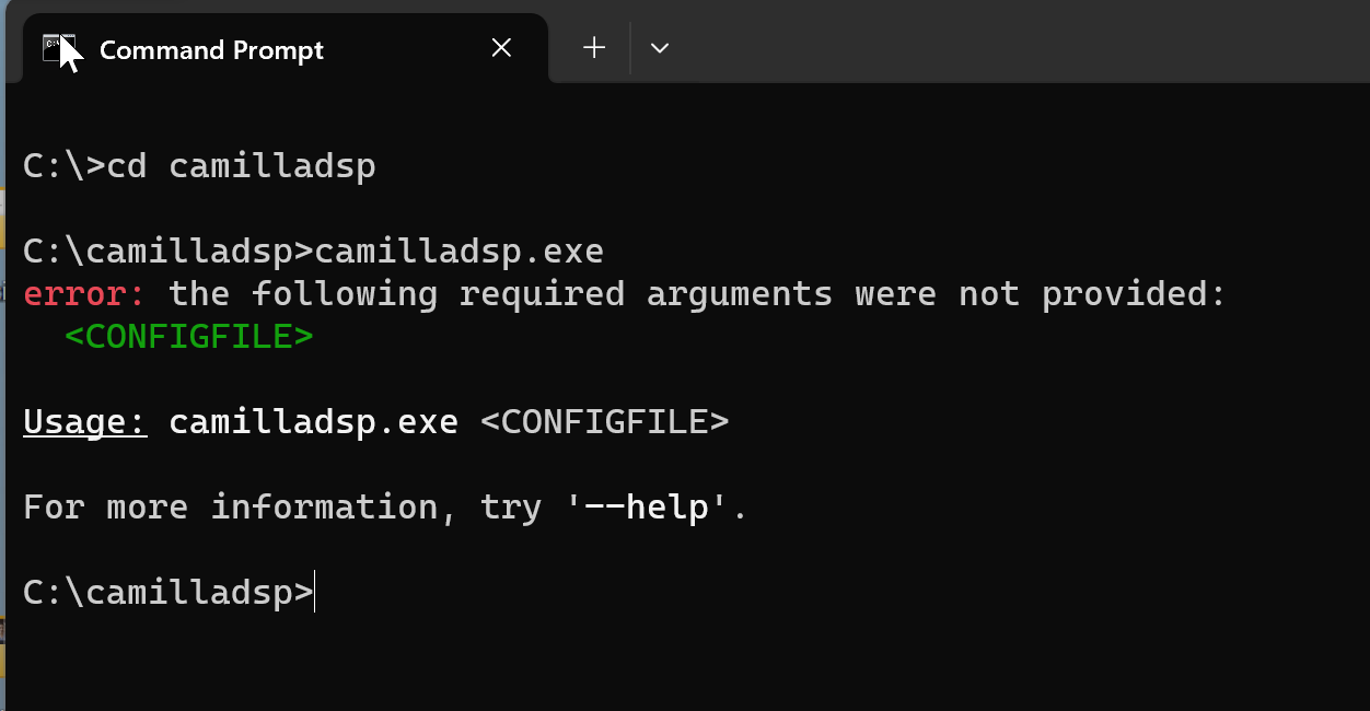

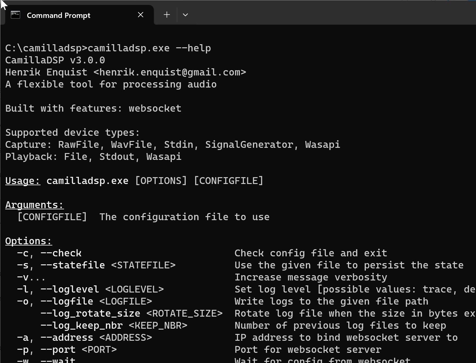

Have you been able to start camilladsp.exe from a Windows Command Prompt?

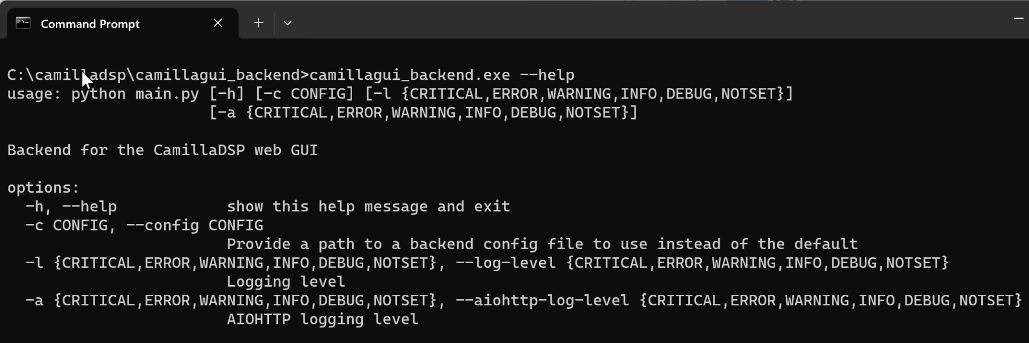

This is the equivalent for camillagui_backend:

You shouldn't need to run as admin. If you create a "camilladsp" directory in your home directory, and inside that create directories called "configs" and "coeffs", then the backend should start ok. You don't need to create a state file, CamillaDSP will create it if it doesn't exist (when you use the -s argument).When I start camillagui_backend (as administrator)
Services are nice for starting this ngs automatically after booting, but it's better to start without and then set up services once everything works. I have only added example service definitions for Linux so far. Windows and macOS are still on the to-do list.
Try starting the backend from a terminal instead of double-clicking it. That makes it much easier to see error messages. Once that works, then you can double-click instead.
camilladsp.exe needs to be started in a terminal, double-clicking will only open a terminal and close it again before you have time to read anything.

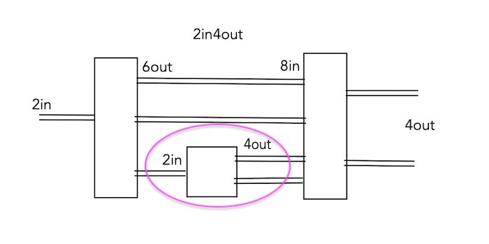

Could you consider support for where one mixer could take the input from more than one mixer as long as the sum of channels coming from the n+1 inputs is equal to the number of in-channels?A mixer must always accept all the channels in the pipeline, so the middle mixer must be 6-in, 8-out. Just let the input channels 1-4 map 1:1 to output channels 1-4.
This would facilitate to build a structure that internally fan out in a local branch that could entail some common local filters that only effected the rest of the local branch. If not, the common filters would need to be repeated for every "local branch"...
I assume the import/translation functions is not trivial and maybe the train has left for these kind suggestion... all is of cource still doable...

This would be very hard to configure, and complicate the pipeline. But you can do something that is pretty much equivalent, if the middle mixer has 6 inputs and 8 outputs. The upper four channels will then just be passing though the middle mixer instead of going around it.Could you consider support for where one mixer could take the input from more than one mixer as long as the sum of channels coming from the n+1 inputs is equal to the number of in-channels?

I would like to add something like this. The issue is just that it's quite hard to do right. Not too bad for simple pipelines with no more than one mixer, but with two or more mixers, then there can be multiple paths between a pair of input and output channels, and that's when things get really tricky. Maybe some day 🙂Would it be possible to draw a system estimate of the gain structure and headroom for an input channel
