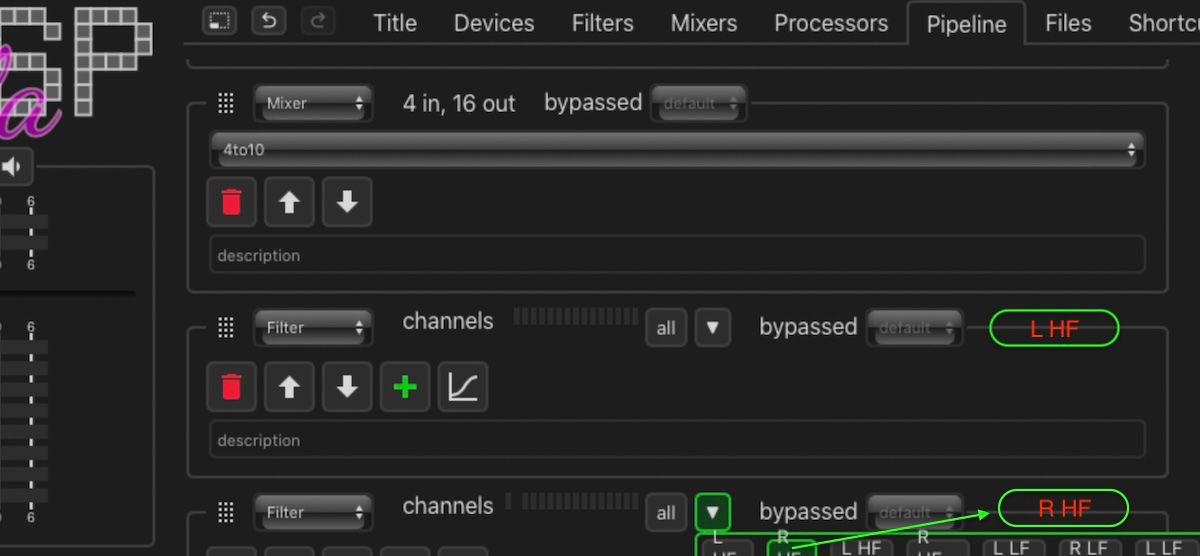

I think that the Pipeline view could show the Channel name without having to open the down pointing arrow menu. By just scrolling down one should be able to find the right section to add a newly created filter without any interaction. When dealing with larger configurations this becomes a sewing issue if not... Preferably placed more to the left than my sketch... Leftmost possible I would say...
It shows all channel names up to 8 channels. When there are more, it takes too much space, so it switches to a more compact view with the indicator bars (which looks wrong in your screenshot, the selected channel should have a bright green little bar, not black) and the dropdown. It's not easy to make something that works equally well for everything from stereo to big interfaces with 30+ channels...I think that the Pipeline view could show the Channel name without having to open the down pointing arrow menu.
Aha OK, if more then 8 channels , it goes to the green bar layout instead - got it! Makes sense.
