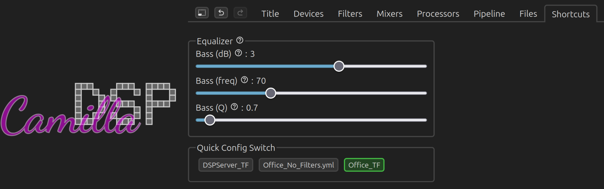

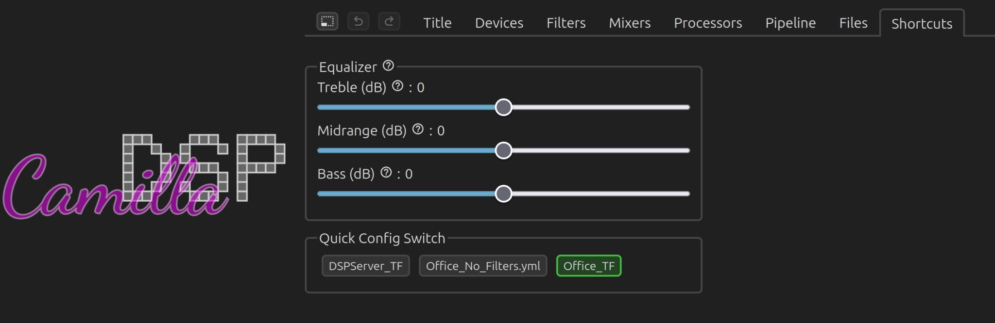

Does anyone have a template for a 3 band 'channel strip' type eq for the shortcuts? Was about to work out how to make one but I'm feeling lazy!
Simple to do. In gui-config.yml there already are shortcuts for "Treble" and "Bass". Add one more for "Midrange". Here is how to do so:
1. Open your gui-config.yml file. Under "shortcuts", add the following.
- name: "Midrange (dB)"
config_elements:
- path: ["filters", "Midrange", "parameters", "gain"]
range_from: -12
range_to: 12
step: 0.5
Save and exit.
Note: My gui-config.yml is located in /opt/camillagui_backend/_internal/config/. Yours may be different, depending on where you installed the camillagui package.
2. Reload and restart your camillagui.service:
sudo systemctl daemon-reload
sudo systemctl restart camillagui.service
3. In the Filters tab of the GUI, create the filters you want controlled by the shortcuts. Name them "Bass", "Midrange" and "Treble", respectively. Note that the names MUST match the names defined in the respective path statements under shortcuts in the gui-config.yml file.
4. In the Pipleline tab of the GUI, add the filters you just created and assign them to the channels you want them to affect.
5. Select "Apply and save", refresh your browser, and you should have it.
Here is what it looks like:
config_elements:
range_from: -12
range_to: 12
step: 0.5
Save and exit.
Thanks, I'll give it a go. What I really wanted was a Q and frequency slider for each range. Is that realistic?
Yes.
- name: "Bass (dB)"
config_elements:
- path: ["filters", "Bass", "parameters", "gain"]
range_from: -12
range_to: 12
step: 0.5
- name: "Bass (freq)"
config_elements:
- path: ["filters", "Bass", "parameters", "freq"]
range_from: 10
range_to: 200
step: 1
- name: "Bass (Q)"
config_elements:
- path: ["filters", "Bass", "parameters", "q"]
range_from: 0.1
range_to: 15
step: 0.1
EDIT: You may need to adjust your tabs/spaces above. They get removed when I post.
EDIT 2: I forgot to change "Midrange" to "Bass" in the path statements above. It is corrected now.
- name: "Bass (dB)"
config_elements:
range_from: -12
range_to: 12
step: 0.5
config_elements:
range_from: 10
range_to: 200
step: 1
- name: "Bass (Q)"
config_elements:
range_from: 0.1
range_to: 15
step: 0.1
Your welcome. Please see the changes I just made. I had forgotten to change "Midrange" to "Bass" in the path statements above. It is corrected now.

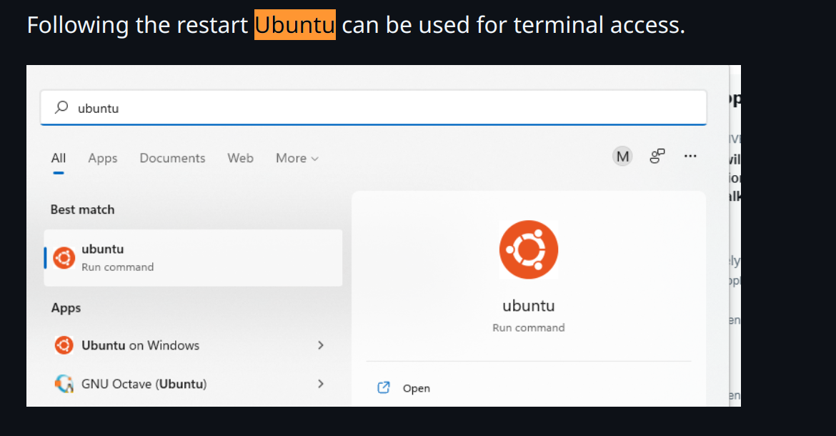

I followed this tutorial, as have many. It is very good.I recently downloaded a binary copy of camilladsp V3 for my recently-acquired RPi5.
https://github.com/mdsimon2/RPi-CamillaDSP
The only difference is that I used Raspberry Pi OS Lite instead of Ubuntu. It is lighter on resources and does not include a lot of packages that Ubuntu installs that you will not need if only using your RPi for DSP.
To install Raspberry Pi OS Lite, in the Raspberry Pi imager, after you select "CHOOSE OS", then select "Raspberry Pi OS (Other)", then select "Raspberry Pi OS Lite (64-bit).
The published binary for 64-bit Arm is built with everything left at default. There only reason to compile yourself for the pi 5 would be if you want to add support for Pulseaudio, Bluez or Jack.what compiler options were used to create the binaries?
I think that tutorial is also using Rpi OS. mdsimon abandoned Ubuntu a time ago if my memory serves me right.I followed this tutorial, as have many. It is very good.
Click on the link and check it out. Your memory is not serving you correctly or, perhaps, he changed and then changed back, I don't know. 🙂I think that tutorial is also using Rpi OS. mdsimon abandoned Ubuntu a time ago if my memory serves me right.
When I migrated to GitHub (05/2024), I added instructions for Raspberry Pi OS -> https://www.audiosciencereview.com/...amilladsp-tutorial.29656/page-90#post-1983838.
Earlier this year (01/2025) I removed all references to Ubuntu Server and now the tutorial only covers Raspberry Pi OS -> https://www.audiosciencereview.com/...milladsp-tutorial.29656/page-115#post-2211585.
Michael
I now see. The references to Ubuntu is for are using it to run the Imager and to SSH into the Pi, not for the installation of Ubuntu onto the Pi. My mistake.When I migrated to GitHub (05/2024), I added instructions for Raspberry Pi OS -> https://www.audiosciencereview.com/...amilladsp-tutorial.29656/page-90#post-1983838.
Michael

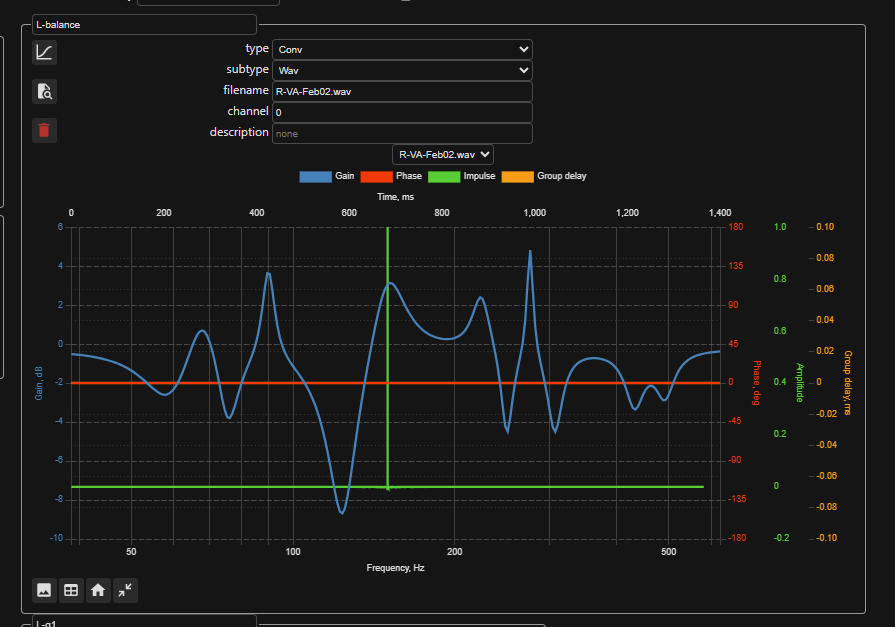

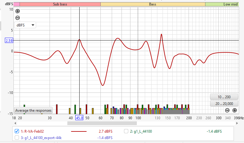

Hello
I've been struggling for about a week with a change in filter visualization. I am designing fir filters which until recently worked well.
I am using Moode 9.2.5 with Camilladsp 3.0.0 and REW 5.20.14. It is possible that this behaviour is due to Moode/Camilladsp upgrades but seems unlikely.
Plotting of wav conv files in camilladsp does not match my own plots of my filters or REW. If I create a filter as wav, I can import it into REW and it plots correctly as per my REW filter design. When I plot the same filter in camilladsp, the Fc of the filters is shifted. At 44100, it shifts about double the Fc of the designed filter. Other Fs results in different shift amounts in camilladsp. There may be a complex relationship but I dont know what it is. I also took an old Rephase filter at 48000 and imported that into REW and it plots correctly. But in Camilladsp it shows shifted Fc's. I also exported one of my filters from REW try to rule out that it is my wav generation that is causing the problem. It too shows Fc shifts. I have analyzed my filter odd taps symmetry, impulse alignment, and no joy. There is one more issue I am experiencing with REW which may or may not be related. When I inport a filter that I create into REW, the group delay overlay plot does not appear for many, but not all filters. I have to go into the left measurement files selector and once I click on the filters it immediately shows in the GD overlay. I havent been able to figure out this one either. Does anyone have any suggestions on solving the plotting?
Cheers.
Cheers.
What is the sample rate set to in the devices tab? The filter plot uses that and ignores what the file was made for (same as the CamillaDSP engine does). For raw files that doesn't cause any trouble since they don't contain any info about sample rate or anything, but it can be a little confusing for wavs, where the sample rate is ignored.
