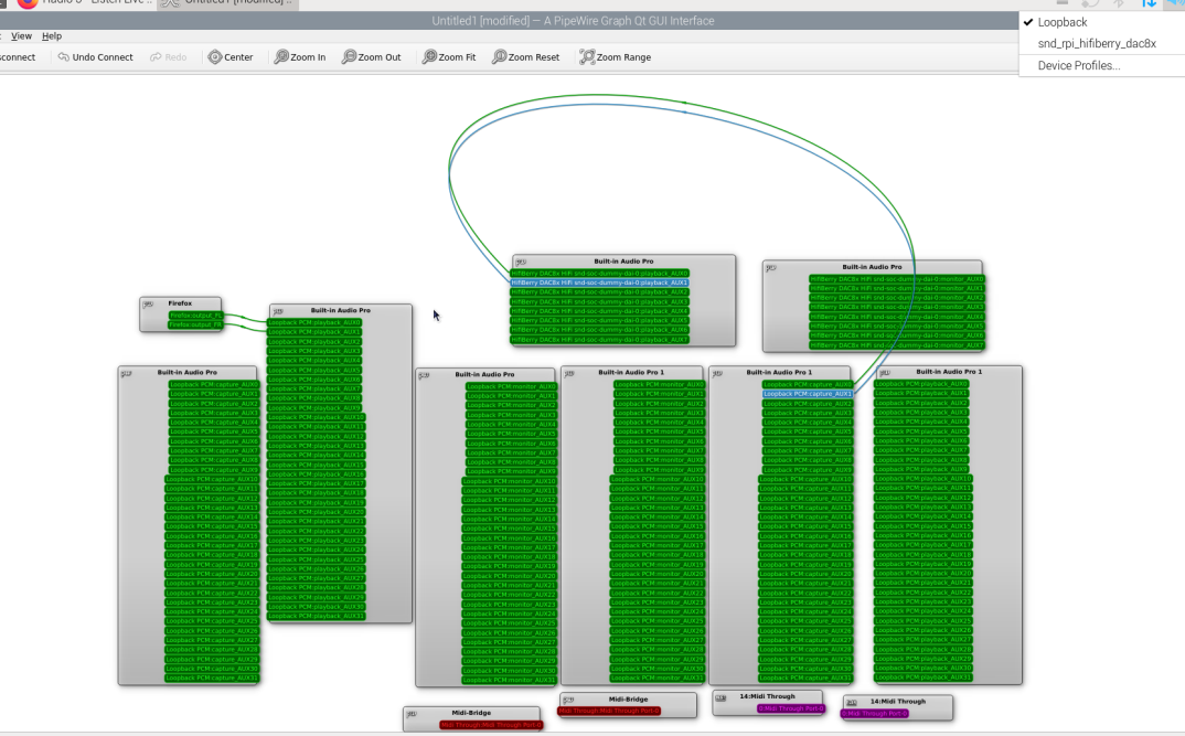

YES! It was easy, just create a loopback device and tell VLC to output audio to it. The config file I used was very simple as well, but at the moment it doesn't use any filters.
