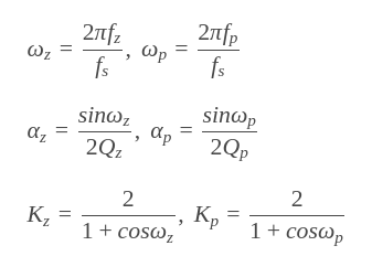

A question and another possible suggestion: Do you happen to know how the formulae for the Linkwitz transform coefficients were derived? I used to use the same (which I believe I got from some spreadsheet somewhere) in my own DSP software, but some time ago I noticed that the resulting transfer function doesn't quite match up with a highpass discretized using the bilinear transform. Using the highpass coefficients from Robert Bristow-Johnson's famous Audio EQ Cookbook, I derived the following for a bilinear transform discretized Linkwitz transform:
One can also trivially modify the gain terms to make the magnitude unity at DC rather than Nyquist, creating a lowpass transform:

I got the LT equations from the minidsp spreadsheet: https://www.minidsp.com/applications/advanced-tools/linkwitz-transform
I haven't seen any mention of how they were derived.

A good question, but one I don't have an answer for. My formulation is a bit simpler, if that means anything 🙂.What is best, follow the spreadsheet that most people seem to be using, or the slightly more correct but different new equations?

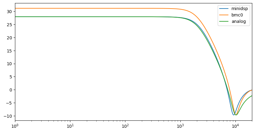

Here is a comparison between miniDsp, the new equations, and the ideal transfer function of an analog LT.Yes, the difference is only at higher frequencies. Arguably this means that practically, there's no real difference since most only use the filter at rather low frequencies.
Parameters:
FS = 44100
F0 = 10000
Ft = 2000
Q0 = 3.0
Qt = 0.7
The new equation hits the frequency of the dip better, but miniDsp gets the low frequency gain right. Can't really say which is more accurate 😀

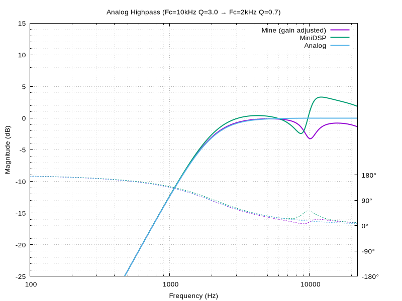

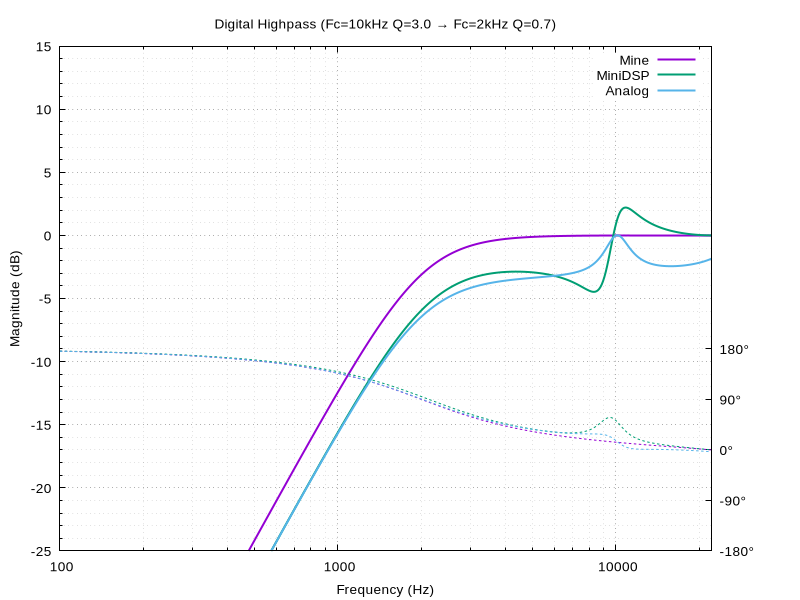

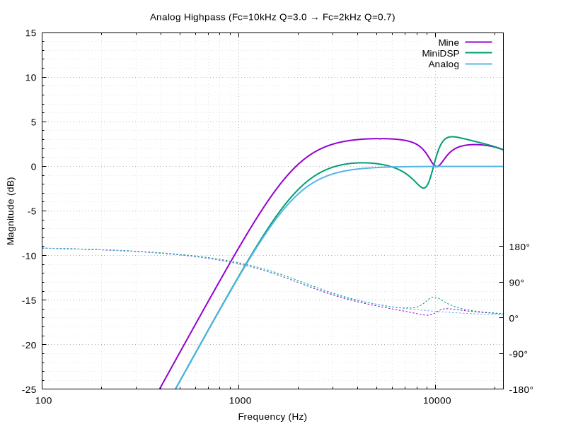

Here's another way of looking at it—the resulting highpass response after applying the LT:Here is a comparison between miniDsp, the new equations, and the ideal transfer function of an analog LT.
Starting from an analog highpass:
Starting from a digital highpass (bilinear transform):
The gain error in the first plot is of course related to the frequency warping caused by the bilinear transform. As stated before, my formulation gives an exact result when applied to the digital highpass (i.e. identical to a digital highpass with Fc=Fp and Q=Qp).
Edit: If desired, the DC gain could be adjusted to match the analog prototype:

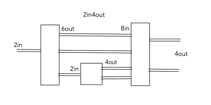

A mixer must always accept all the channels in the pipeline, so the middle mixer must be 6-in, 8-out. Just let the input channels 1-4 map 1:1 to output channels 1-4.Is it possible to configure the below and if so, how? t would give some control properties (ease etc) that I like given the levers in the mixers wrt. on/off, phase etc... my problem is the "internal" 2in4out...
