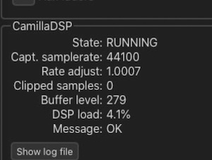

If I enable Rate Adjust I se the number ticking up +0.001 every 10-20 seconds but then also returns to 0 and even goes negative. What is this an indication of and should I have it activated?
Please read the section on enable_rate_adjust in https://github.com/HEnquist/camilladsp/ for explanation what that feature does. If you have no rate-adjustable capture device nor async resampler, CDSP has no use for the value (e.g. for OSX https://github.com/HEnquist/camilla...17182b63d051/src/coreaudiodevice.rs#L841-L857 )Should I have it activated?
Rate adjust uses a complicated algorithm involving averaging to estimate capture/playback rate ratio and cannot yield perfectly stable values, even for synchronous clocks.

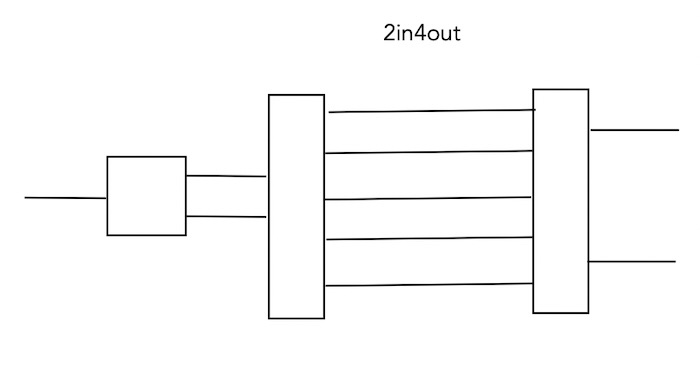

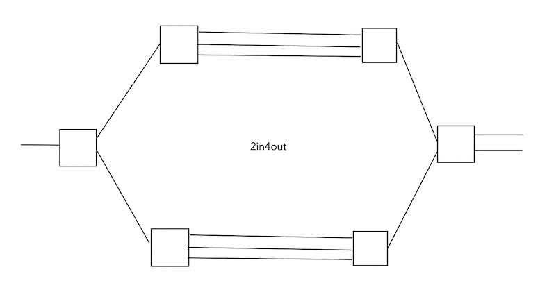

How do one create a mixer structure like this: (se one line as a stereo pair channels)
Read the manual as well as tried in CDSP... the first mixer (left) would need to be 2to4 but then the output to from this mixer need to go to two different mixers - I dot get how to create that... but probably one have to do this in an other way...?
