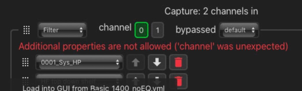

Upgraded tov3 and after an import, which seemed successful, I get:
2025-02-25 01:19:41.137813 ERROR [src/socketserver.rs:1202] Error parsing yaml: pipeline: unknown field channel, expected one of channels, names, description, bypassed at line 753 column 1
What to do?

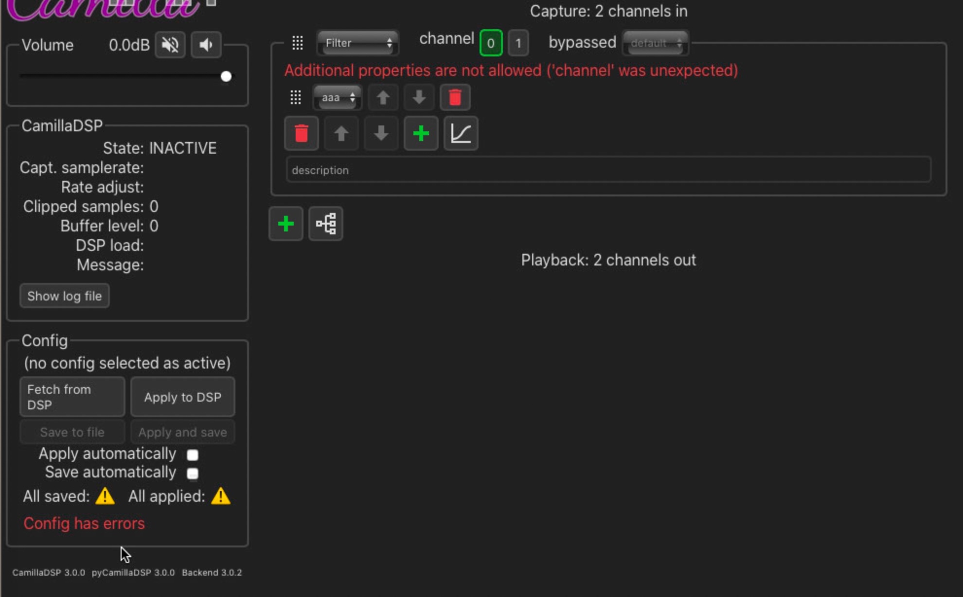

Something is fishy...
I installed freshly 3.0.2 from here: https://github.com/HEnquist/camilladsp-setupscripts/releases/tag/v3.0.2
Choose a default config
Add a filter
Add a pipeline... error
Why o why?
My other installation (on Apple HW) looked like it was only one verision number but hoovering over it showed the rest. On this Intel HW mac, the versions are all visible..
Do I really have 3.0.2 I wonder...
I now see 3.0.2 as I expected it to look like. Was this a WEB browser thing....? Yeah probably..

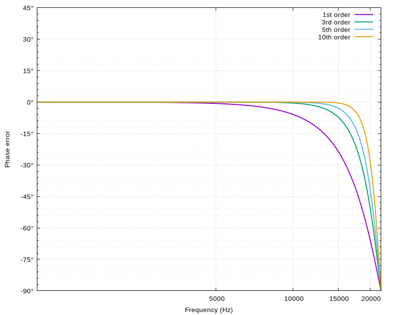

If you feel like getting a bit fancier, there's a fairly simple and numerically stable way to implement Thiran fractional delay filters of arbitrary order:
I checked the Thiran filter of Octave. For first order it gives the same result as the simple formula. I use a delay line for the full samples, and a first order iir for the fractional. Is there some advantage with using a higher order Thiran filter here?
Looks like your browser had cached the old frontend code! A page reload should take care of that.
That formula is indeed that of a first-order Thiran allpass, so this is expected 😉
The answer to that is also on CCRMA, higher orders stay flat longer, but once they start deviating they deviate further.
Depends on whether you're looking at group delay or phase delay. The phase delay is always some number of whole samples at Fs/2, so any order will have the same phase error at Fs/2. Group delay is related to the slope of the phase response, so it makes sense that the group delay deviates more near Fs/2 for higher orders. Even a first order filter looks bad if the target delay is small (say <0.1 samples).
Probably best to use an order >1, <10, but which one?
You get into diminishing returns rather quickly. Optimal would depend on the application and the sample rate. Here's the phase error (i.e. deviation from an ideal fractional delay) of a few Thiran allpass filters (Fs=44.1kHz; delay=N-0.5 samples, where N is the filter order):

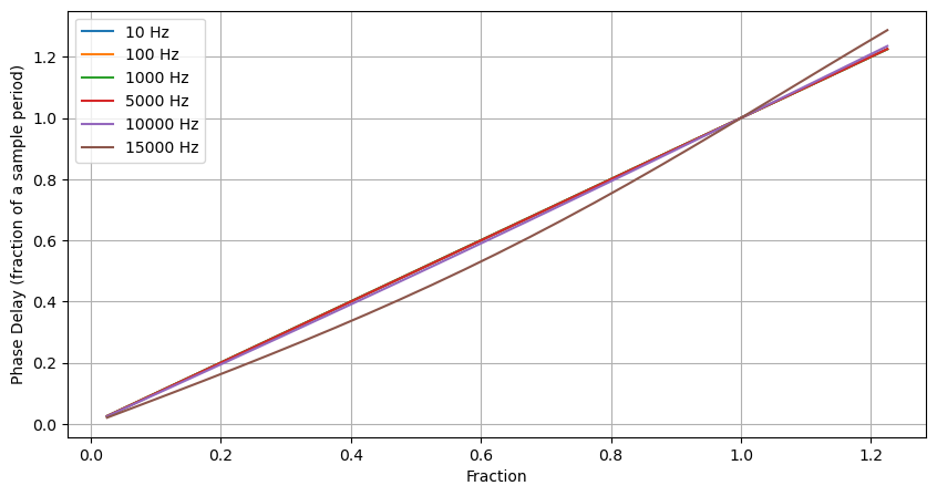

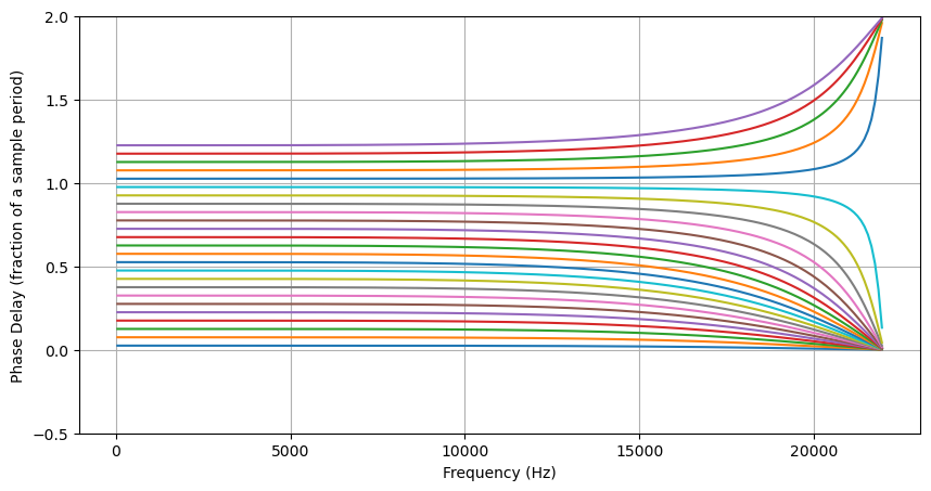

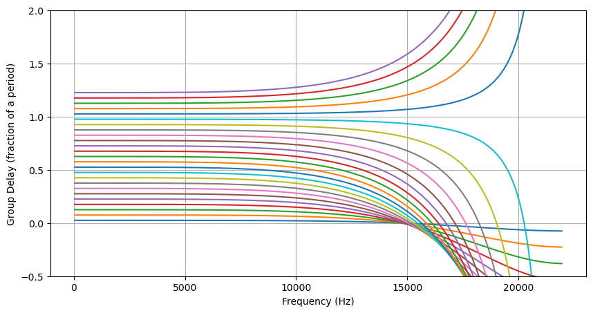

I was looking at group delay yes, now I added a plot of phase delay as well. It's quite tempting to use order = 2. It's better than first order, and I can continue being lazy and implement the delay with a biquad 😛
Some plots, phase delay at 44.1 kHz, with fraction set to some evenly spaced values from close to 0 to just over 1:
group delay for the same:
and resulting phase delay vs requested for a couple of frequencies, follows quite nicely:
