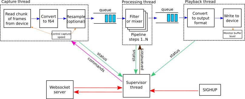

I have some questions about chuck size / buffers. Are the queues in the diagram below the same as the buffer? Or something different?
And what is queuelimit? Is it a limit on how large the buffer can get?
The buffer is the Alsa device buffer, it's basically the shared space where the device and client read or write to exchange data. It's not shown in the diagram since it's an internal detail of the Alsa backend, The others don't have an exact equivalent. The way the Alsa playback backend works currently, this buffer should be large enough that a full chunk can be written to it.
The queues sit between the capture device and the pipeline, and between the pipeline and the playback device. They are message queues for passing data from one thread to another, where each message is one chunk. The blue boxes in the queues in the diagram are meant to show chunks waiting for the receiver to pick them up.
The queuelimit is a limit for how many chunks each queue can hold before it's full. If a queue gets full, the sender has to either wait for space to become available, or drop the chunk it's trying to send. Normally when running, the queues hold zero or one chunk each.

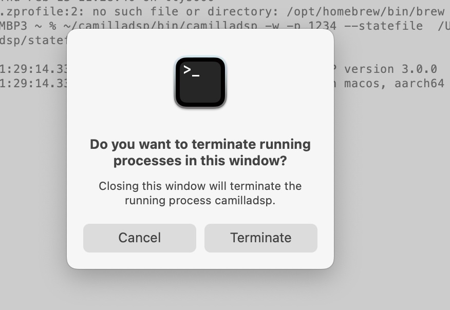

Updated again. Tried to start - but got this:
(base) M@MBP3 ~ % ~/camilladsp/bin/camilladsp -w -p 1234 --statefile /Users/MBPr/camilladsp/statefile.yml
2025-02-13 10:40:08.128004 INFO [src/bin.rs:781] CamillaDSP version 3.0.0
2025-02-13 10:40:08.128226 INFO [src/bin.rs:782] Running on macos, aarch64
2025-02-13 10:40:08.130533 ERROR [src/socketserver.rs:487] Failed to start websocket server: Address already in use (os error 48)
I've seen this many times before and my way out of it is a computer restart... Is there a faster/better way get out of it (os error 48)?
Did you just shut down the old camilladsp process? I have noticed that macos sometimes is a bit slow to mark ports as free, but waiting a minute should solve it. Or rebooting of course.
OK I figured it out.
When quitting the terminal windows, terminal says "terminate process" - I always do this.
Entering:
lsof -nP -iTCP -sTCP:LISTEN | grep 5005 (netstat didn't work on my machine)
.... gave the pid for port user of 5005 and in this case it was "python3.13"
So closing the terminal quits camilla process but not process to which the port seem to belong to.
Killing the photon process, I could start camilla again without a computer restart but no change in revisions... hmm..
