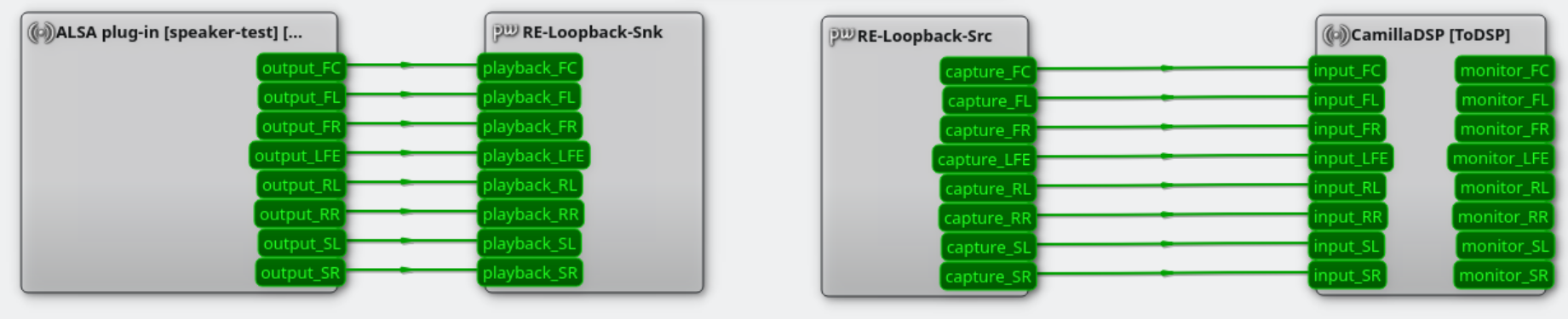

Help ... I'm using Camilladsp on Kubuntu 24.04 and 24.10 on an Intel x86 machine with Pipewire & Wireplumber & Loopback
I can play audio, process it through Camilladsp and send it out on a multichannel dac ... BUT
I have 2 challenges
Using speaker-test and easy-effects it seems that pipewire and loopback are interacting ok ... each of the 8 channels tested shows up in the easy-effects monitor
Qpwgraph suggests pipewire connects everything correctly - it shows 8 Loopback channels connected as expected on Kubuntu 24.10
Here are the pipewire loopback definitions in ~/.config/pipewire/pipewire.conf
Note that I also posted an entry in AskUbuntu with a little more debugging detail (no replies yet) AskUbuntu Question - Pipewire & Loopback
Multi-channel audio works well with Camilladsp when sent directly via Alsa Loopback, the problems seem to relate to using pipewire & wireplumber
It's likely I've misunderstood or misconfigured something ....so I'd rather not waste Henrik's time chasing a non-existent problem
Is anyone else successfully sending multichannel audio to camilladsp using pipewire & alsa's loopback ? Any pointers on what to change, where to look or debugging ?
I have 2 challenges
- Unable to open 8 channels in the "source" ie. the player (VLC say) can open and use 8 channels but Camilladsp can open no more than 6
- Channels are mapped in an odd manner. Basically Centre & LFE are both sent to the same channel and RL & RR are both sent to the same (different to Centre&FLE) channel

yes, ignoring the loopback name changes (supposed to protect the guilty 🙂
Chain ie .... Speaker-test --> Pipewire My-Loopback-Snk --> Pipewire My-Loopback-Src --> Camilladsp ---> Alsa hw:1,0 dac
or diagram from qpwgraph while testing with speaker-test
