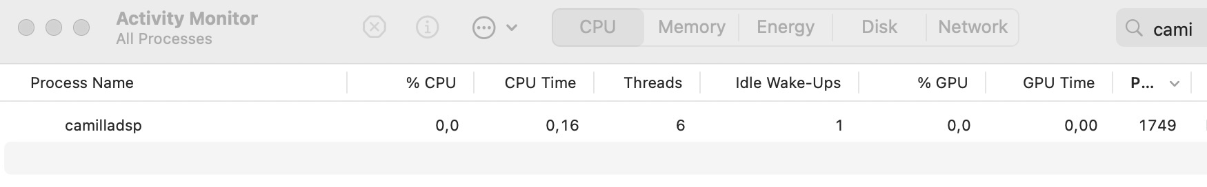

I checked again - just quitting camilladsp process is not enough (quitting the terminal windows didn't seem to kill the process actually) - I tried starting camilla again after that but it crashed. Get rid of python and OK.
My point was the if CDSP was running in the terminal, exiting the terminal + CDSP could not have released that port which was taken by a very different process - the gui in python. But I may have understood your setup wrongly...
No it's bug standard. It's me who dont get it most probably.
I close two windows - maybe I confused the two.
I only see one camilla process in mac Activity Monitor.app
But I start two by terminal - where is the other one? Inside the python process? See, I'm a noob 🙂
edit: yes I see you wrote that - OK!

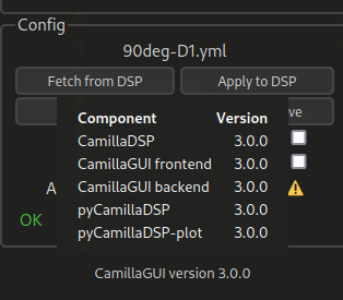

Not sure whether it's a bug but 3.0 is still being reported after the upgrade to 3.0.1
Code:
$ python -m pip install camilladsp-plot[plot]@git+https://github.com/HEnquist/pycamilladsp-plot.git@v3.0.1
Defaulting to user installation because normal site-packages is not writeable
Collecting camilladsp-plot@ git+https://github.com/HEnquist/pycamilladsp-plot.git@v3.0.1 (from camilladsp-plot[plot]@ git+https://github.com/HEnquist/pycamilladsp-plot.git@v3.0.1)
Cloning https://github.com/HEnquist/pycamilladsp-plot.git (to revision v3.0.1) to /tmp/pip-install-2jxz6d6o/camilladsp-plot_b9e23f4973f14d009b860c07c57c699c
Running command git clone --filter=blob:none --quiet https://github.com/HEnquist/pycamilladsp-plot.git /tmp/pip-install-2jxz6d6o/camilladsp-plot_b9e23f4973f14d009b860c07c57c699c
Resolved https://github.com/HEnquist/pycamilladsp-plot.git to commit f20647cf390c773ee155d273efe7c23d1aa5af22
Installing build dependencies ... done
Getting requirements to build wheel ... done
Preparing metadata (pyproject.toml) ... done
Requirement already satisfied: PyYAML>=6.0 in /usr/lib64/python3.13/site-packages (from camilladsp-plot@ git+https://github.com/HEnquist/pycamilladsp-plot.git@v3.0.1->camilladsp-plot[plot]@ git+https://github.com/HEnquist/pycamilladsp-plot.git@v3.0.1) (6.0.1)
Requirement already satisfied: jsonschema>=4.10 in /usr/lib/python3.13/site-packages (from camilladsp-plot@ git+https://github.com/HEnquist/pycamilladsp-plot.git@v3.0.1->camilladsp-plot[plot]@ git+https://github.com/HEnquist/pycamilladsp-plot.git@v3.0.1) (4.19.1)
Requirement already satisfied: numpy in /usr/lib64/python3.13/site-packages (from camilladsp-plot@ git+https://github.com/HEnquist/pycamilladsp-plot.git@v3.0.1->camilladsp-plot[plot]@ git+https://github.com/HEnquist/pycamilladsp-plot.git@v3.0.1) (1.26.4)
Requirement already satisfied: matplotlib in /usr/lib64/python3.13/site-packages (from camilladsp-plot@ git+https://github.com/HEnquist/pycamilladsp-plot.git@v3.0.1->camilladsp-plot[plot]@ git+https://github.com/HEnquist/pycamilladsp-plot.git@v3.0.1) (3.9.4)
Requirement already satisfied: attrs>=22.2.0 in /usr/lib/python3.13/site-packages (from jsonschema>=4.10->camilladsp-plot@ git+https://github.com/HEnquist/pycamilladsp-plot.git@v3.0.1->camilladsp-plot[plot]@ git+https://github.com/HEnquist/pycamilladsp-plot.git@v3.0.1) (24.2.0)
Requirement already satisfied: jsonschema-specifications>=2023.03.6 in /usr/lib/python3.13/site-packages (from jsonschema>=4.10->camilladsp-plot@ git+https://github.com/HEnquist/pycamilladsp-plot.git@v3.0.1->camilladsp-plot[plot]@ git+https://github.com/HEnquist/pycamilladsp-plot.git@v3.0.1) (2023.11.2)
Requirement already satisfied: referencing>=0.28.4 in /usr/lib/python3.13/site-packages (from jsonschema>=4.10->camilladsp-plot@ git+https://github.com/HEnquist/pycamilladsp-plot.git@v3.0.1->camilladsp-plot[plot]@ git+https://github.com/HEnquist/pycamilladsp-plot.git@v3.0.1) (0.35.1)
Requirement already satisfied: rpds-py>=0.7.1 in /usr/lib64/python3.13/site-packages (from jsonschema>=4.10->camilladsp-plot@ git+https://github.com/HEnquist/pycamilladsp-plot.git@v3.0.1->camilladsp-plot[plot]@ git+https://github.com/HEnquist/pycamilladsp-plot.git@v3.0.1) (0.19.1)
Requirement already satisfied: contourpy>=1.0.1 in /usr/lib64/python3.13/site-packages (from matplotlib->camilladsp-plot@ git+https://github.com/HEnquist/pycamilladsp-plot.git@v3.0.1->camilladsp-plot[plot]@ git+https://github.com/HEnquist/pycamilladsp-plot.git@v3.0.1) (1.3.1)
Requirement already satisfied: cycler>=0.10 in /usr/lib/python3.13/site-packages (from matplotlib->camilladsp-plot@ git+https://github.com/HEnquist/pycamilladsp-plot.git@v3.0.1->camilladsp-plot[plot]@ git+https://github.com/HEnquist/pycamilladsp-plot.git@v3.0.1) (0.11.0)
Requirement already satisfied: fonttools>=4.22.0 in /usr/lib64/python3.13/site-packages (from matplotlib->camilladsp-plot@ git+https://github.com/HEnquist/pycamilladsp-plot.git@v3.0.1->camilladsp-plot[plot]@ git+https://github.com/HEnquist/pycamilladsp-plot.git@v3.0.1) (4.53.1)
Requirement already satisfied: kiwisolver>=1.3.1 in /usr/lib64/python3.13/site-packages (from matplotlib->camilladsp-plot@ git+https://github.com/HEnquist/pycamilladsp-plot.git@v3.0.1->camilladsp-plot[plot]@ git+https://github.com/HEnquist/pycamilladsp-plot.git@v3.0.1) (1.4.8)
Requirement already satisfied: packaging>=20.0 in /usr/lib/python3.13/site-packages (from matplotlib->camilladsp-plot@ git+https://github.com/HEnquist/pycamilladsp-plot.git@v3.0.1->camilladsp-plot[plot]@ git+https://github.com/HEnquist/pycamilladsp-plot.git@v3.0.1) (24.2)
Requirement already satisfied: pillow>=8 in /usr/lib64/python3.13/site-packages (from matplotlib->camilladsp-plot@ git+https://github.com/HEnquist/pycamilladsp-plot.git@v3.0.1->camilladsp-plot[plot]@ git+https://github.com/HEnquist/pycamilladsp-plot.git@v3.0.1) (11.0.0)
Requirement already satisfied: pyparsing>=2.3.1 in /usr/lib/python3.13/site-packages (from matplotlib->camilladsp-plot@ git+https://github.com/HEnquist/pycamilladsp-plot.git@v3.0.1->camilladsp-plot[plot]@ git+https://github.com/HEnquist/pycamilladsp-plot.git@v3.0.1) (3.1.2)
Requirement already satisfied: python-dateutil>=2.7 in /usr/lib/python3.13/site-packages (from matplotlib->camilladsp-plot@ git+https://github.com/HEnquist/pycamilladsp-plot.git@v3.0.1->camilladsp-plot[plot]@ git+https://github.com/HEnquist/pycamilladsp-plot.git@v3.0.1) (2.8.2)
Requirement already satisfied: six>=1.5 in /usr/lib/python3.13/site-packages (from python-dateutil>=2.7->matplotlib->camilladsp-plot@ git+https://github.com/HEnquist/pycamilladsp-plot.git@v3.0.1->camilladsp-plot[plot]@ git+https://github.com/HEnquist/pycamilladsp-plot.git@v3.0.1) (1.16.0)
~$ systemctl --user restart camilladsp camillagui
I must be missing something!
https://raw.githubusercontent.com/HEnquist/camillagui-backend/31fcbfbdd501b95c735e50d542a751709c4c17a1/release_automation/versions.yml
Code:
camillagui_tag: v3.0.1
pycamilladsp_tag: v3.0.0
pycamilladsp_plot_tag: v3.0.1
I forgot to update the versions that are displayed! There will be a 3.0.2 to fix that soon.. 3.0.1 should still work though.
