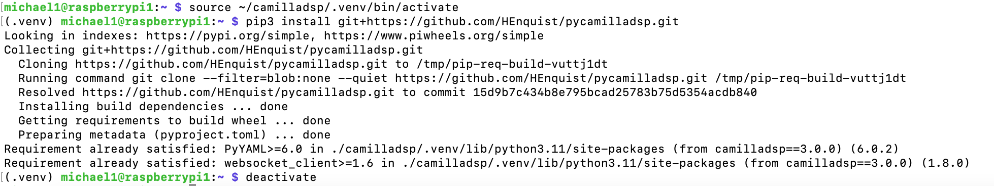

Henrik, I'm trying to get camilladsp-controller going on an RPi5 set up as per mdsimon2 instructions, however all the python stuff is now under venv and https://github.com/HEnquist/camilladsp-controller won't install saying something like it is not a python project. Are you planning on making a pycamilla-controller anytime soon ?
Installing it and running the old way comes up with module not found.
camilladsp-controller isn't a library, you just need to download it, and then install the dependencies for it, preferably in a new virtual env. I didn't describe this in the readme yet. On Linux it needs the official python alsa binding, which isn't available on pypi. You'll need to install it from the system repos with apt, and let the virtual env use system packages with the --system-site-packages option, see https://docs.python.org/3/library/venv.html
As Henrik said getting the controller to work is all about dependencies. I am going to basically repeat everything he said above but translate it a bit to those of us that are less familar with python / venv.
First, in order to access system packages in venv, we need to add --system-site-packages when installing venv. This changes the install command to "python -m venv --system-site-packages ~/camilladsp/.venv", I've updated my tutorial to reflect.
A system package is something you install with a command like "sudo apt install python3-xyz". So to install the pyalsa system package run "sudo apt install python3-pyalsa".
A basic concept when using venv is that you activate / deactivate it. If you see the command "source ~/camilladsp/.venv/bin/activate" this means you are activating venv. venv should be used to install anything with pip, at this point the only things we need to install like this are pycamilladsp and pycamilladsp-plot. Below is a screenshot of what it looks like to activate venv, run pip (in my case pycamillasdp was already installed) and deactivate.
Previously I had some other stuff installed like this (aiohttp, lgpio, evdev) but that was before I learned about the --system-site-packages thing which allows them to be installed as system packages.
Install the controller by running "git clone https://github.com/HEnquist/camilladsp-controller ~/camilladsp/camilladsp-controller". The controller itself is just a python routine called "controller.py".
If you follow the instructions in the tutorial the venv python binary is installed in /home/username/camilladsp/.venv/bin/python3. If you look at the oled, flirc and camillagui services you will see they all run python from this location. For the controller you need to do the same, so running it will look something like "/home/michael1/camilladsp/.venv/bin/python3 /home/michael1/camilladsp/camilladsp-controller/controller.py -p 1234 -s "/home/michael1/camilladsp/configs/ultralitemk5_gadget_44c_44p.yml" -r 44100".
Good luck!

When in time can we have the glorious advantage of having an install script for camilla 3 for mac do we think? 🙂
This is probably obvious to someone that understands camilladsp-controller, but the above command should actually be something like "/home/michael1/camilladsp/.venv/bin/python3 /home/michael1/camilladsp/camilladsp-controller/controller.py -p 1234 -s "/home/michael1/camilladsp/configs/gadget_{samplerate}.yml" -r 44100".
You would have configurations for each sample rate, gadget_44100.yml, gadget_48000.yml, gadget_88200.yml, gadget_96000.yml, etc. I have found that you need to specify some rate to start with (i.e -r 44100), otherwise it doesn't work. In this case as I am using the USB gadget as capture device, any time I change the sample rate on my USB host the controller will apply the correct configuration for that sample rate.
One other thing that was not immediately obvious to me is you want to leave your normal camilladsp instance that points to the statefile running (in my case my service runs "camilladsp -s camilladsp/statefile.yml -w -g-40 -o camilladsp/camilladsp.log -p 1234") while also running the controller.
Overall, the controller seems to work very nicely for switching sample rates with the USB gadget.
Michael
