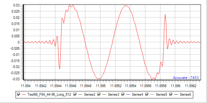

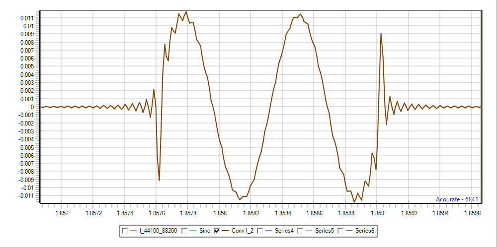

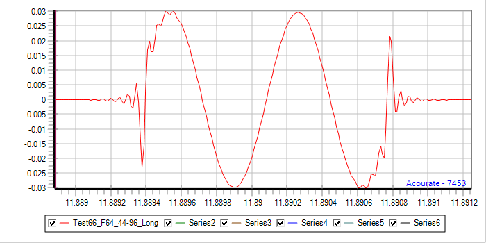

Have a look at the results of very first experiences with my "torture test" signal along with the new camillaresampler library. In this test, I used the fixedin64 example and ran it first "as is" with a sinc_length=64, and as then a variant with an increased sinc_lenght=512
Sinc lenght 64:
Sinc lenght 512:
Sinc lenght 65536 (near-perfect reference):
Very promising ...

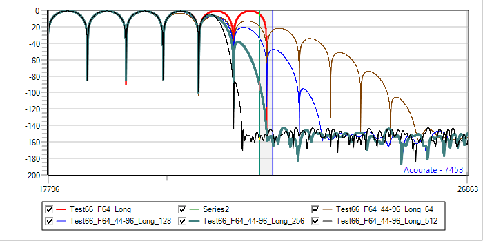

Some results of some further iterations of sinc length in fixedin64, upsampling from 44100Hz to 96kHz:
sinc length 512, filters down to noise floor (-150dB) < 22050Hz (=Nyquist Frequency!)
sinc length 256, filters down to noise floor (-150dB) @ 22050Hz
sinc length 128 attenuates -50dB @ 22050Hz
sinc length 64 attenuates -20dB @ 22050Hz
Therefore, letting all other parameters of fixedin64 unchanged, a filter lenght of 256 seems the best compromise setting. Values of 64 or 128 instead will in this case more or less violate the Nyquist theorem.

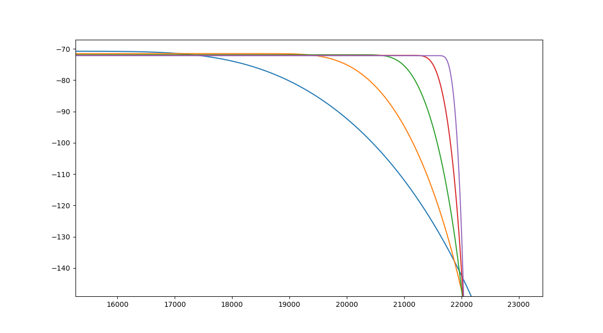

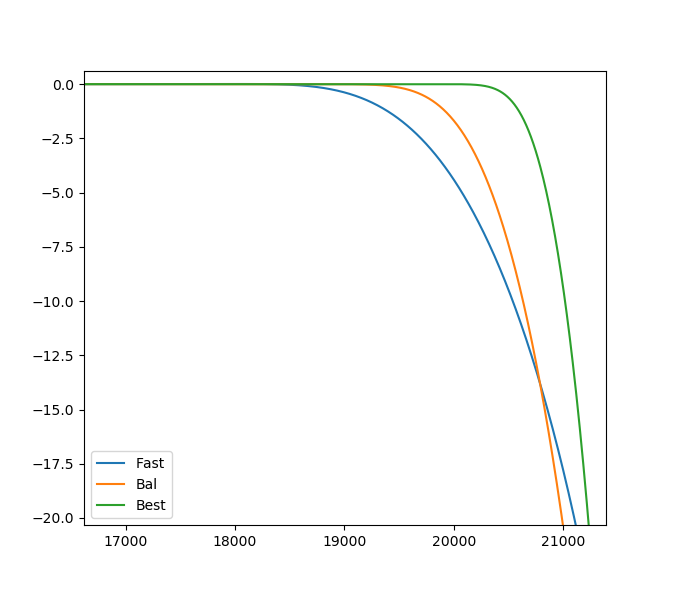

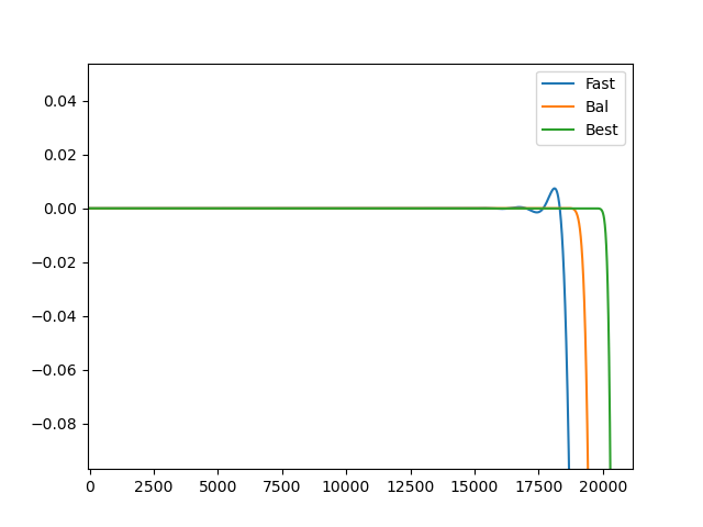

I have been investigating suitable combinations of parameters and I made a plot of the frequency response for different sinc lengths. Shorter sincs roll off slower, so in order to avoid aliasing I have changed the cutoff frequency for each length. I aimed at getting -140dB ad fs/2 and this led to the formula f_cutoff = 0.5^(16/sinc_length).
I used 64, 128, 256, 512 and 1024 points. The -3dB points end up at approximately (for 44.1kHz input):
64: 18kHz
128: 20kHz
256: 21 kHz
512: 21.5 kHz
1024: 21.8 kHz
See the attached plot for the curves.
The time needed to resample is almost linear with sinc length. 256 points is probably a reasonable value. My Ryzen laptop does a second of stereo audio 44.1kHz -> 96kHz, sinc length of 256 with cubic interpolation in 190 ms.
Switching to linear interpolation drops the time to 95 ms. Then the artefacts grow to about -160dB. Probably still quite ok..
And when using synchronous resampling, the time drops to 55 ms. Then the artefacts are again well below -200dB.
This is all with 64-bit processing. Switching to 32-bit doesn't speed things up on this system. But I would guess that on a raspberry running a 32-bit os it would make a big difference.

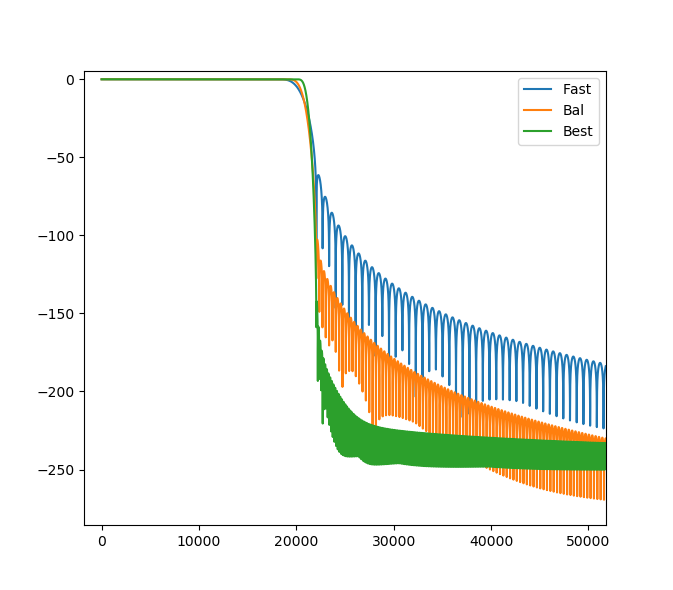

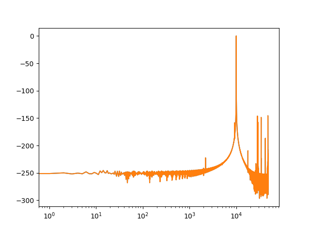

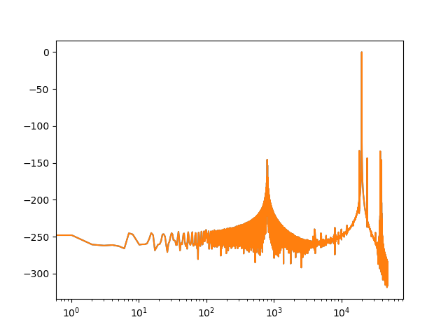

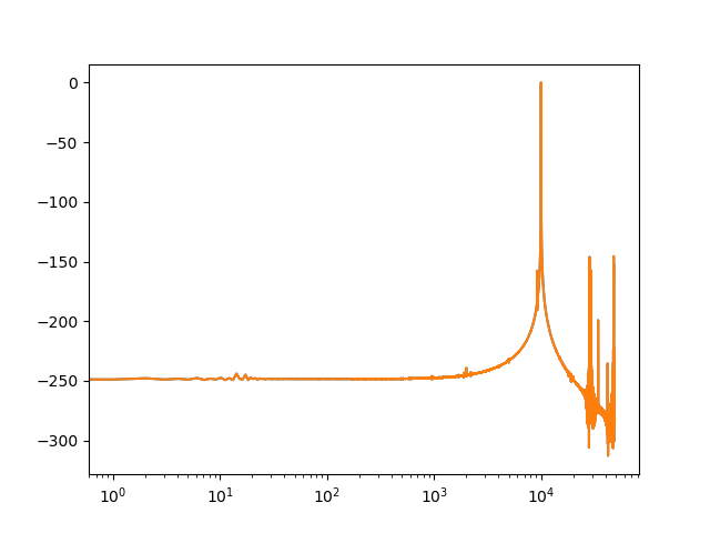

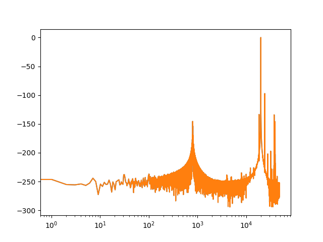

Some more plots, resampling a 10kHz sine from 44.1 to 96kHz in Async mode.
Fast preset:
Balanced preset:
Accurate preset:

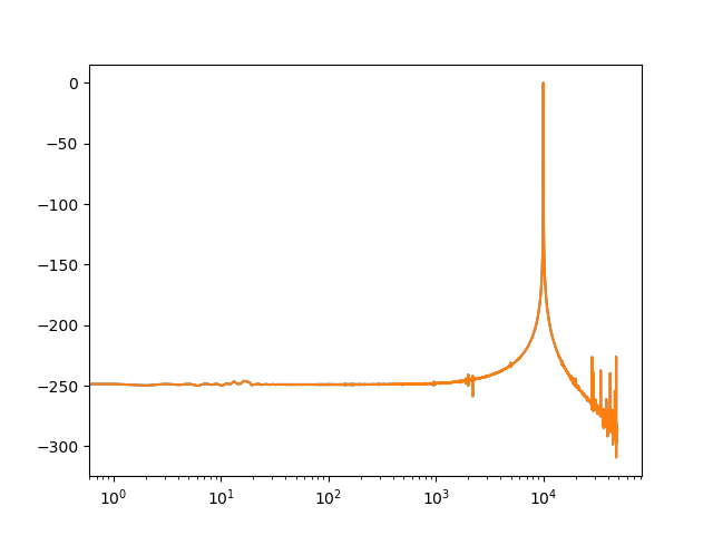

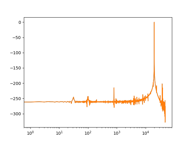

Resampling a 20kHz sine from 44.1 to 96kHz in Async mode.
Fast preset:
Balanced preset:
Accurate preset:
