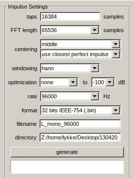

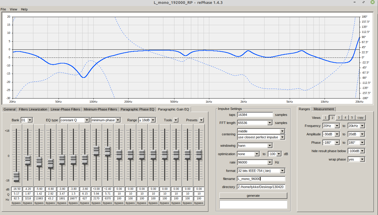

I'am (trying) to build some fir filters for this beautiful CamillaDSP engine, and while asking some quistions at this thread https://www.diyaudio.com/forums/multi-way/221434-rephase-loudspeaker-phase-linearization-eq-fir-filtering-tool-299.html#post6159915
At post #2984 i realised that i don't know about filter lengths and soo, seeing what fluid replied to me, maked me post this post now.
I hope i can have some explanation of what kind of filter to and what format i need (filter length's etc...)
## See attached picture too
I use REW and RePhase for the room correction.

It's not really possible to answer how long your filters should be, that really only depends on what you want to achieve!
But one can say a few things. Long filters are mostly useful for correcting low frequencies. Then it's not the length of the impulse response in samples that's important, but the length in time. So the filter at 96kHz should be twice as long (in samples or taps) as the one for 48 kHz to give the same result.
About format. Text is fine and have the advantage that it's human readble, but is slower to import and the files get quite big. I would recommend 64-bit floats (often called "double") if you are running 64-bit (the default), or 32-bit floats ("single" or sometimes "float") if you compiled CamillaDSP for 32-bit mode. Then there is no conversion needed when reading.

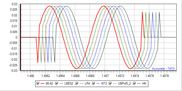

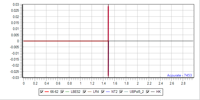

Some testing along with CamillaDSP:
I convolved a synthetic and quite weird test signal of 65 samples length along with five different LinPhase (128k) 4-way xovers of same xfrequencies (70/420/2450), but of different types from shallow to very steep (and ringing): (L)BES2, LR4, NT2, UBPol5_2 and HK. Just to have a look how it sums up after splitting the CamillaDSP data pipe into to 2x4 channels at the begin of the pipe, inserting the filters like for a real stereo xover, but then merging everything together again at the end of the pipe. Theoretically this equals ideally an 1:1 transmission (along with some processor heating). The idea was to control wheter there is a critical filter type, where the convolving process would introduce some glitches for one reason or another. Result: Nope! Perfect convolution/summation with all types of xovers!
Red is the original MinPhase test signal, artificially delayed by 65532 samples for the foto session. The other curves are the result of the 4-way-convolution after summation. They have been artificially delayed 2-sample-wise to better show theirs congruence with the original test signal.
Conclusion: Convolution does not harm and is ok with any filter type - as hopefully expected!

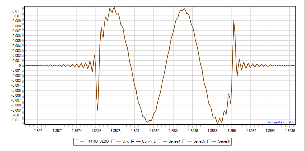

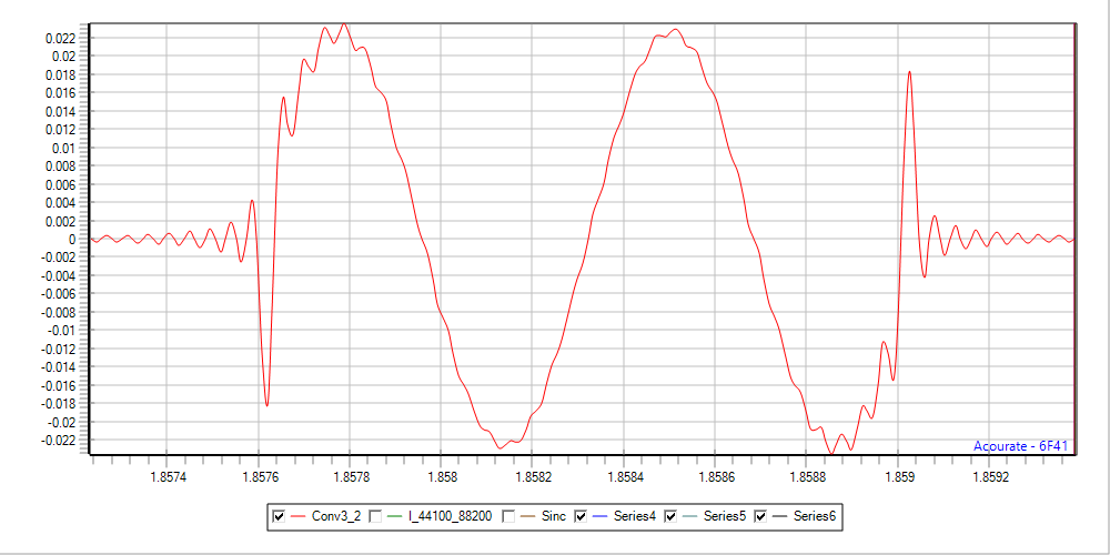

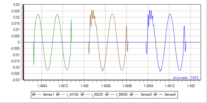

Brief Addon:
While convolution does not distort the test pulse used in the above test set, sample rate conversion (SRC) does. Same 2x4xover setup as before with 3 sets of LR4 filters (44.1/88.2/96), same input file 44.1/16. SRC was performed with 64Bit accuracy by resample_soxr --band-width 80 --phase 25. The convolver was CamillaDSP - what else?
The graph shows the 3 output impulses after summing 4 channels xover. Green 44.1k -> 44.1k (no resampling), 44.1k -> 88.2k (brown), 44.1k -> 96k (blue). Brown and blue are more or less the same, so there is absolutely no point in beleiving in even and integer resampling ratios such as is advocated by some.
So now it gets interesting. How will (maybe) the new and upcoming resampler algorithm behave with this synthetic, really nasty input signal? My bet is that any resampler will fail with this test, because of the nature of this "ugly" and quasi transient input signal.
I'll comment on this with my admittedly incomplete knowledge about the sampling theorem...
IMHO the input signal you gave is not allowed - or to rephrase slightly - it could never have come from digitizing an analogue signal as it would have had to contain frequency components above the nyquist frequency. This violates the sampling theorem, you can't sample frequencies above nyquist.
So my theory is that the resampler is excited by this transient and shows ringing in it's filter with these "unallowed" frequency components.
Hopefully somebody with better knowledge about this stuff can comment on this.
The signal is allowed, but the band-limited (at the Nyquist frequency) analog signal that generated this sampled signal would have to look quite strange.
The "problem" is that when we plot a digital signal, we tend to draw the points and connect them with straight lines. But that's not true. The sample points are really just points, and there are rules for what a band-limited signal is allowed to do in between the points. For any given series of sample points, there is exactly one band-limited signal that passes through all points.
Let's consider a short digitalized signal sampled at fs_orig: 0, 0, 0, 1, 0, 0, 0. It's a single spike, so the the frequency content of this signal is a flat line all the way up to fs_orig/2. Now we want to upsample it to twice the sample frequency, fs_new = 2*fs_orig.
The simple way would be to add points halfway between the old points by simple linear interpolation. Then it becomes 0, 0, 0, 0, 0, 0.5, 1, 0.5, 0, 0, 0, 0, 0. Nice and easy, an when we plot the result with the normal tools it looks just as the original. But then we plot the spectrum, and realize that this new signal contains stuff all the way up to the new Nyquist frequency, fs_new/2. Not what we wanted! New frequencies are distortion.
We need to add the new points in a way that doesn't add any new frequencies to the signal. The way to do that is to do sinc interpolation. This is equivalent to making a brickwall filter at fs_old/2.
Then the upsampled signal becomes: 0, 0.13, 0, -0.21, 0, 0.64, 1, 0.64, 0, -0.21, 0, 0.13, 0.
This is truncated because the sinc is actually infinitely long. If I would continue the series I would get more of the same, with the interpolated points alternating between positive and negative and getting smaller the further out we get.
We can't really work with infinite signals so we have to truncate the sinc at some length. Normally it's also multiplied with a window function to not mess up the spectrum too much when truncating.
The alternating pos/neg is the ringing you can see in the curves, and it's as expected. It is what prevents the upsampling from generating new frequencies!
