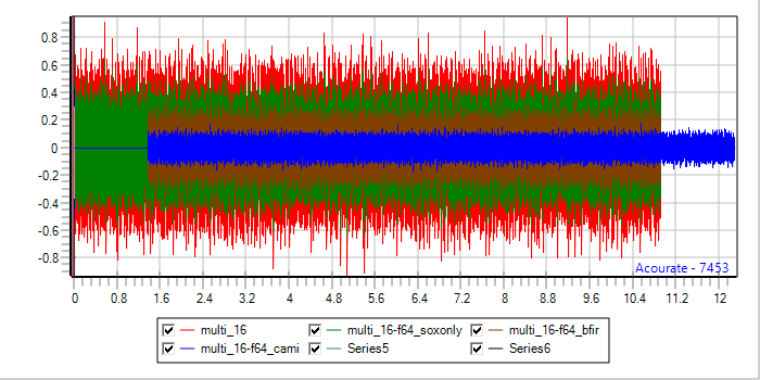

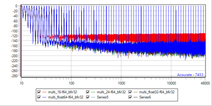

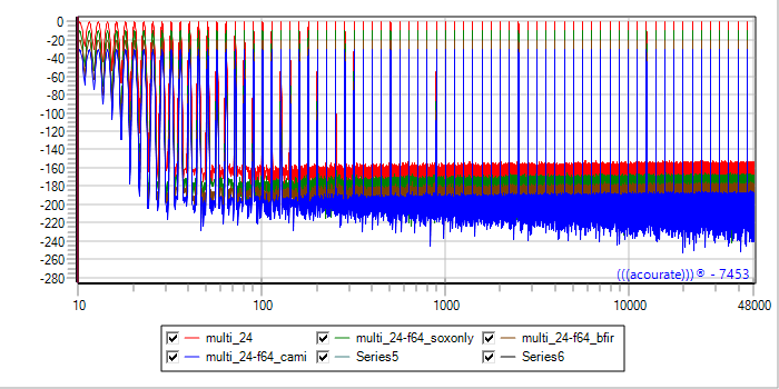

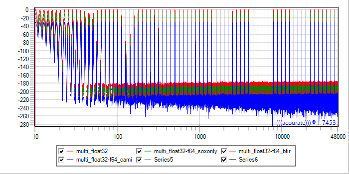

I did some benchmarking of CamillaDSP as a convolver and compared it vs. Brutefir. Very first the results in words:
- Camilladsp precision is equal with Brutefir and as mathematically adequate as possible.
- Camilladsp requires a bit more CPU ressources than Brutefr (due to inbuilt supervisor mechanisms).
- Camilladsp, unlike Brutefir, preserves datastream integrity till the very end, even along with linear phase filters (Brutefir stops convolution as soon as the incoming data stream ends. Because of the time delay introduced by the linear phase filters this will truncate the data stream at it's end).
Camilladsp (and Brutefir) were tested within an audiopipe. Input was a multitone signal of 16/24/32/64 Bit depth. This input was normalized by sox to FLOAT64. The convolution was performed using a set of FLOAT64 mixed linear-phase and minimum-phase filters, summing up to a delay of 128k. Filters were arranged to an input shelving filter, then a 4-/5-way xover, then summing and a final inverse shelving filter. Summing up to a (cpu-intense, but useless) 1:1 in-out-setup. The output was sampled as FLOAT64.
Filters were generated by Acourate, and so the analysis of the resulting output files.

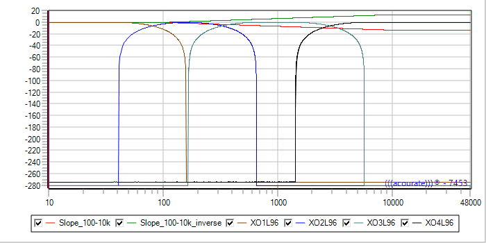

1. Filters setup:

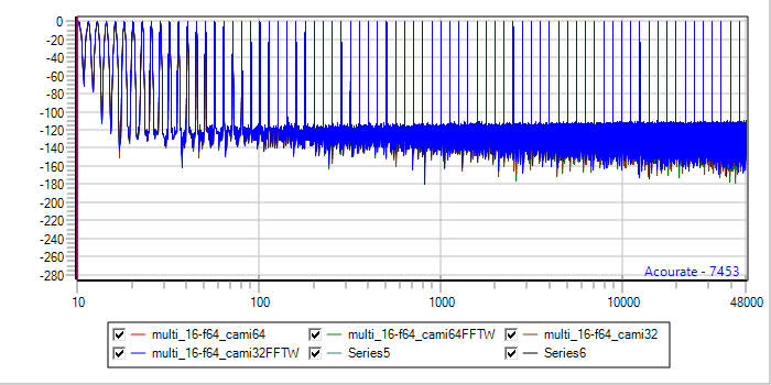

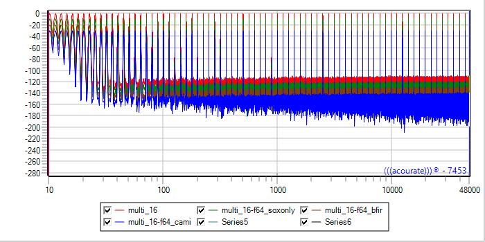

2. 16Bit input file - Comparing input file (red), sox conversion (green, -10dB), brutefir convolution result (brown, -20dB) and camilladsp convoltution result (blue, -30dB)
3. 24Bit input file - Comparing input file (red), sox conversion (green, -10dB), brutefir convolution result (brown, -20dB) and camilladsp convoltution result (blue, -30dB)
4. 32Bit input file - Comparing input file (red), sox conversion (green, -10dB), brutefir convolution result (brown, -20dB) and camilladsp convoltution result (blue, -30dB)
5. Behavior of Camilladsp vs. Brutefir in case of the linear phase filters used in this setup (2*128k, equalling to a delay of 120k). Brutefir will truncate the 128k samples initial delay at the end. Camilladap does not.
Because of this latter improvement over brutefir , my vote goes to Camilladsp, despite of the higher CPU usage. Because I am using linear phase filters within my active loudspeakers projects.

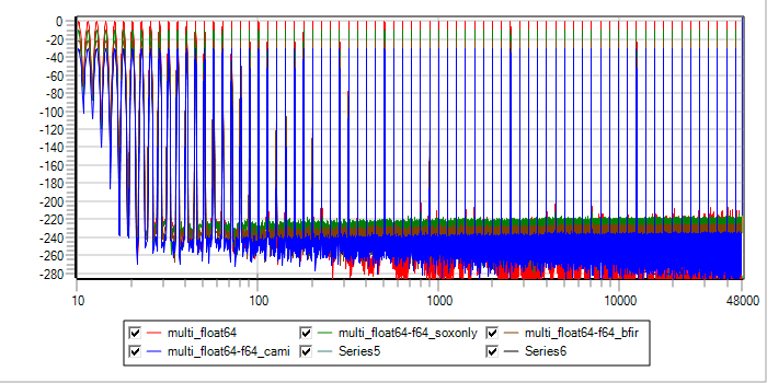

Just a note - sox uses signed int32 internally, therefore any work with larger formats (e.g. float64) reduces precision ...

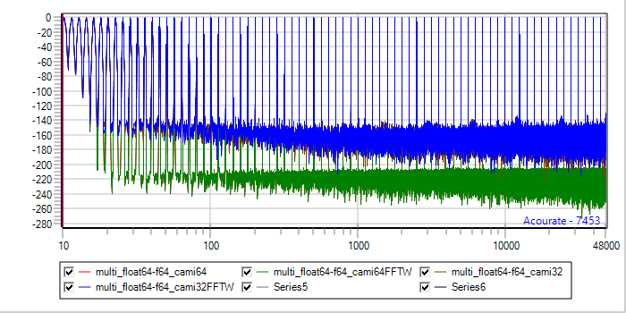

OK. This is it! These are the corresponding graphs with an input from a file formatted as FLOAT64. Note that the multitone does not reach 64Bit precision. But such as it is, sox does set the resolution level at -210dB (sox graph is attenuated by -10dB), which is slightly worse than the input signal.
Does anybody know a bitdepth converter which will gracefully handle conversions to FLOAT64 and back?

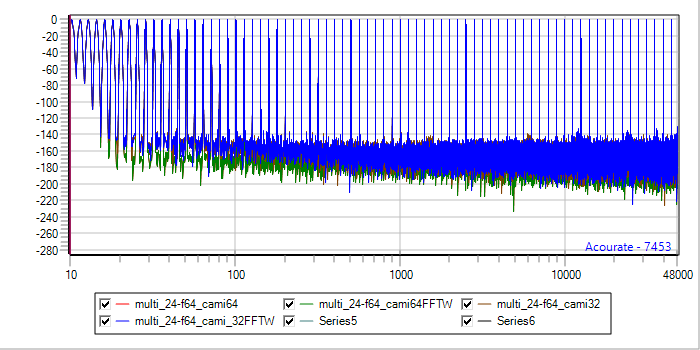

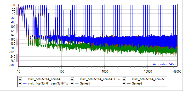

Yet another set of benchmarks. Camilladsp comes in different flavors, 64Bit, 32Bit, RustFFT, FFTW ... So there is a nice playround to compare 64Bit, 64BitFFTW, 32Bit, 32BitFFTW
16BitIn -> sox -> Float64 -> Camilladsp (all 4 datasets the same, blue-4 hiding brown-3 hiding green-2 hiding red-1)
24BitIn -> sox -> Float64 -> Camilladsp (gn-2 hiding red-1, blue-4 hiding brown-3)
32BitIn -> sox -> Float64 -> Camilladsp (gn-2 hiding red-1, blue-4 hiding brown-3)
64BitIn -> sox -> Float64 -> Camilladsp (gn-2 hiding red-1, blue-4 hiding brown-3)

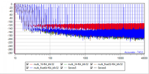

And Brutefir 32Bit as a reference, formatted differently with all 16/24/32/64 inputs on the same graph
No surprizes (still with sox as a bitdepth shifter - was done before phofman made his objection about the problematic float64 conversion by sox).
Actually, you can use CamillaDSP for that 🙂
Just compile it with the default features (meaning without 32bit mode) and run it with file in/out with the formats you want, and an empty pipeline. You could also add some dither if you like.
Oh my ... this calls for another set of benchmarks ...
