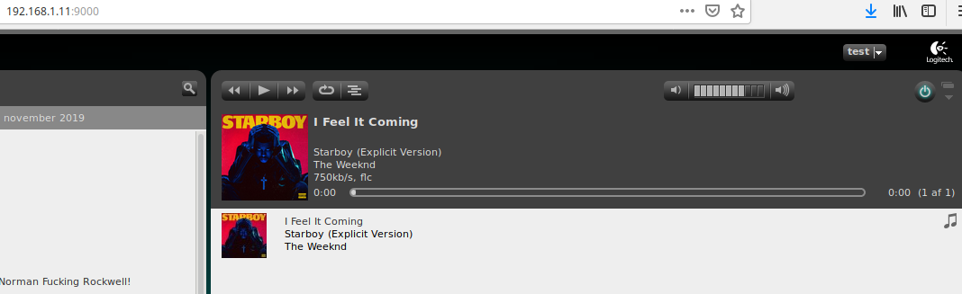

I'am trying to switch filters through python, it is working fine.
But if i take a filter like this one :
And write samplerate: 96000 instead of the "default" 44100 i cannot start the engine.
Is it not possible to shift the samplerate?
Or did i miss something? 🙂🙂

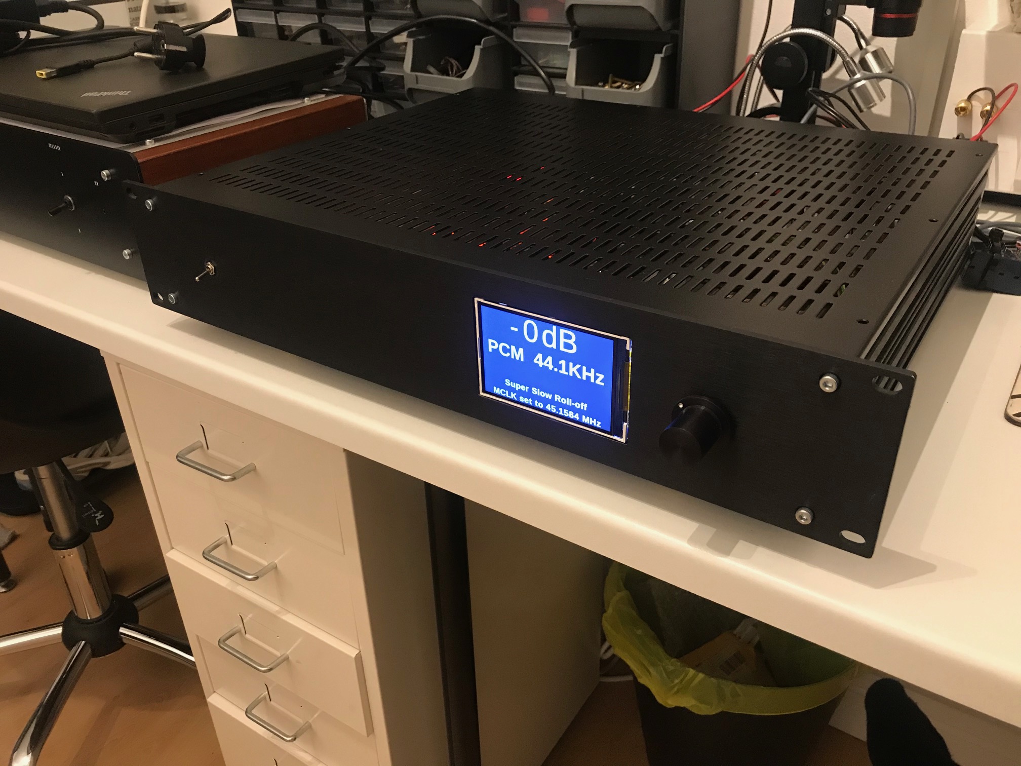

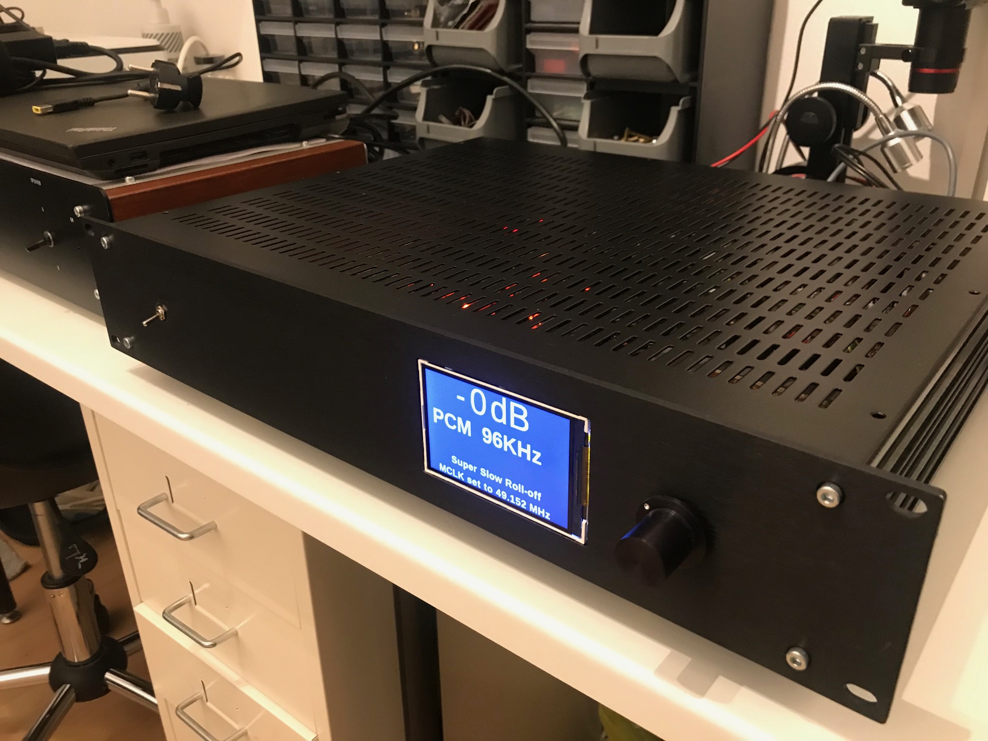

Case is, i have hacked the squeezelite player to paste-out the played samplerate (e.g. 44100, ... 96000, ...192000). It's working fine grabbing this with a pythonscript and send/reload camilladsp filter also works, but only with 44100 for now?
Ugly script for now i know 😱 ::
Jesper.

My hack on squeezelite are cool btw. more to come when i solve this prob.

So i'am been making some progress now regarding the fault clearance in my setup.
If i do this without squeezelite started i can change the samplerate at camilla without problems:
And changing to 96000:
So camilladsp is working as expected 🙂
Also the samplerate is detected at my DAC... so that's good.
If i change samplerate when squeezelite is started, i got errors allmost every time; i also had wild kernel panic and crashes doing this so it's nogo for now i think:
So it seems that squeezelite is locking the samplerate somehow (my guess!)
Right now i donno howto solve this, need to go thinking.
- One solution is to script squeezelite to stop when filter is changed, but it's bad while LMS needs to see the player attached, could give a lot of problems iguess.
- Attached picture of LMS when player is "attached"
Jesper.
pi@SuperBPI:~/Cfilters $ camilladsp -v -p3011 rate_44100.yml
[2020-03-26T06:07:30Z DEBUG camilladsp::biquad] a1=-1.985802922748258 a2=0.9858533119988809 b0=0.9929140586867847 b1=-1.9858281173735695 b2=0.9929140586867847
[2020-03-26T06:07:30Z DEBUG camilladsp::socketserver] Start websocket server on port 3011
[2020-03-26T06:07:30Z DEBUG camilladsp::filters] Build new pipeline
[2020-03-26T06:07:30Z DEBUG camilladsp::filters] Build from config
[2020-03-26T06:07:30Z DEBUG camilladsp:😛rocessing] build filters, waiting to start processing loop
[2020-03-26T06:07:30Z INFO ws] Listening for new connections on 127.0.0.1:3011.
[2020-03-26T06:07:30Z DEBUG camilladsp::alsadevice] Opened audio output "camilla_in" with parameters: HwParams { channels: Ok(2), rate: "Ok(44100) Hz", format: Ok(S32LE), access: Ok(RWInterleaved), period_size: "Ok(1024) frames", buffer_size: "Ok(16384) frames" }, SwParams(avail_min: Ok(1024) frames, start_threshold: Ok(7168) frames, stop_threshold: Ok(16384) frames)
pi@SuperBPI:~/Cfilters $ camilladsp -v -p3011 rate_96000.yml
[2020-03-26T06:07:20Z DEBUG camilladsp::biquad] a1=-1.9934657011950088 a2=0.9934763754602268 b0=0.996735519163809 b1=-1.993471038327618 b2=0.996735519163809
[2020-03-26T06:07:20Z DEBUG camilladsp::socketserver] Start websocket server on port 3011
[2020-03-26T06:07:20Z DEBUG camilladsp::filters] Build new pipeline
[2020-03-26T06:07:20Z DEBUG camilladsp::filters] Build from config
[2020-03-26T06:07:20Z INFO ws] Listening for new connections on 127.0.0.1:3011.
[2020-03-26T06:07:20Z DEBUG camilladsp:😛rocessing] build filters, waiting to start processing loop
[2020-03-26T06:07:20Z DEBUG camilladsp::alsadevice] Opened audio output "camilla_in" with parameters: HwParams { channels: Ok(2), rate: "Ok(96000) Hz", format: Ok(S32LE), access: Ok(RWInterleaved), period_size: "Ok(1024) frames", buffer_size: "Ok(16384) frames" }, SwParams(avail_min: Ok(1024) frames, start_threshold: Ok(7168) frames, stop_threshold: Ok(16384) frames)
2020-03-26T06:15:16Z INFO ws] Listening for new connections on 127.0.0.1:3011.
[2020-03-26T06:15:16Z ERROR camilladsp] Capture error: ALSA function 'snd_pcm_hw_params_set_rate' failed with error 'EINVAL: Invalid argument'
[2020-03-26T06:15:16Z DEBUG camilladsp] Exiting
Jesper.
