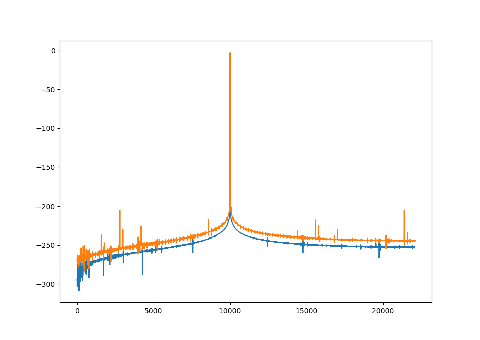

So I have started looking into this. The plan is to add an (optional!) asynchronous sample rate converter in the capture process. This would then be controlled via the same mechanism that is used to set the speed of a loopback device. The use case is for phofmans case A, when the source and sink are using different clock sources.Many people (including me) keep hitting the problem of multiple master clocks in the chain. There are two cases:
A) All master clocks are fixed, uncontrollable by the chain.
Example: Two separate soundcards (clocked by crystal or SPDIF input).
Case A) requires some form of adaptive resampling, no other option possible.
I have written an ugly and slow test in Python, but even in this state it works pretty well. Resampling a 10kHz sine from 44100Hz to 44200Hz gives the spectrum in the attached file. The y-axis is in dB, blue is before and orange is after resampling.
The whole thing is based on this paper: https://www.analog.com/media/en/tec...-articles/5148255032673409856AES2005_ASRC.pdf
Henrik, fantastic results, the resampling artefacts are deep below any real-world noise.
I wonder if there was a chance to have this as a standalone binary.... but there would be the problem with output, how to chain with the next part. Just your source code will be a very important help for implementing the algorithm in other projects.
Is this running at 64 bit float? I guess it has to be because otherwise artefacts would be way higher. Don't get me wrong, still impressive. And I still have to be convinced that resampling with a high quality resampler at 32 bit float even has audible artifacts.
Just my 2 cts
Just my 2 cts
Thanks! I still haven't written any rust code for this. Once I start the plan is to make the resampler a separate library. For CamillaDSP the resampling must be embedded, but I'll need to make some standalone application for testing the library anyway. I could spend a little more time and make it usable for more than testing.Henrik, fantastic results, the resampling artefacts are deep below any real-world noise.
Yes it's 64-bit, simply Python default floats. With 32-bit the noise floor would be somewhere around -140dB. The graph I posted doesn't reach the 64-bit noise floor because of how I windowed the signal before fft. Once it's in rust, playing with 32-bit floats becomes easy.Is this running at 64 bit float? I guess it has to be because otherwise artefacts would be way higher. Don't get me wrong, still impressive. And I still have to be convinced that resampling with a high quality resampler at 32 bit float even has audible artifacts.
